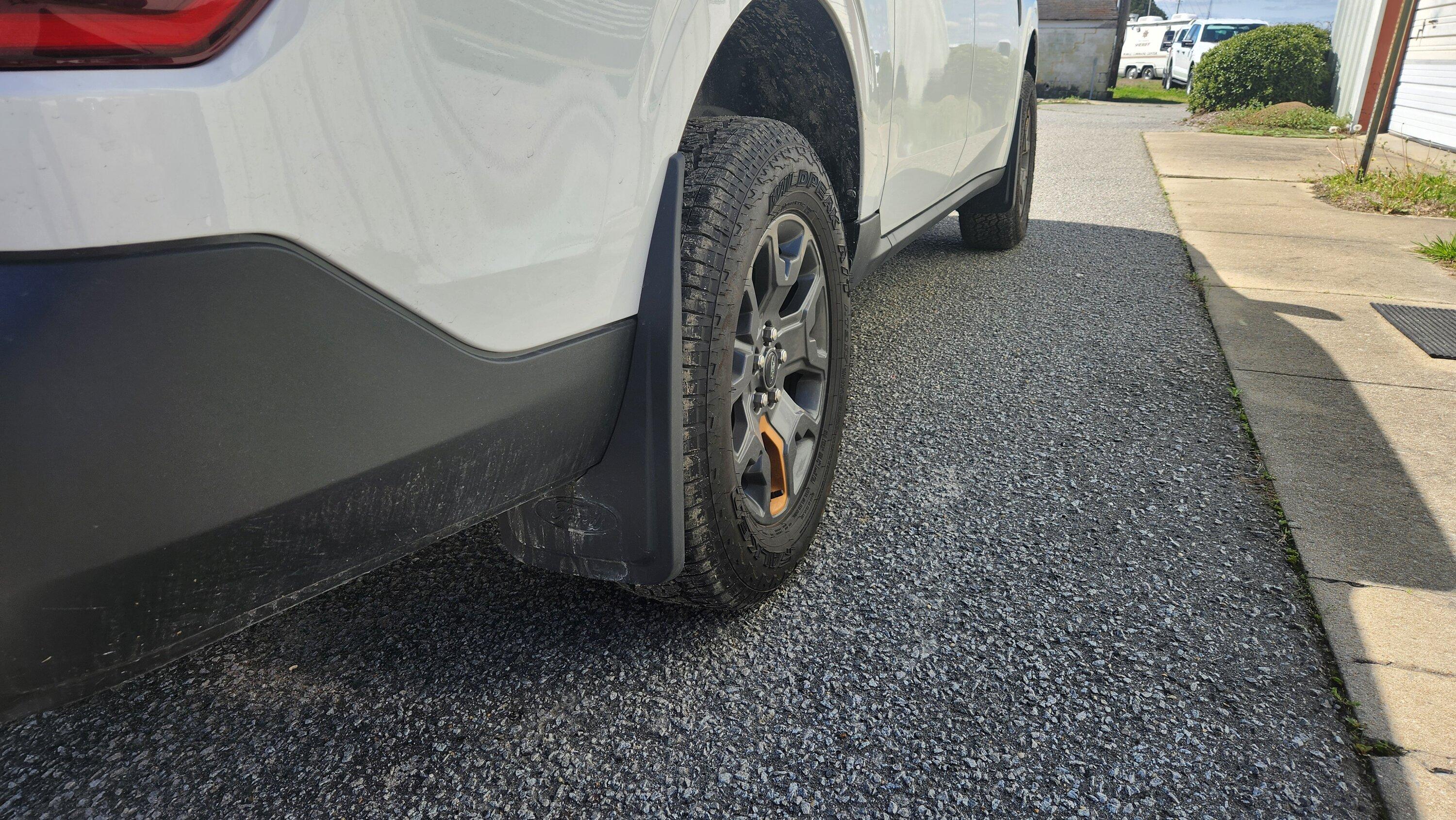

Got the Mabett mud flaps. Don't cost a lot and they keep most of the crap off my camper.

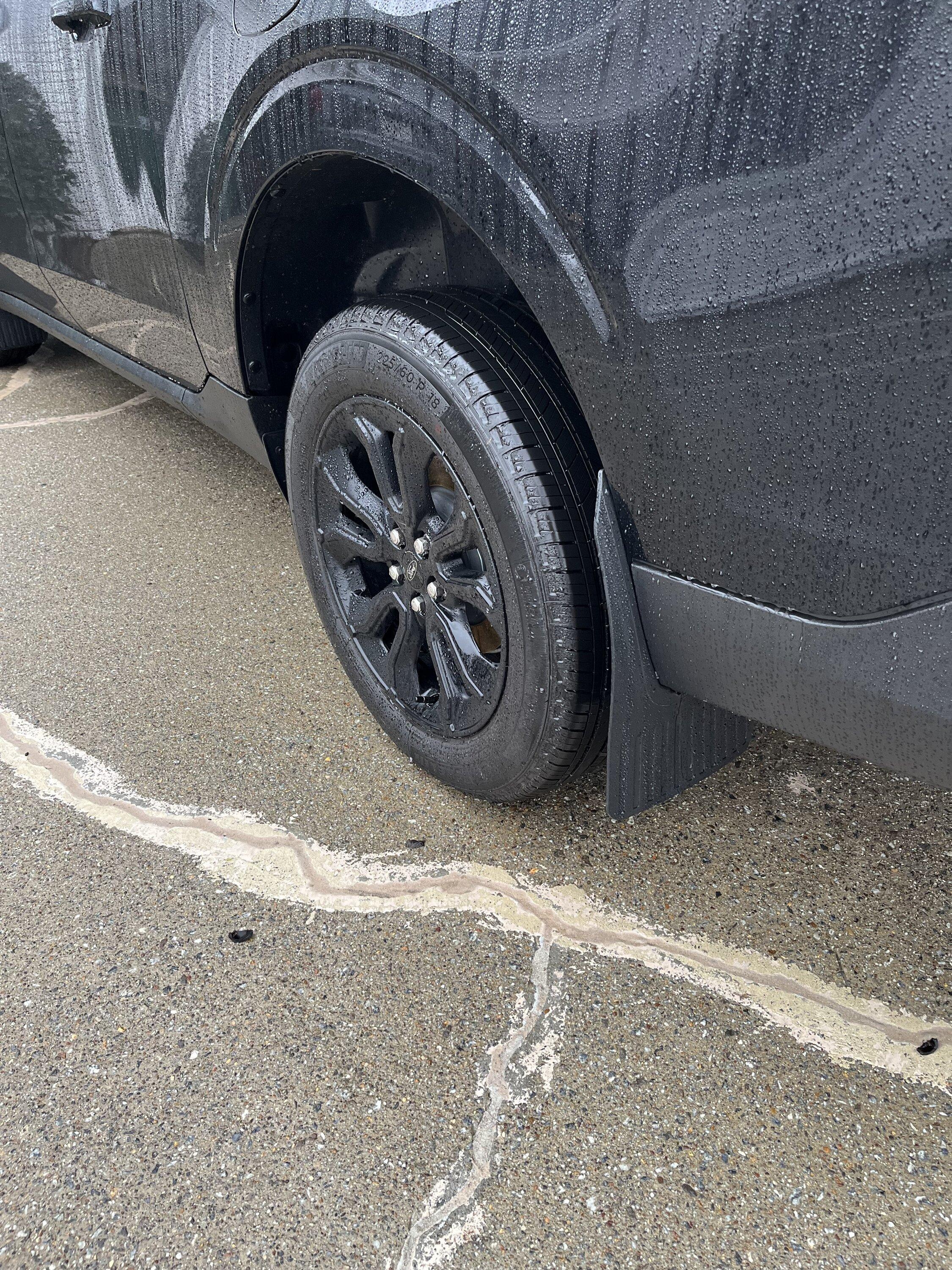

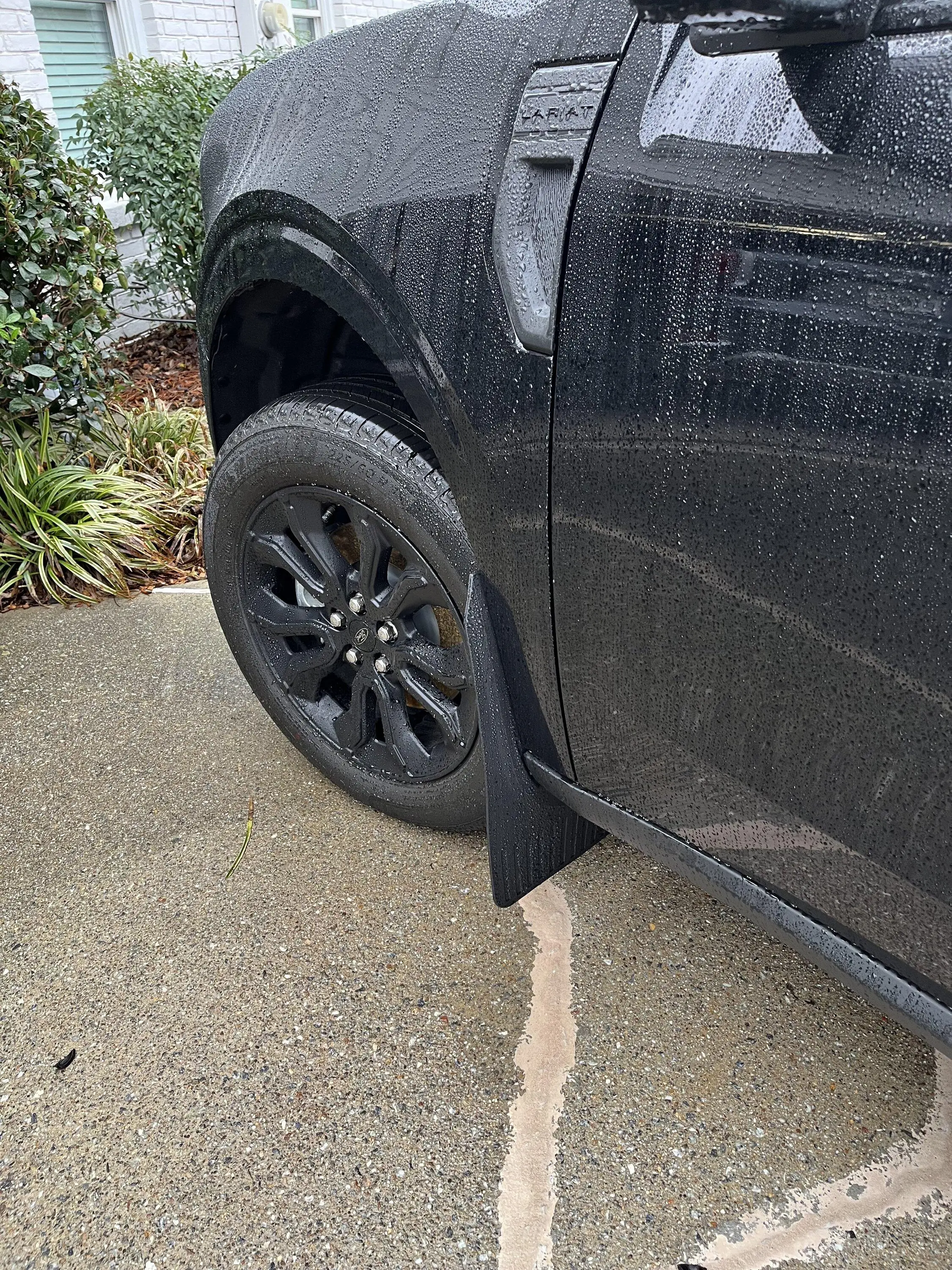

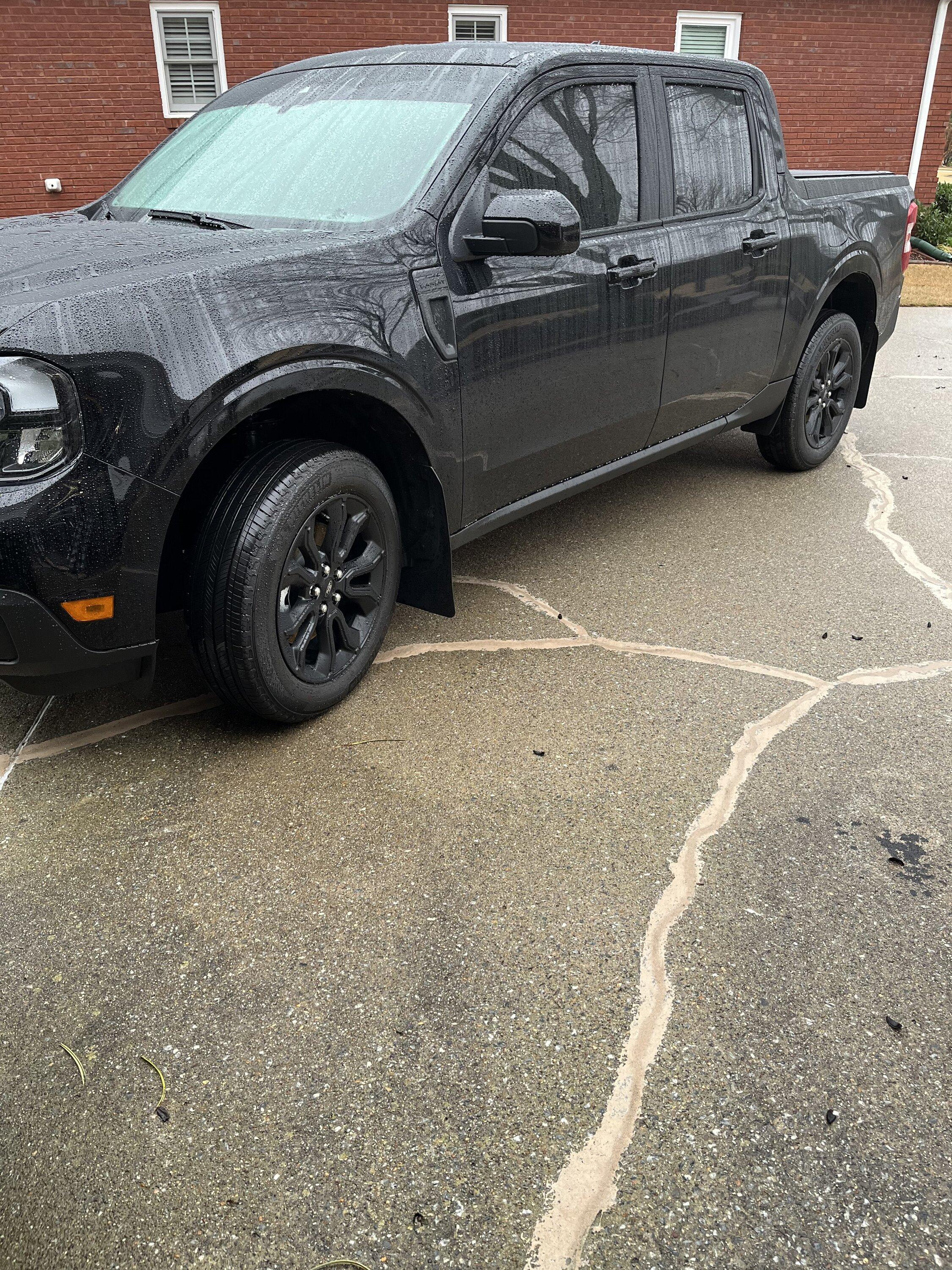

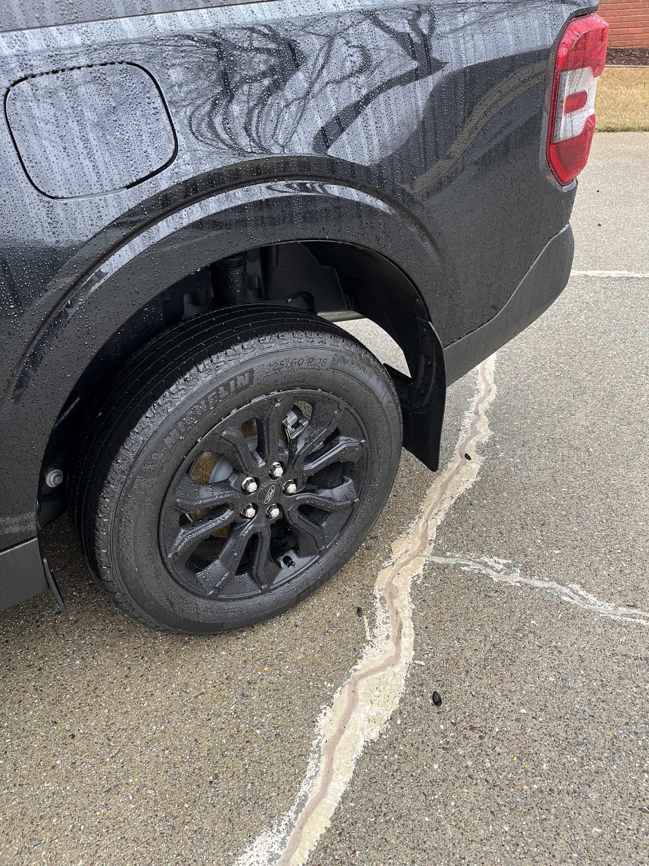

My guess is most Mav owners are not aware of the void behind the left rear tire that is open all the way to the left taillight. While replacing the stock bulbs to LEDs I noticed the void when I removed the taillights. I noticed road grime was running down the left side rear fender panel and wondered why. It became all clear when I removed the taillight, you can literally see all the way to the ground and tire once the taillight is removed. Not good since all that water and crud accumulates all inside the void and all over the wiring for the taillight. I used flashing to construct a cover that attaches to the underside of the void behind the tire. It is screwed in and glued so it is a great improvement preventing water etc from getting into the void. Next I installed Mabett mud flaps. They are flexible and not ridgid like the plastic type. Plus they are easy to clean. BTW i painted the panel I made black, you would not notice it if you didn't know it was hand made

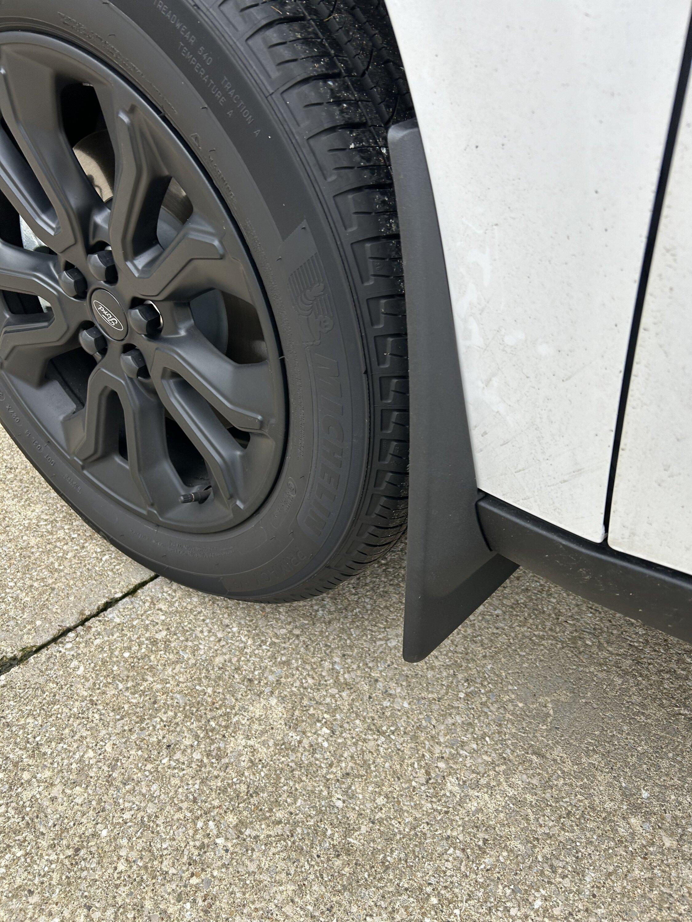

I have the Weatherteck on mine.
Sitting on the fence,I have alway had them on previous trucks Just wondering with the Tremor if they are too low to the ground?

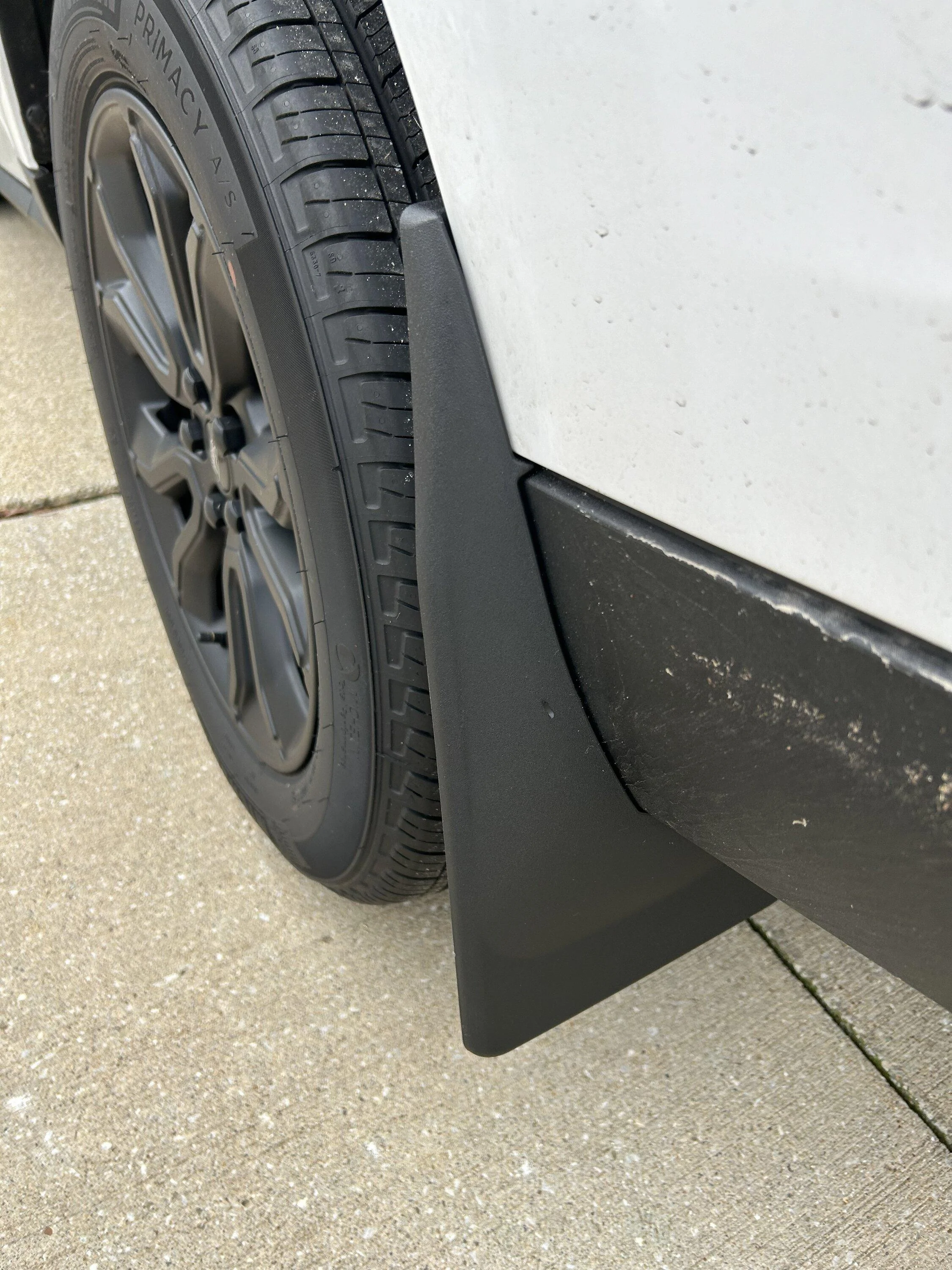

I have the WeatherTeck on mine. Have used them on multiple cars. Great quality and easy install.

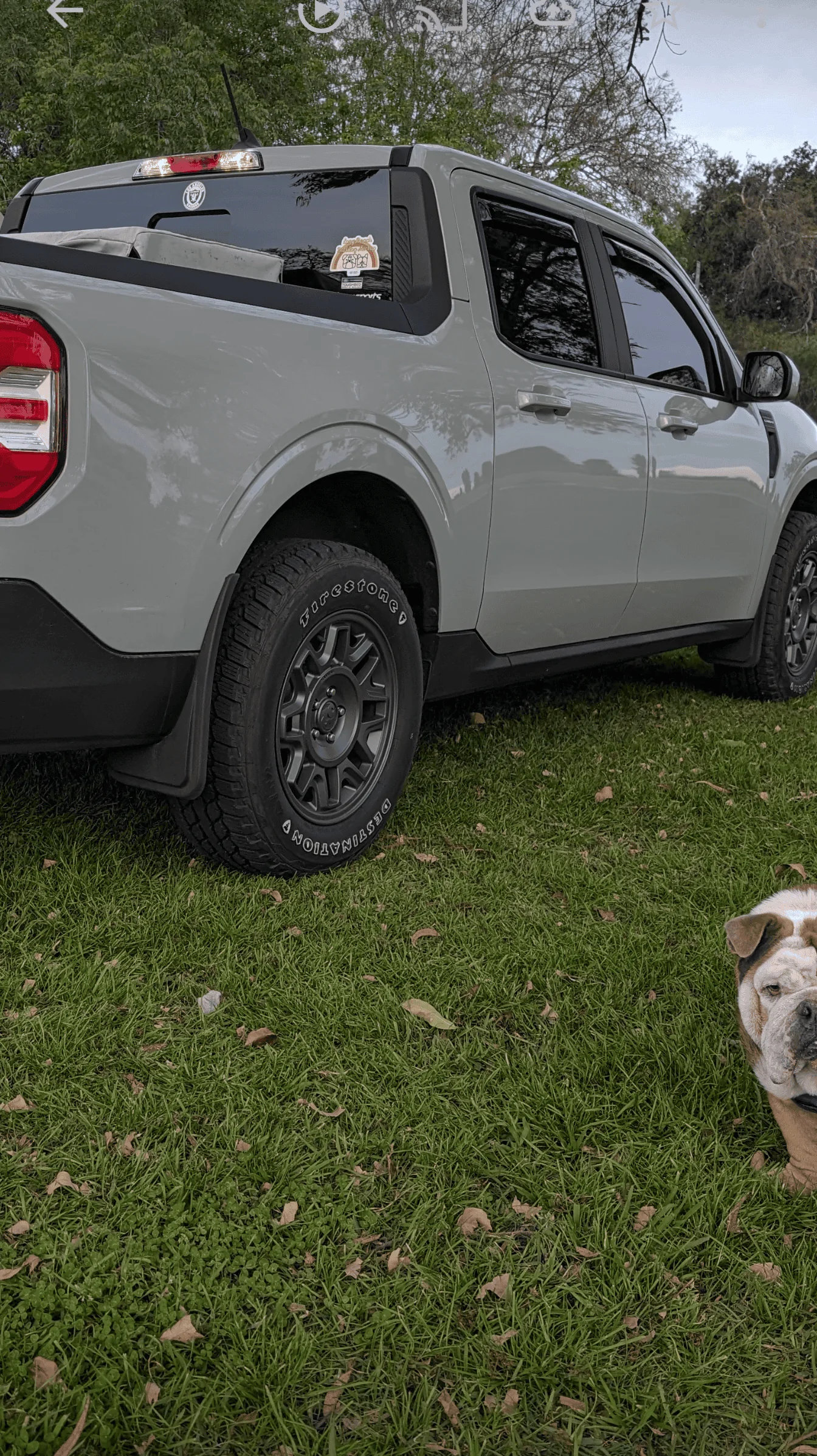

I went with the tried and true Muslogy decor flaps.
The OEM Ford flaps looked too big and square to my eyes.
The good thing is you now have a decent amount of flaps to choose from.

They look really good just like your dog
