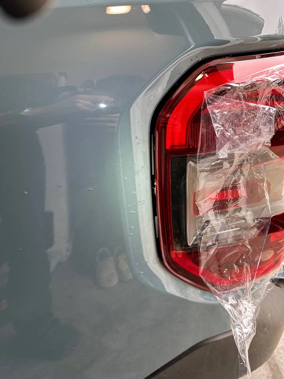

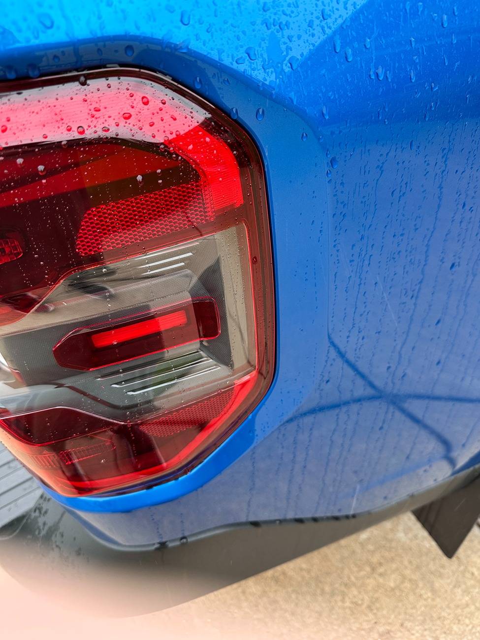

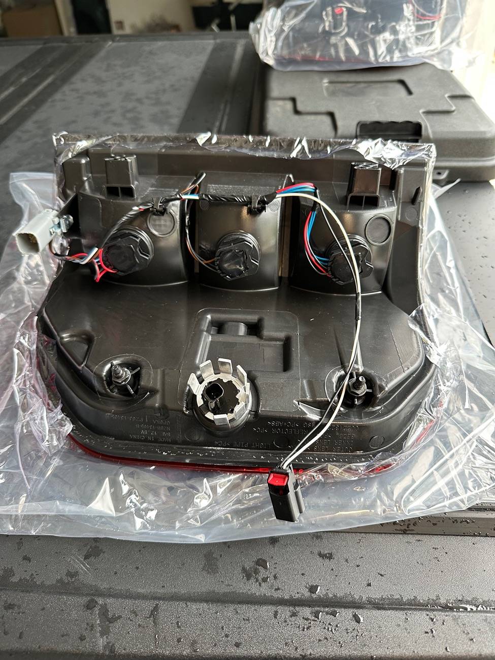

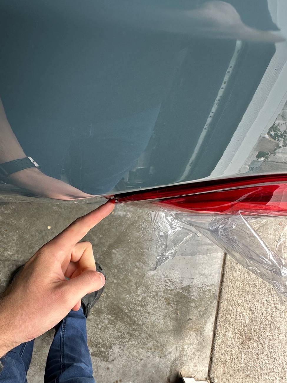

I bought the same ones and it did the same thing, however you just needed to push in a little firmer and you would hear the click and see that it seats well. A nice upgrade for $350. You will also need to purchase some 7443 LED Bulbs to fit these assemblies if you want the Brake and Reverse Lights LED since these come with supplied halogens (except the strip and side marker which are standard LED's).
