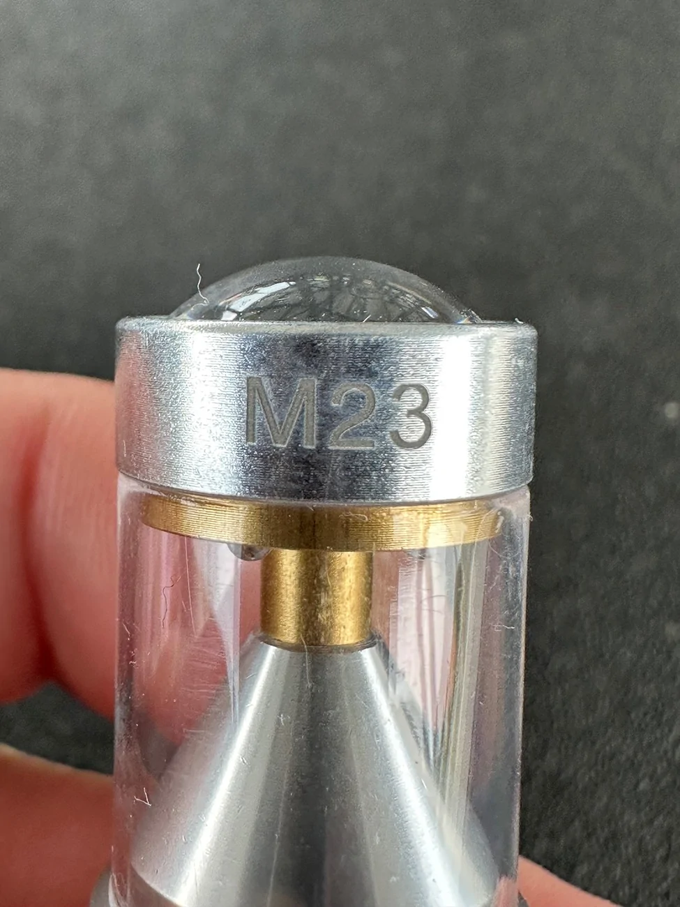

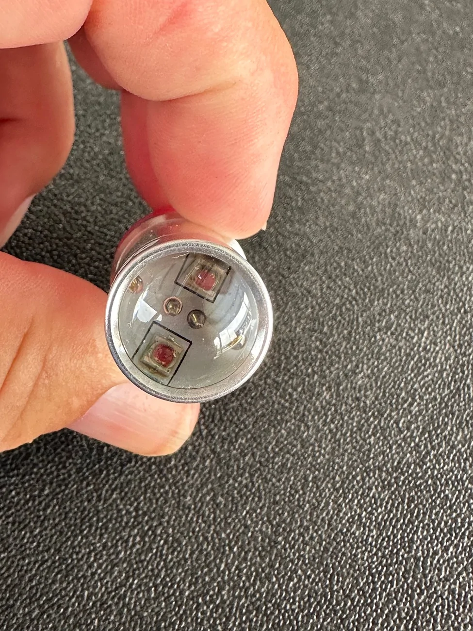

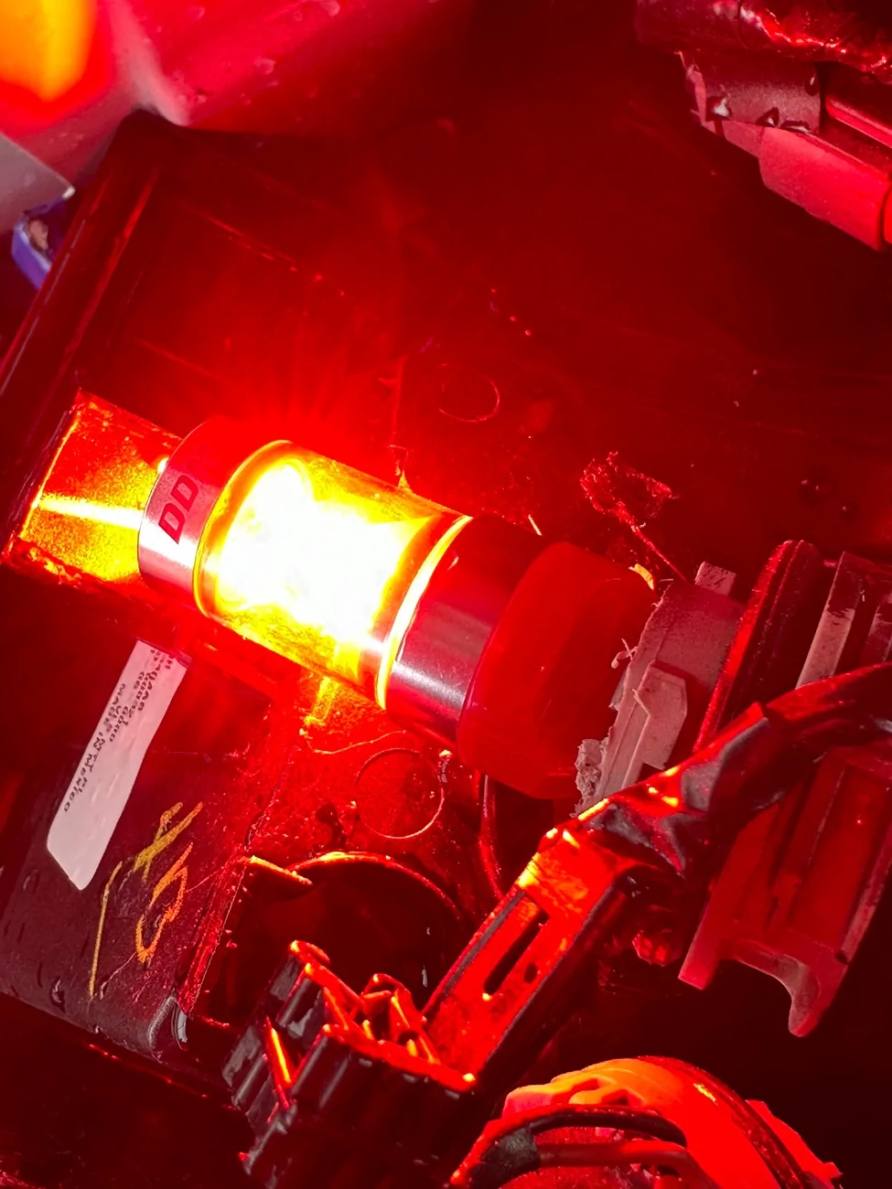

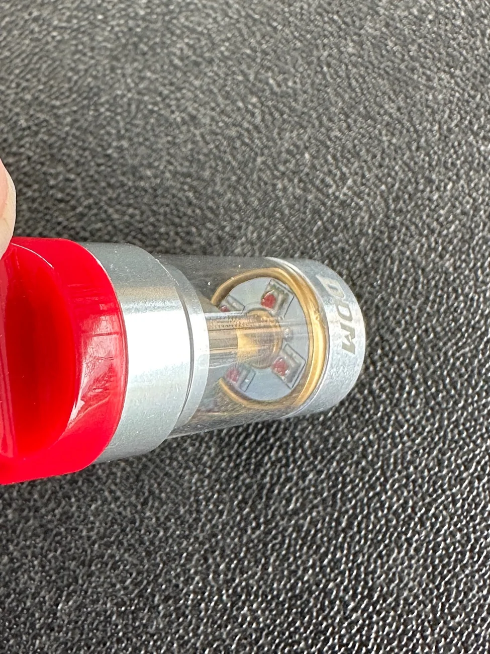

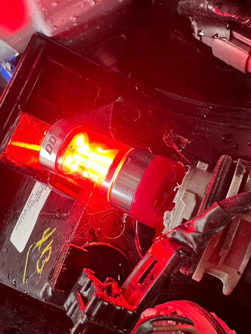

I’ve been using these DDM TUNING LEDS. Not sure of the hyper flash as I got in forrscan and shut off the outage when I was using the LASQUIT bulbs. They all died. I’ve got other hi power FENIEX CANNONS tied into the lamps so I’ve reached the close to over load point of the BCM. Here is a link to the DDM. They use CREE LED , so they are bright
