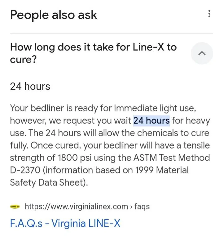

I would call your dealership.
Get the name of the shop.
Call the shop and get their recommendations.
I would add.
You may want to ask for a care and maintenance guide for your new spray-in bedliner.
The following is for Line-x
yours maybe different. It will give you a good general idea.
Good luck
The answer below provided by a Line-X Dealer
