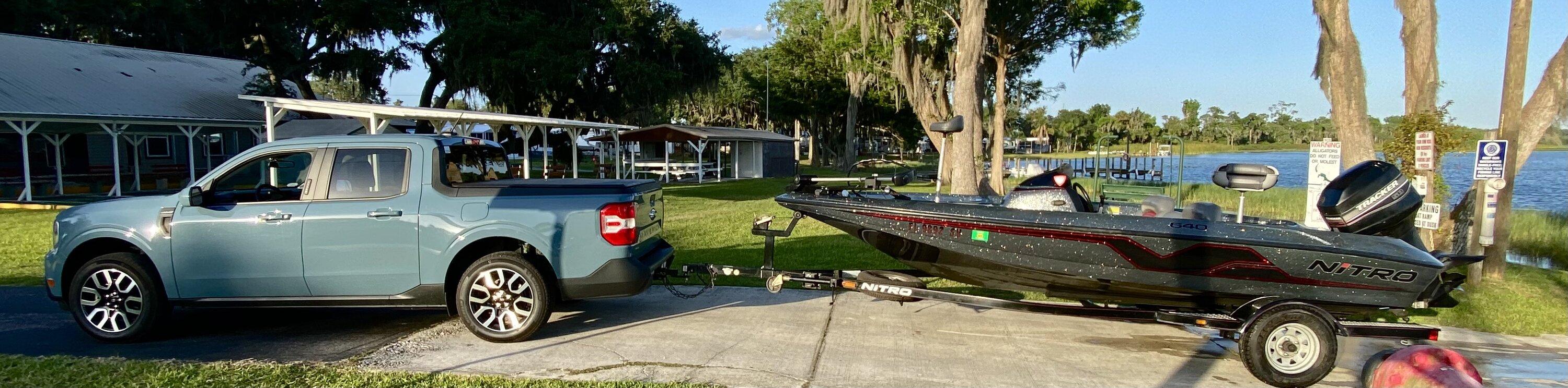

You should not have any problem. I would avoid steep gravel ramps but other than that the Maverick Hybrid will handle with ease. Our Bass boat weights 1600 lbs and it handled it easily!
Ford Maverick Pulling boat trailer with hybrid? IMG_5515
