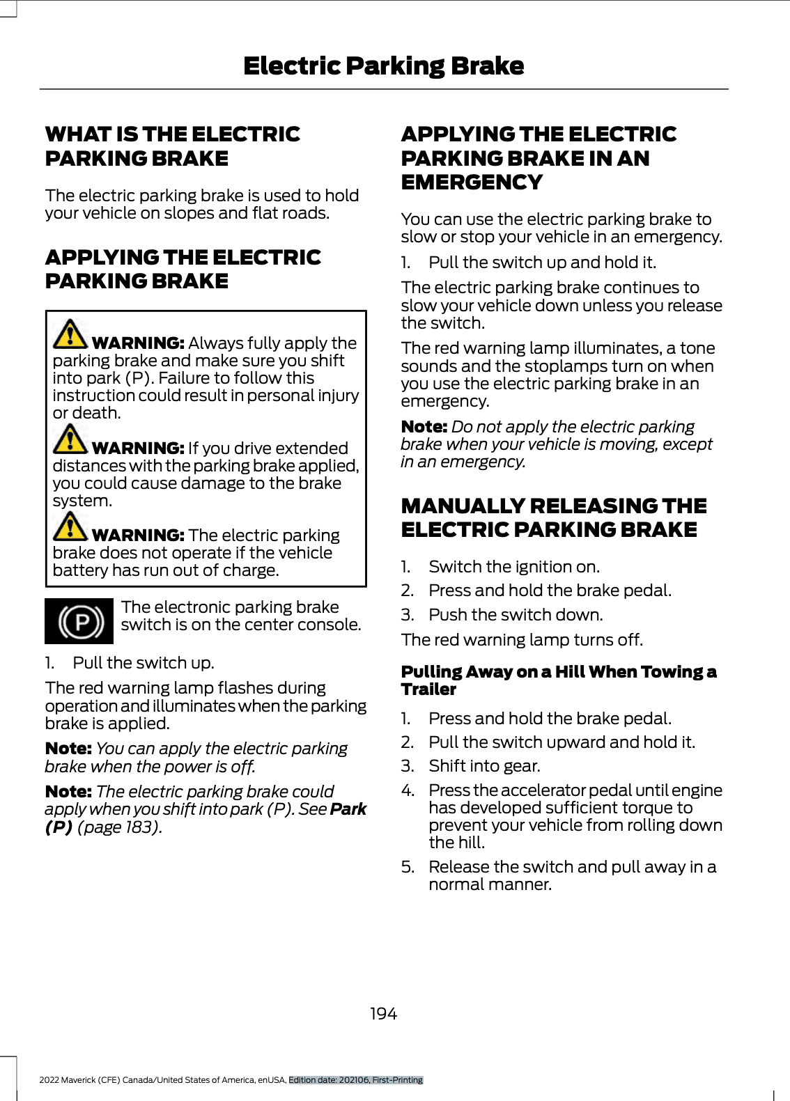

But, it's an interesting question: Is it even possible to actuate an electronically controlled parking brake while the vehicle is in motion?
Does nobody read their manual?
Electric Parking Brake - Applying the Electric Parking Brake in an Emergency
APPLYING THE ELECTRIC PARKING BRAKE IN AN EMERGENCY
You can use the electric parking brake to slow or stop your vehicle in an emergency.
Pull the switch up and hold it.
The red warning lamp illuminates, a tone sounds and the stoplamps turn on when you use the electric parking brake in an emergency.
The electric parking brake continues to slow your vehicle down unless you release the switch.
Note: Do not apply the electric parking brake when your vehicle is moving, except in an emergency. If you repeatedly use the electric parking brake to slow or stop your vehicle, you could cause damage to the brake system.

Hmm, I don't think that was in my very early version. 🥹
jsus
Dec 20, 2021
2,877
3,868
2022 Ford Escape Hybrid AWD
Oh? See the highlight at the bottom then double check yours...
