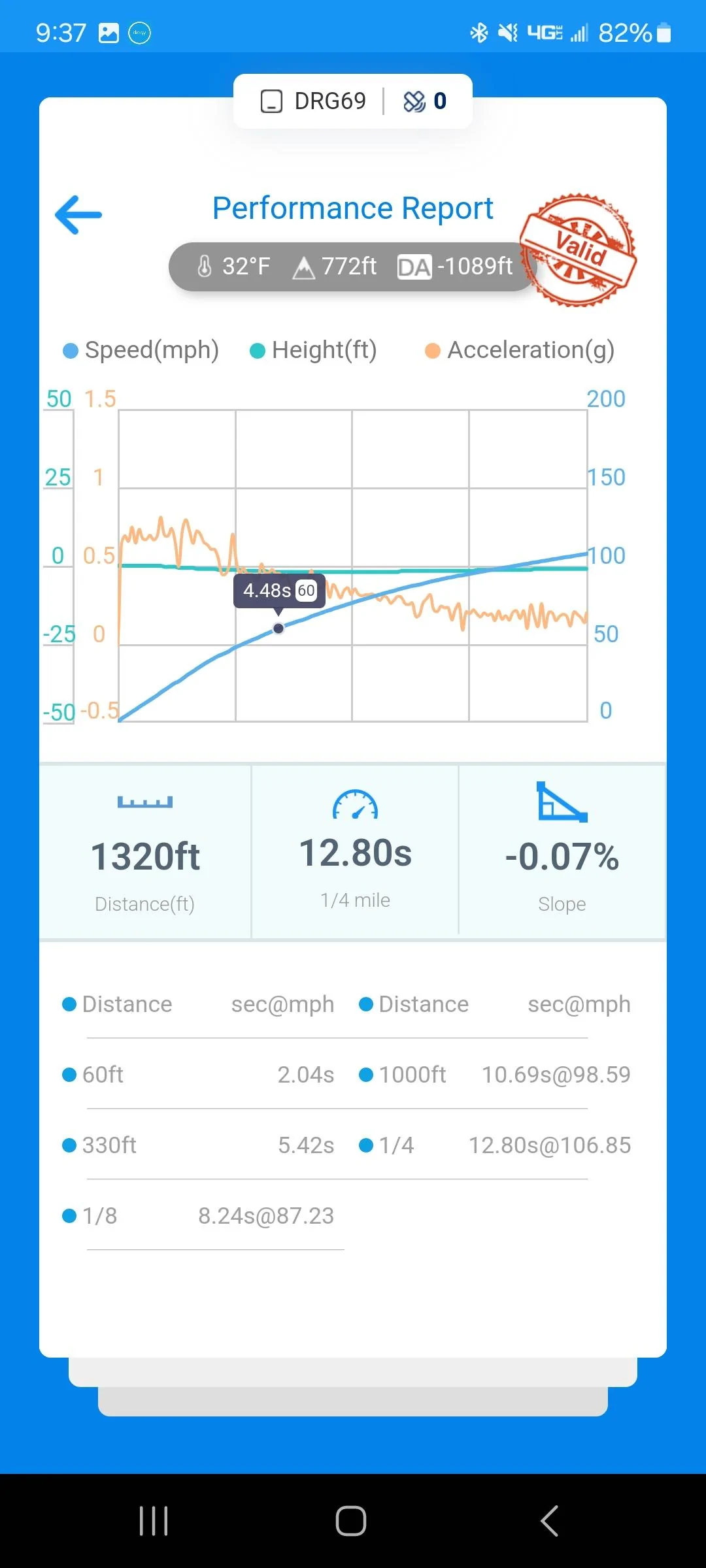

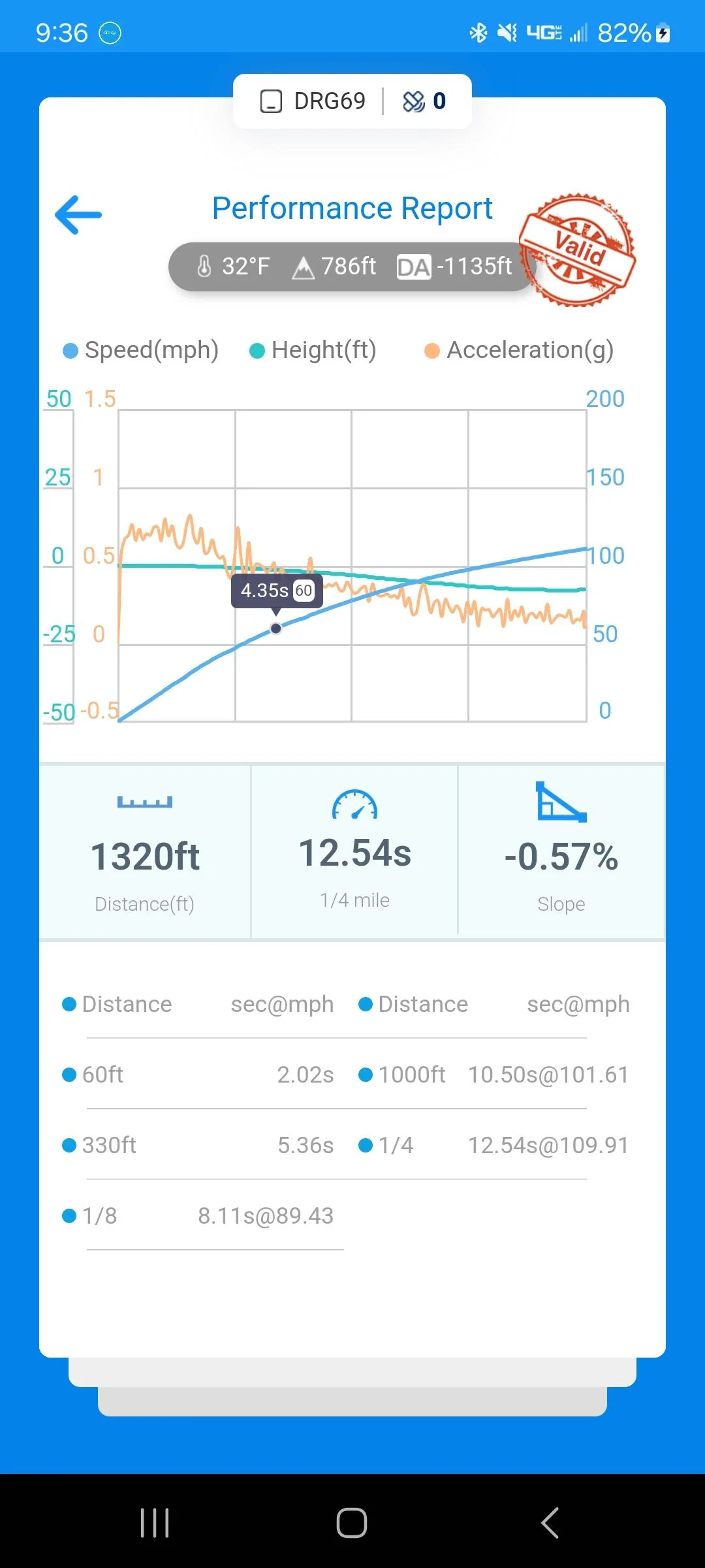

I was pretty impressed with how my 91 octane tune was feeling, and I needed to swap back to my summer tires, so I did another comparo between the snow tire/steelie combo, and the Bronco Sport/ProContact combo. 12.80 vs 12.54. Not too shabby to be running 12.50s on my 91 octane tune! I'm switching back to my summer setup because I'm trying to go to the track on new years, if they don't cancel!

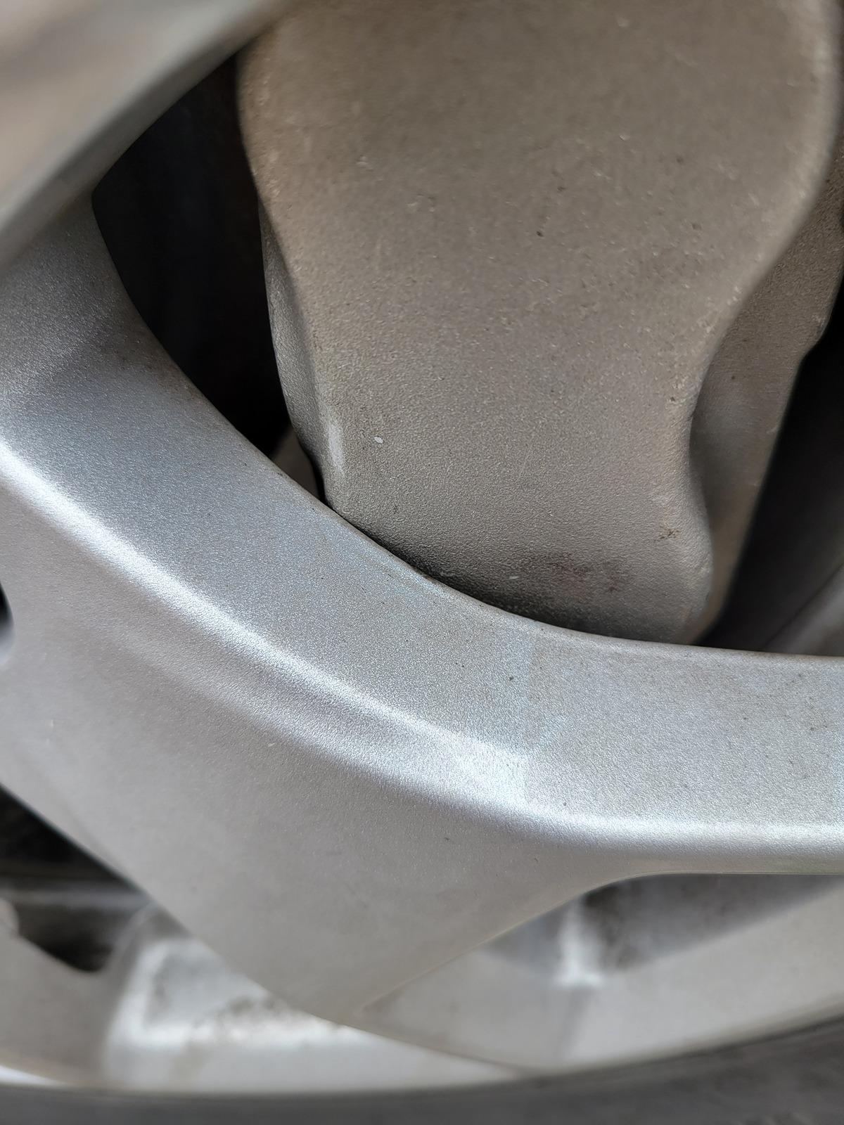

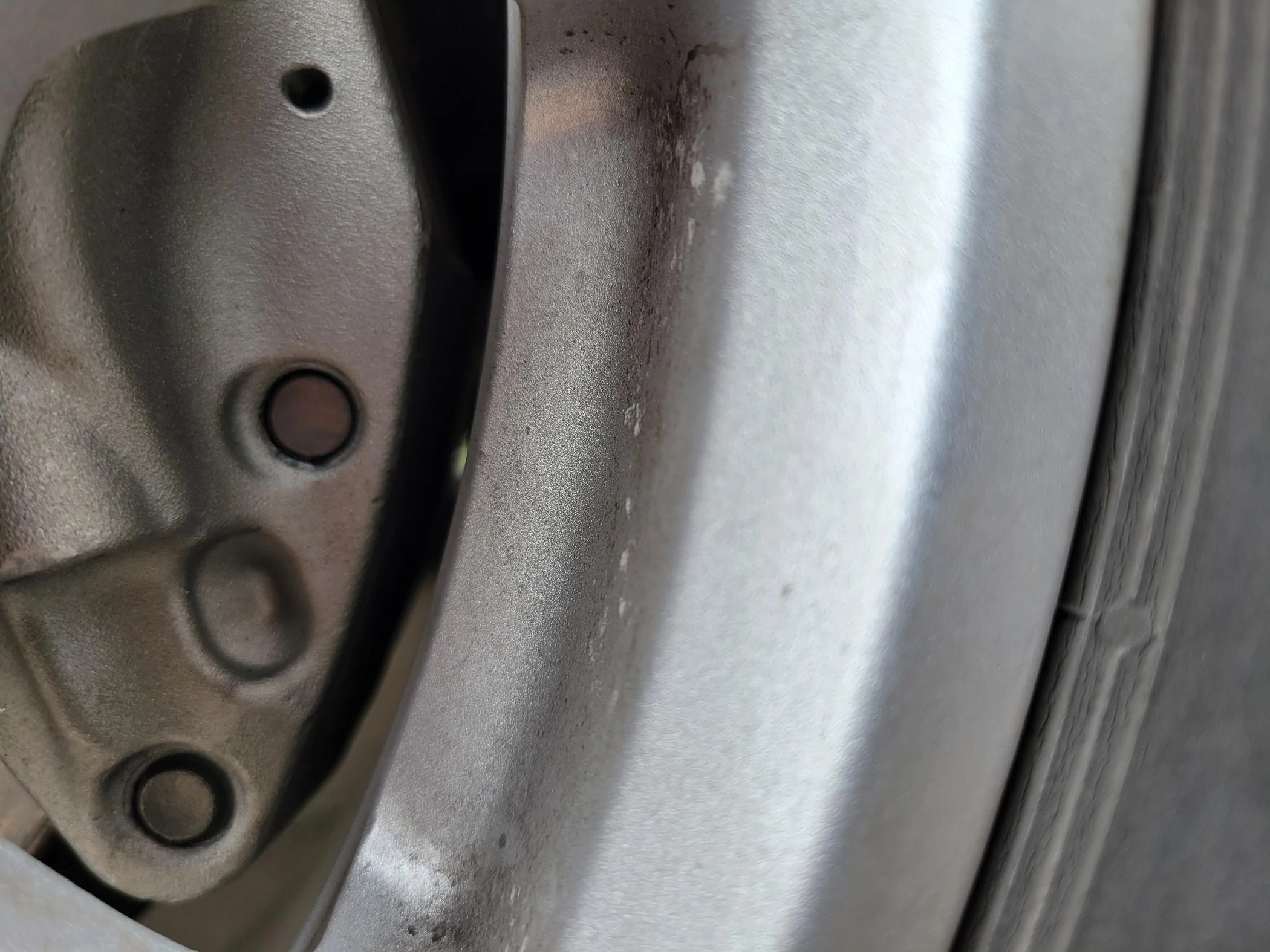

Hey guys, I'm back with more cheap shenanigans! Someone online, named Eric Bernard, found out the volvo s60r/v70r front 4 piston calipers bolt right onto our Mav's! I ordered a set, and have some work to do on them, but they do in fact bolt up! As they sit, they just BARELY touch my Bronco Sport wheels. The wheel still free spins, but slightly contacts the caliper.
However, the caliper itself is not perfectly centered on the rotor, so the mounting surfaces on the caliper will need to be milled down slightly. I didn't have a lit of time, so I couldn't see it all set up with the pads in place to see where it will contact the rotor face, but it should be pretty spot on. More to come when I get them milled and fully installed! I'll post pics and some pricing here shortly!

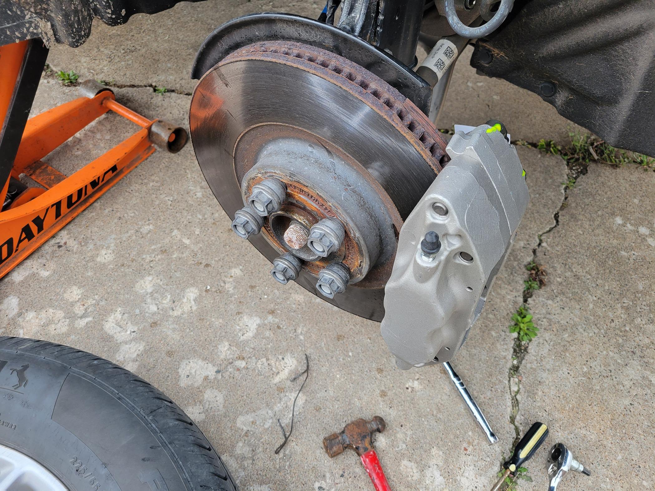

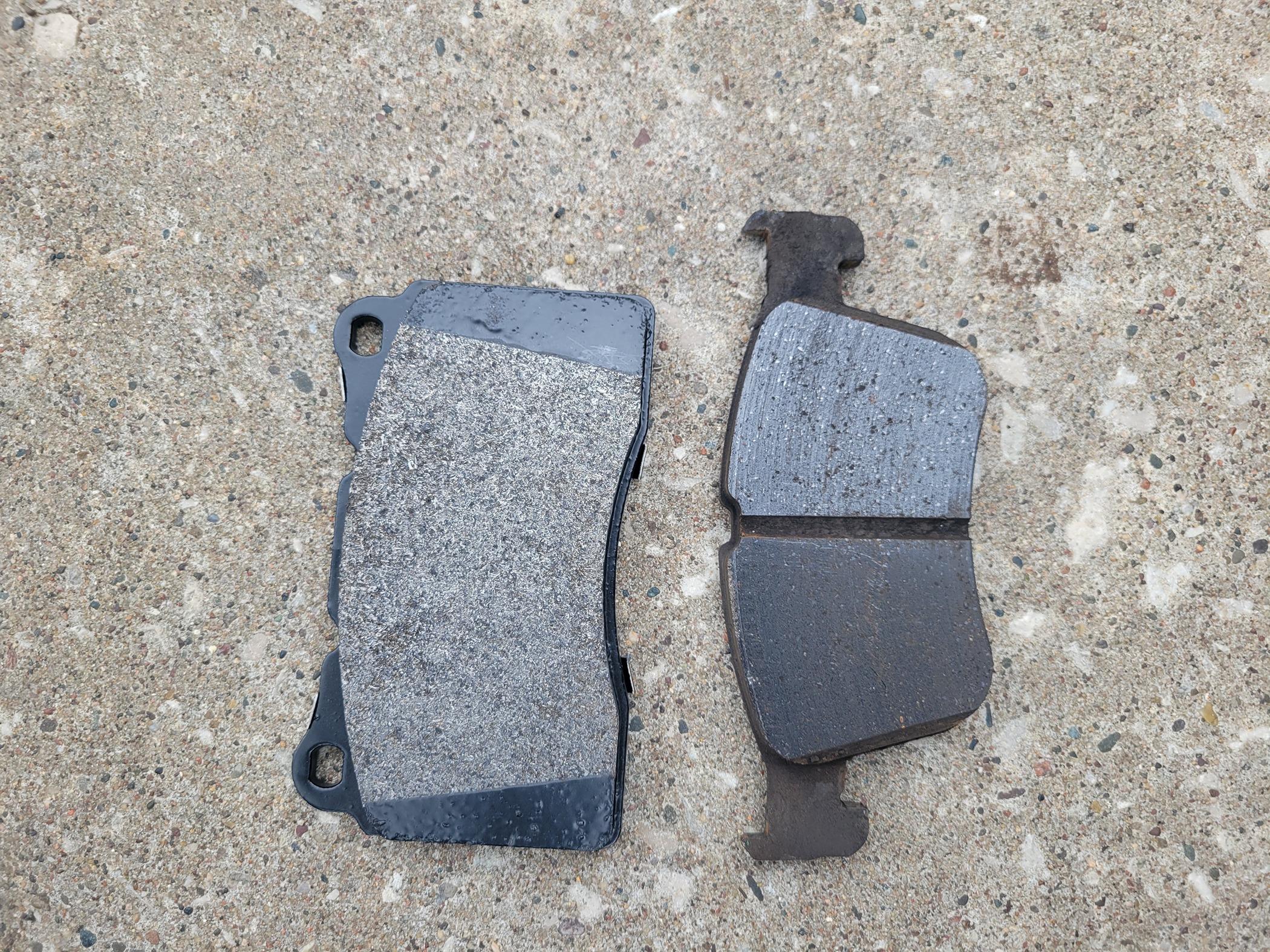

So, pricing on these was just under $400 shipped from rock auto. I will post a more definitive post when I can get then done and mounted. It looks like even the factory line will work, unless the threads are different for some reason. That I am unsure of.
I bought pads, hardware kit, and calipers for a 2007 Volvo S60R.

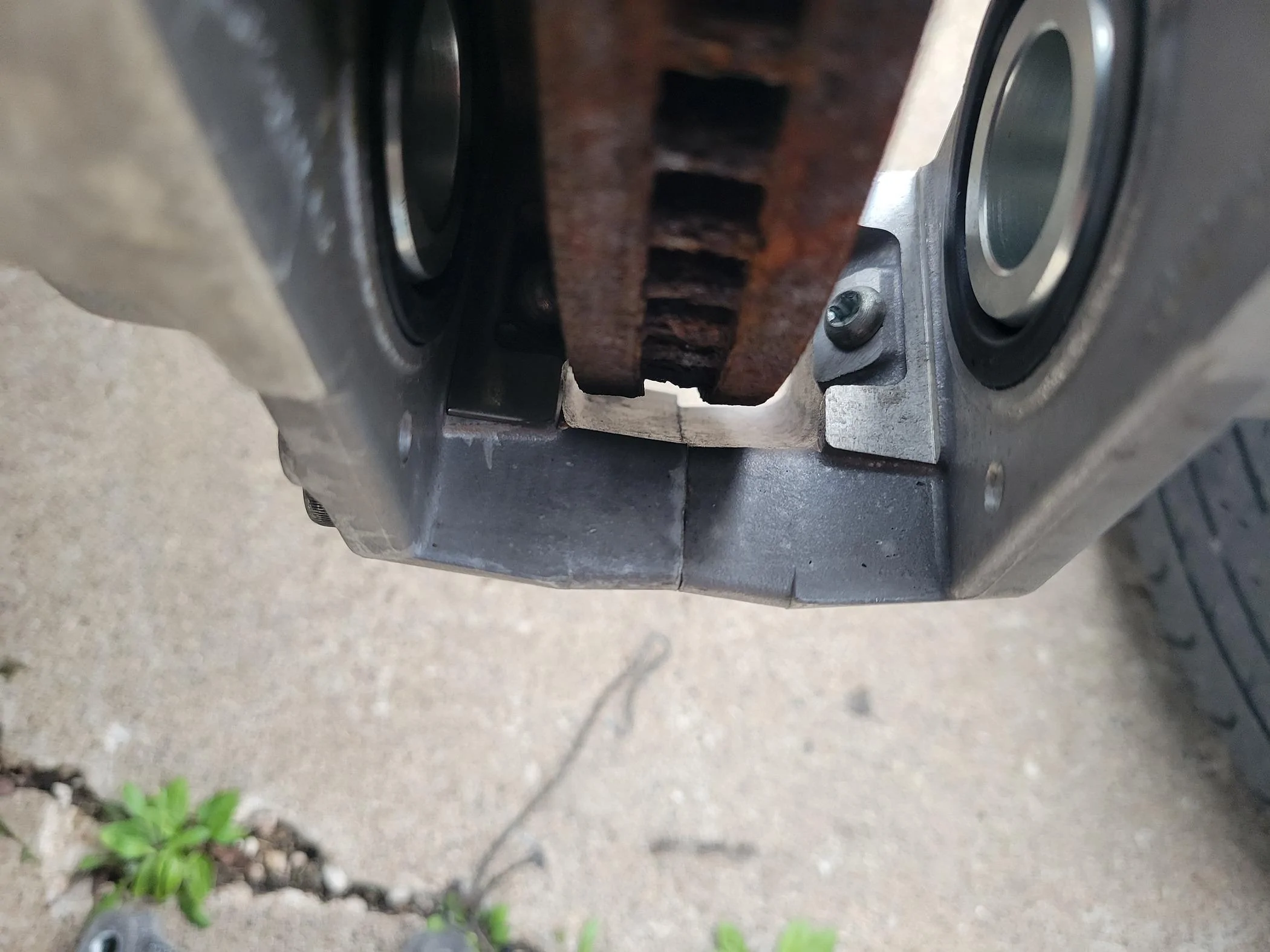

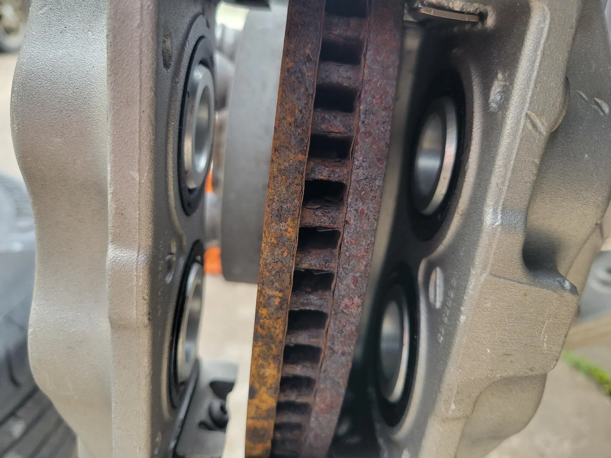

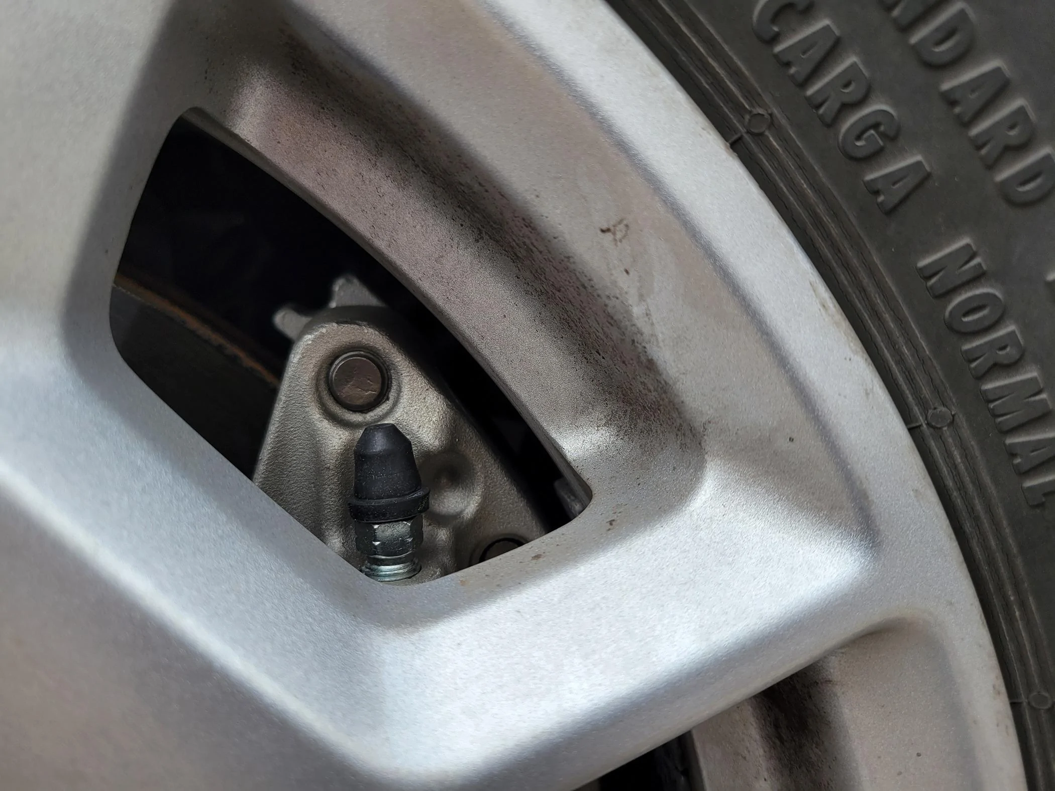

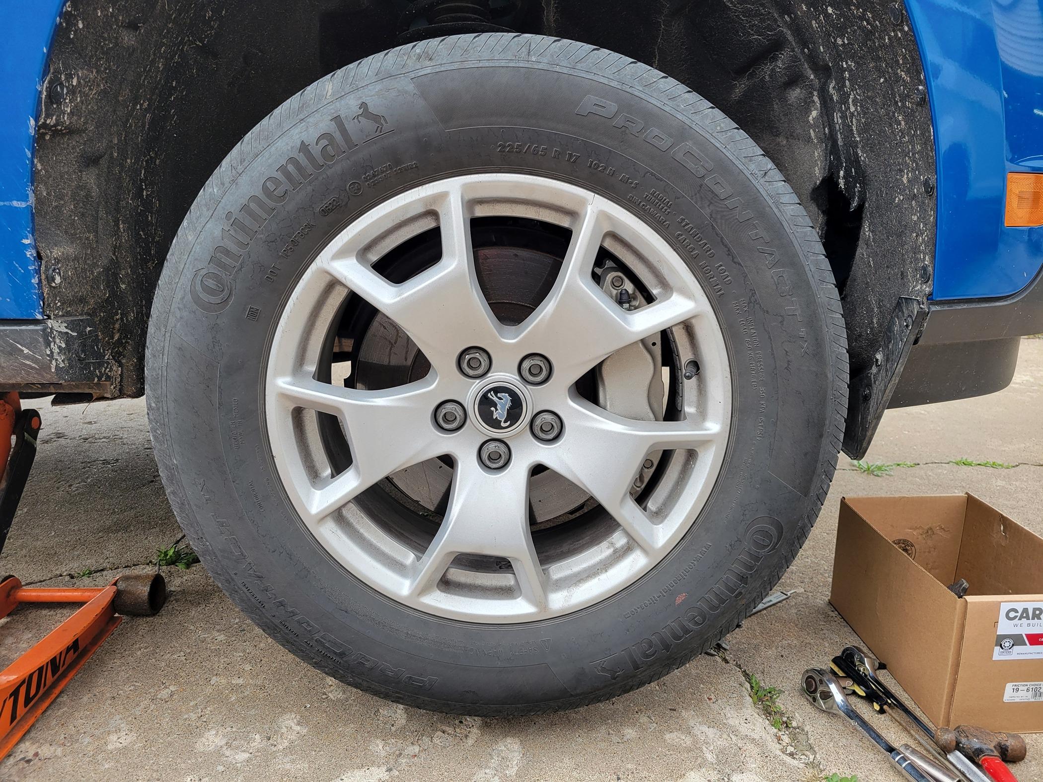

Ok, I did the test fitting on the other side. It was actually off farther than the first side! The passenger side will need milled down .070" to be on center of the factory rotor, and the driver's side will need .115" milled down. I will probably only do like .090" as I don't want to remove too much material from the mounting tabs. The driver's side had a lot more contact with the bronco sport wheel. Hopefull after milling down, everything will clear just fine.
Onto the brake lines. I did some research on the fittings, and it looks like Ford uses inverted flare for the fittings, and volvo uses bubble flare. I know the volvo brembo calipers are 10x1.0mm thread, but I'm not positive on the Maverick's thread yet. The one place I found said the 2021 escape was 10x1.5mm, but I'm not believing that yet till I have more info. Almost all brake fittings are 10x1.0. They don't make a fitting to adapt, so I may actually make the fittings myself. I'll keep the thread updated!
