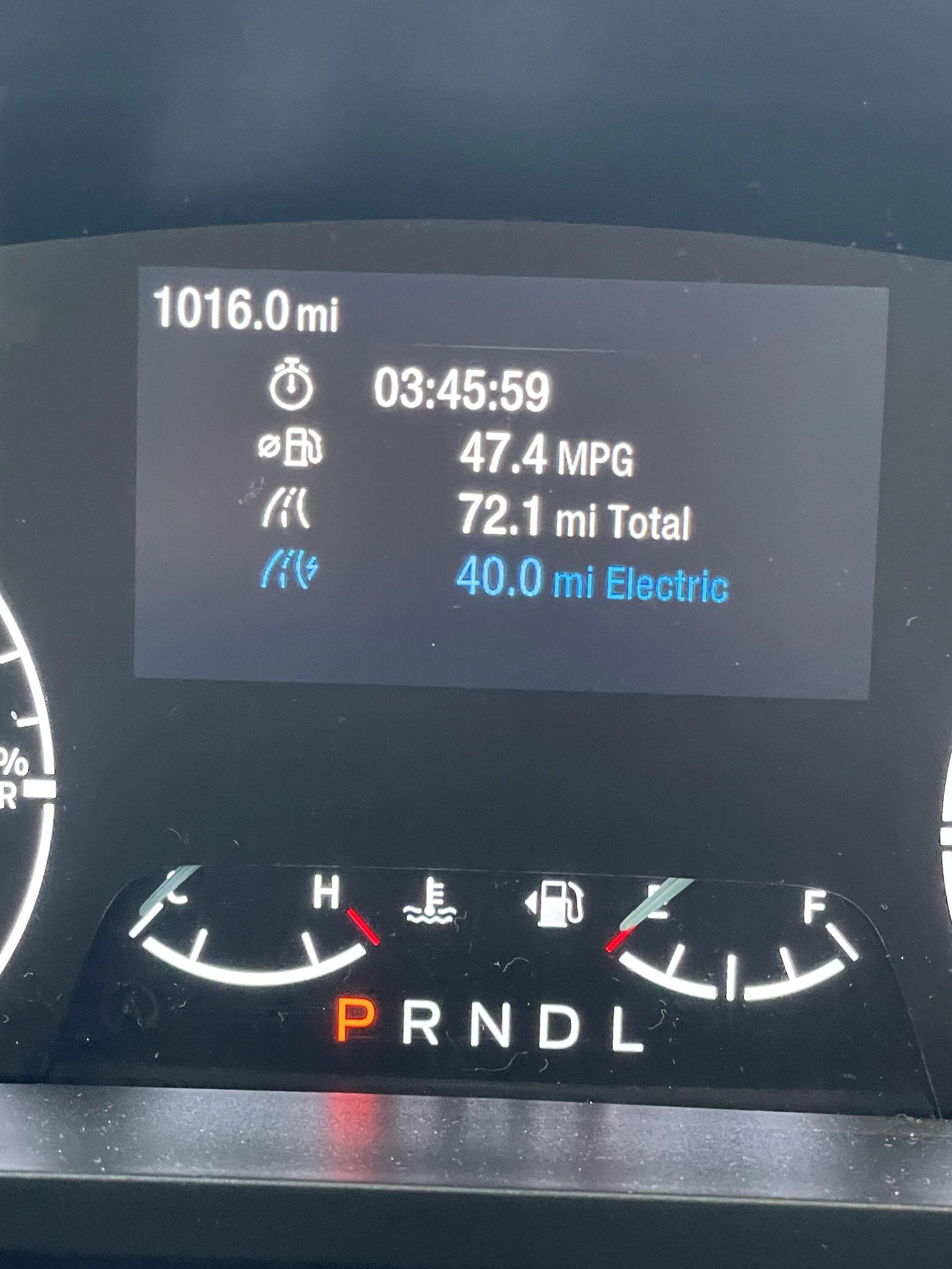

My hybrid after an afternoon of Ubering.
Ford Maverick Poor fuel mileage IMG_5472
