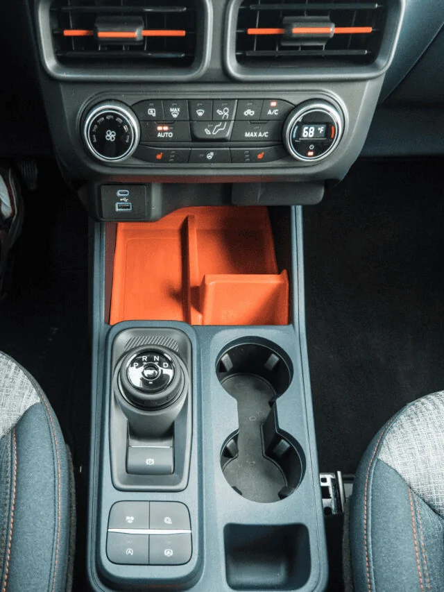

You probably turned on Auto Hold. In the picture below, it'd be the button below the gear shifter on the bank of 4, on the bottom right. This icon:

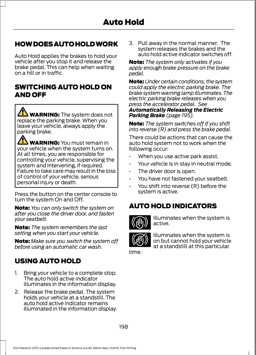

Per your manual:
