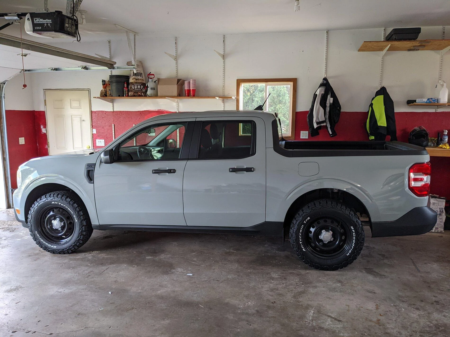

Looks great but you should have paid to have them professionally powder coated.
I agree, especially since the wheels are, well, steel, so they can use regular (durable) high-temp powder coating without any worry.
Alloy wheels should use low-temp powder coating since the high temp coating is close to the temperature that aluminum starts to anneal. High temp probably won't cause any issues, but I'm pretty risk averse.
This looks great, I wanted to do this myself, but I have never painted wheels before. I am worried it will look like crap.
I'd call up some local powder coating shops. Gloss black is a common color so you shouldn't have to wait long and it shouldn't be that expensive. Heck a local place told me $40 a wheel if I brought them that day cuz they were doing a batch of gloss black parts already. I'd expect normal price to be $75ish a wheel.

My local place told me about $500 total and it would be awhile because they have a long wait list and low supply because of COVID... So I did it myself for about $10.
The other advantage of DIY is that if you bounce some rocks up and chip, you don't have to worry its just a rattle job that you can touch up yourself easily enough.

Looks great! Not a fan of the silver steelies - it looks unfinished. I've seen the gloss black aluminum rims on an fx4 and the gloss black looked great on that, too.

Looks great but you should have paid to have them professionally powder coated. New rims with no residue all over them are perfect for powder coating.
i’m a diy type of guy myself but can spray paint isn’t going to last very long without chipping or scratching off..
Meh - I used plastidip on my Honda Pilot steelies. They still look great 5 years later.
The whole point is to keep costs low. Getting them professionally powder coated - you might as well just go buy new rims.

Directions on painting the XL steel wheels:
You want to pressure wash the rims first to get any debris off then sand it with 600-800 grit sandpaper and the factory silver color comes off very easy.
Then pressure wash again and wipe clean.
Let it dry then place index cards in-between the rim and tire to protect the tires from over spray.
Then just use a rim specific spray paint and put 3-4 coats of paint on.
2022 Ford Maverick painted black steelies steel wheels on BFGoodrich KO2 245:65:17.jpg
2022 Ford Maverick painted black steelies steel wheels on BFGoodrich KO2 245:65:17 3.jpg
2022 Ford Maverick painted black steelies steel wheels on BFGoodrich KO2 245:65:17 2.jpg
2022 Ford Maverick painted black steelies steel wheels on BFGoodrich KO2 245:65:17 1.jpg
Wow - I got to say that's it - that's the look. I love it. Better than aluminum XLT - I wasted my money. Except I needed cruise control. - which is a thumb in my eye
$300 is in the range of nice take-offs, granted finding take-offs in this wheel pattern is going to be tough.
Wow, those look great!

Ford Maverick Painted black steelies on BFGoodrich KO2 245/65/17 PXL_20211027_205331574
Some people wanted to see what it looked like with the original hub cap covers so here they are. I'll be going with these hup caps I bought off Amazon.
