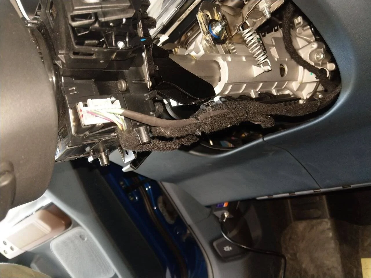

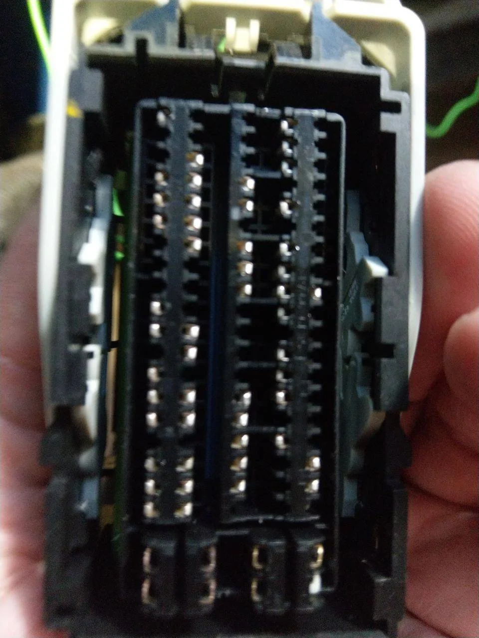

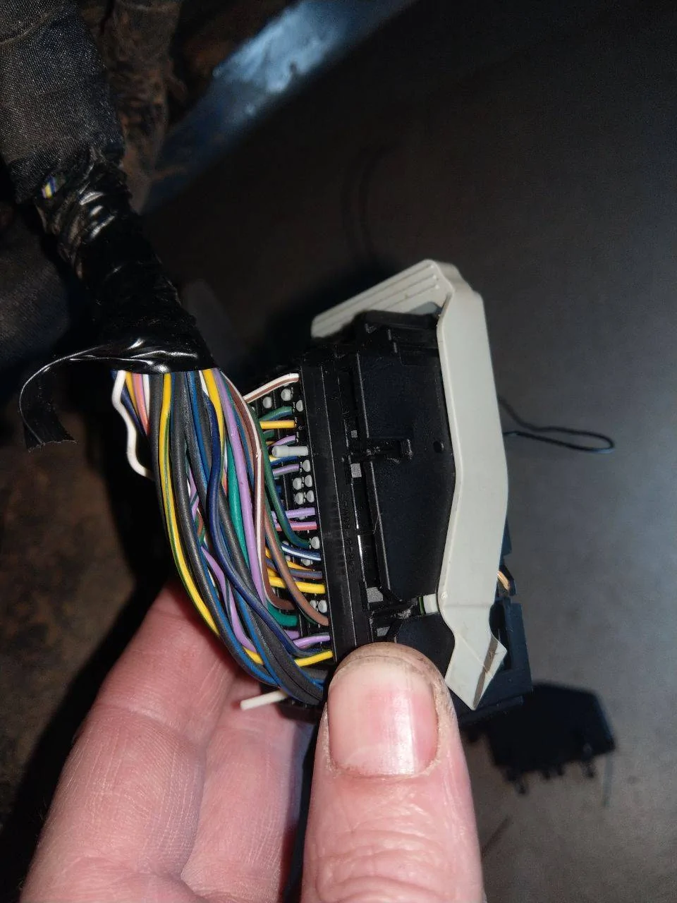

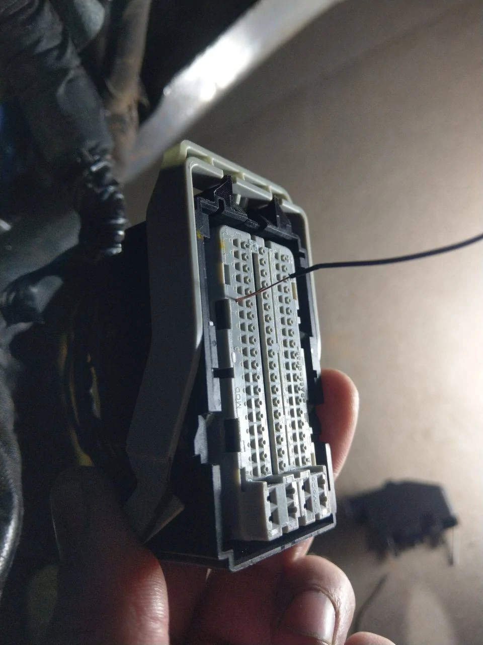

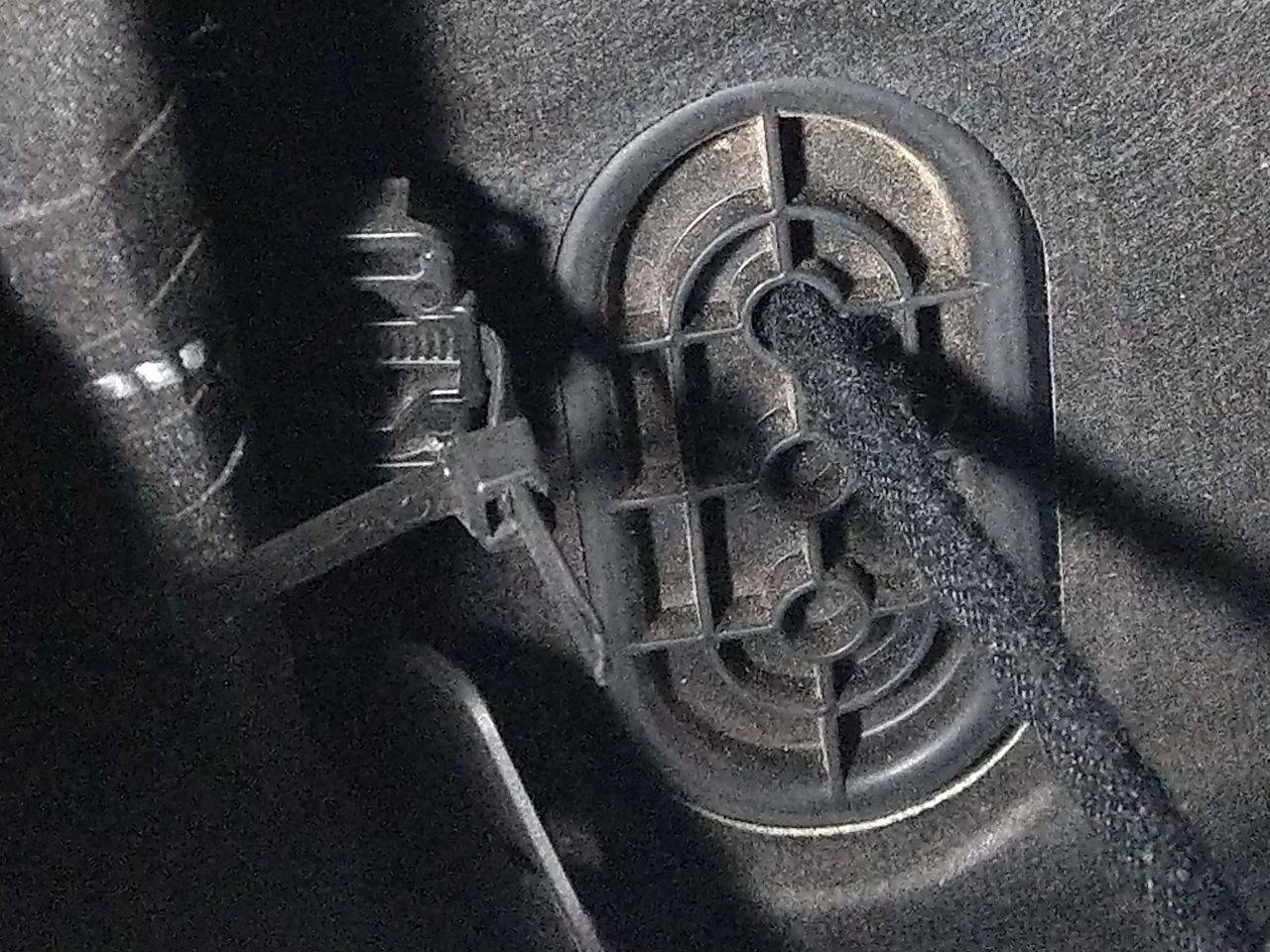

lariat 2.0
Everything working according to the tutorial. Steering wheel purchased in Spain from a Focus 4 for $140.
Gracias Antonio.

Glad it all work . Me alegro que todo alla trabajado amigo.
