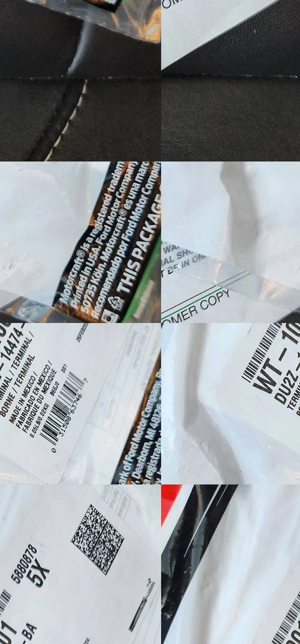

I really appreciate your help, do you have any of the terminals you would like to sell?
