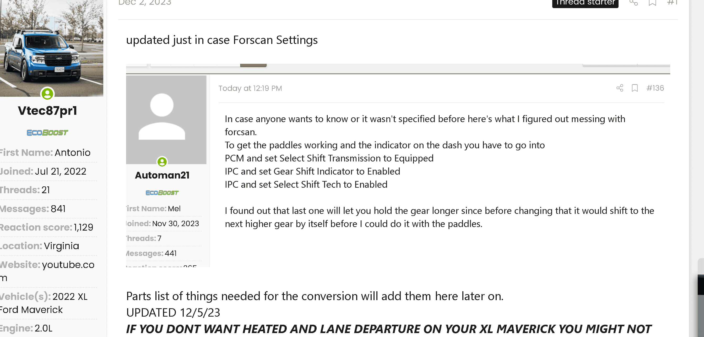

In case anyone wants to know or it wasn't specified before here's what I figured out messing with forcsan.
To get the paddles working and the indicator on the dash you have to go into
PCM and set Select Shift Transmission to Equipped
IPC and set Gear Shift Indicator to Enabled
IPC and set Select Shift Tech to Enabled
I found out that last one will let you hold the gear longer since before changing that it would shift to the next higher gear by itself before I could do it with the paddles.

updated just in case Forscan Settings

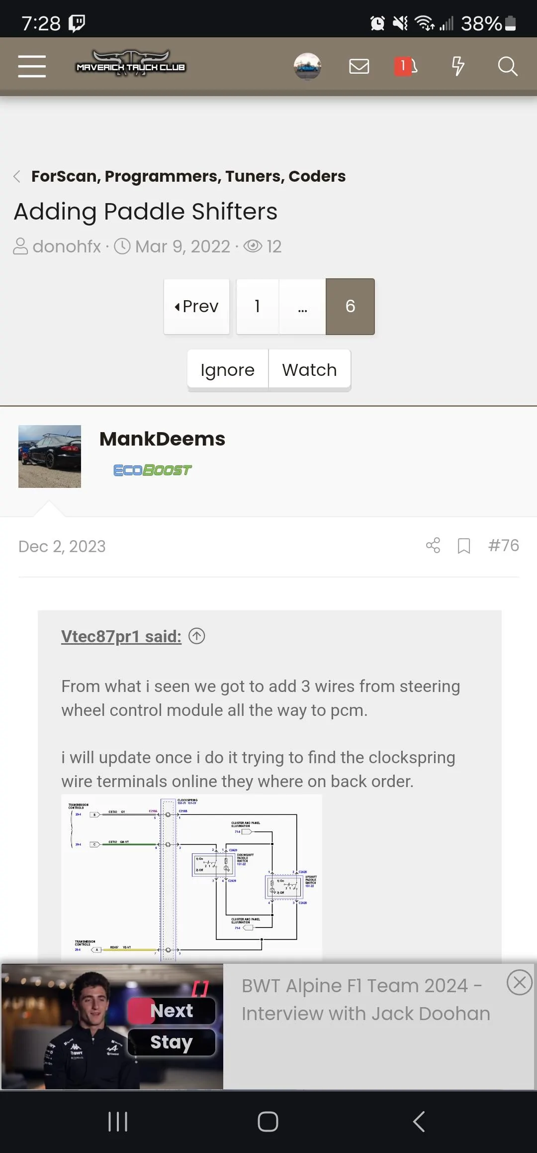

Transmission paddle shifters wires diagram. adding here.
Now i will be adding the Ford Maverick 2022 XL since thats the one i drive . Mine already has Cruse Control added and other switches. Notice this one on the PCM Shows it already comes with 2 wires for the up shift and down shift on XL model its false the diagram i had to add all 3 wires.
PCM Connector from 2022 Ford Maverick shows pin 5 and pin 6 from pcm having shifter up and down . Good sign """
