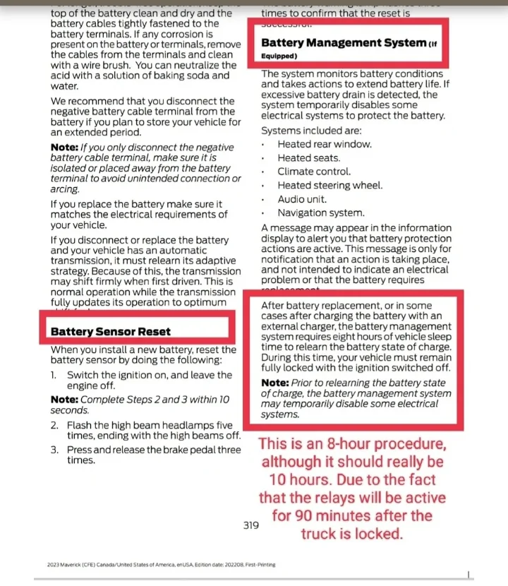

Ford Maverick 12V battery swap - YouTube
The cite above shows guy removing the plastic trim.
hopefully this helps.
What was the purpose of the 5 highbeam flashes at the end? Does that cause the ECU to do something?
Edit: Ah, I see now.
Flashing the high beams 5 times in a Ford Maverick (with ignition in "On"/accessory mode, engine off) is the manual procedure to reset the Battery Management System (BMS), often done after replacing the 12V battery. Follow this by pressing the brake pedal 3 times within 10 seconds; the battery light should flash to confirm.
BMS Reset Procedure Details:
  • Condition: Ensure the car is in "On" mode (push button twice without pressing the brake, or turn key to "On").
  • Action: Pull the high beam stalk towards you ("flash to pass") 5 times.
  • Confirmation: The battery light on the dashboard should flash 3 times, indicating the BMS is reset.
