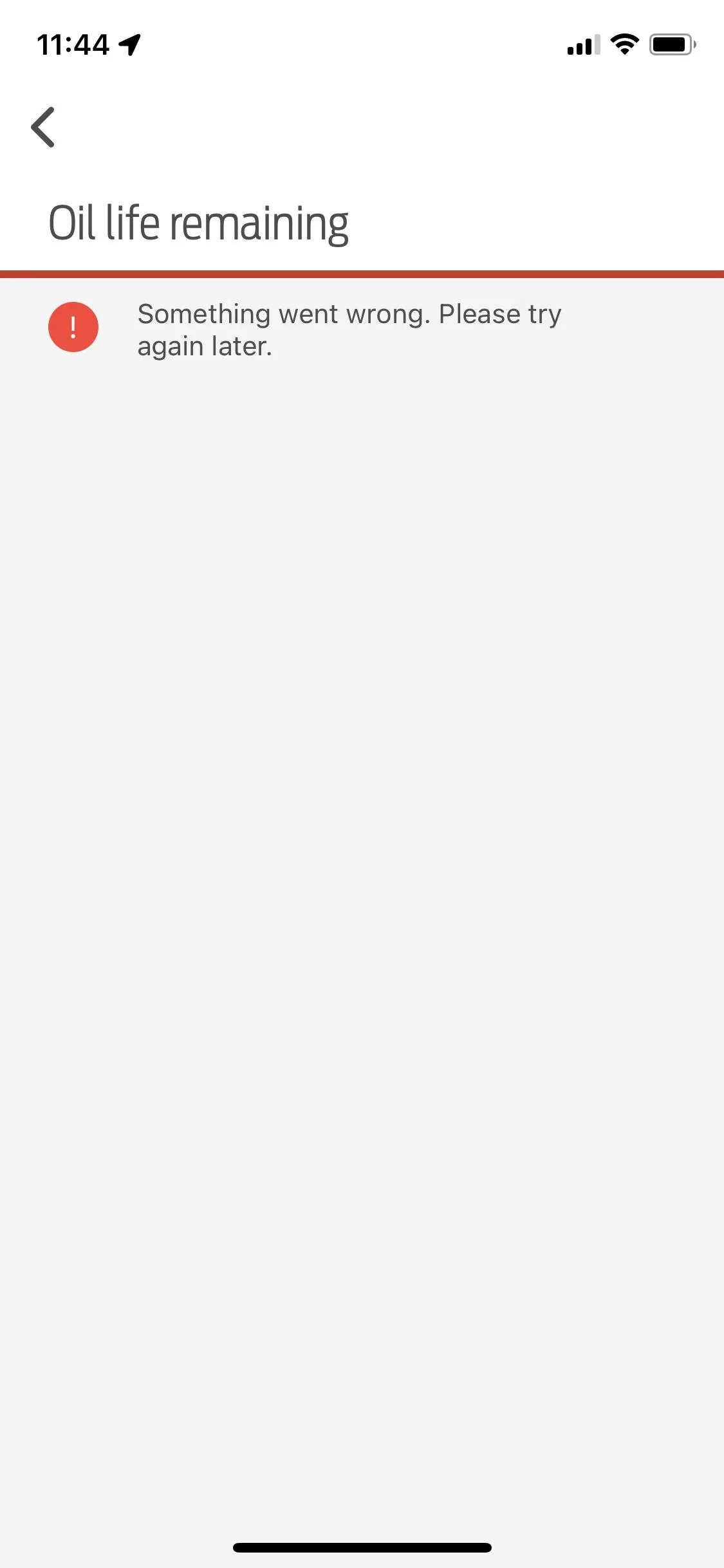

For everyone getting an error, are you using an iPhone or Android device?
The iOS app was updated about a week ago which agrees with OP's timing.
On my iPhone, deleting and reinstalling FordPass let me see the oil life screen the first time I opened it, then it went back to the same error.
Sounds like a bug in the update indeed.
iPhone here, and I just had the same experience. I think you are on the mark.

iPhone w newest update.
ford pass 4.18
Oil life monitor not working

Same here, iPhone, oil life error.

Android with newest update.
Ford Pass 4.18.0
I just checked mine again and it is working fine. No errors at all.
Home screen shows my OD at 4844 miles with 244 miles to empty.
Tire pressure as 37, 37, 36, 36
Oil Life remaining at 47%
ford pass 4.18
Yuup uninstall it works for a day then it quits again after the last update iphone

Error message for several days now for me. Everything else is fine.
Hi there. This concern doesn’t sound like something we want you to experience with your Maverick. Could you please send us a PM with your VIN and the name and location of your Ford dealer? I'd be happy to look into how I can assist you on my end.

Has nothing to do with a specific user or VIN. Have the team do some testing on FordPass app v 4.18 on iOS. It's affecting everyone, not just here with Mavericks, but with Broncos, Bronco Sports, etc. Just tell them to pull up the oil life screen and they'll get the error.

Iphone ProMax 13 here & same problem. Hope they are working on resolving the problem.

Yep, the timing strongly suggests this is just a compatibility issue with Apple's recent update. My wife's Android phone brings it up just fine, so......there ya go!

Anyone else having this issue? For a week this is the message I get on FordPass about my oil life. It had been working properly for over a month. Any idea how I can I fix it? Oil level is fine.
same here

iPhone user here. Not working for me either.

Can confirm not working for me either. iOS and Ford Pass both running on their latest builds.

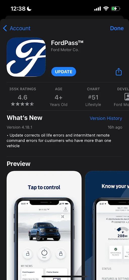

Apple IOS Fordpass was just updated. Latest update solved the problem.
Confirmed. FordPass for iOS v. 4.18.1 was released 16 hours ago (last night), addressing this and one other issue.
After the update, I'm able to close the app and relaunch repeatedly with no errors on the Oil life remaining screen. Works as expected.
Thanks for the (relatively) quick fix, @Ford Motor Company!
