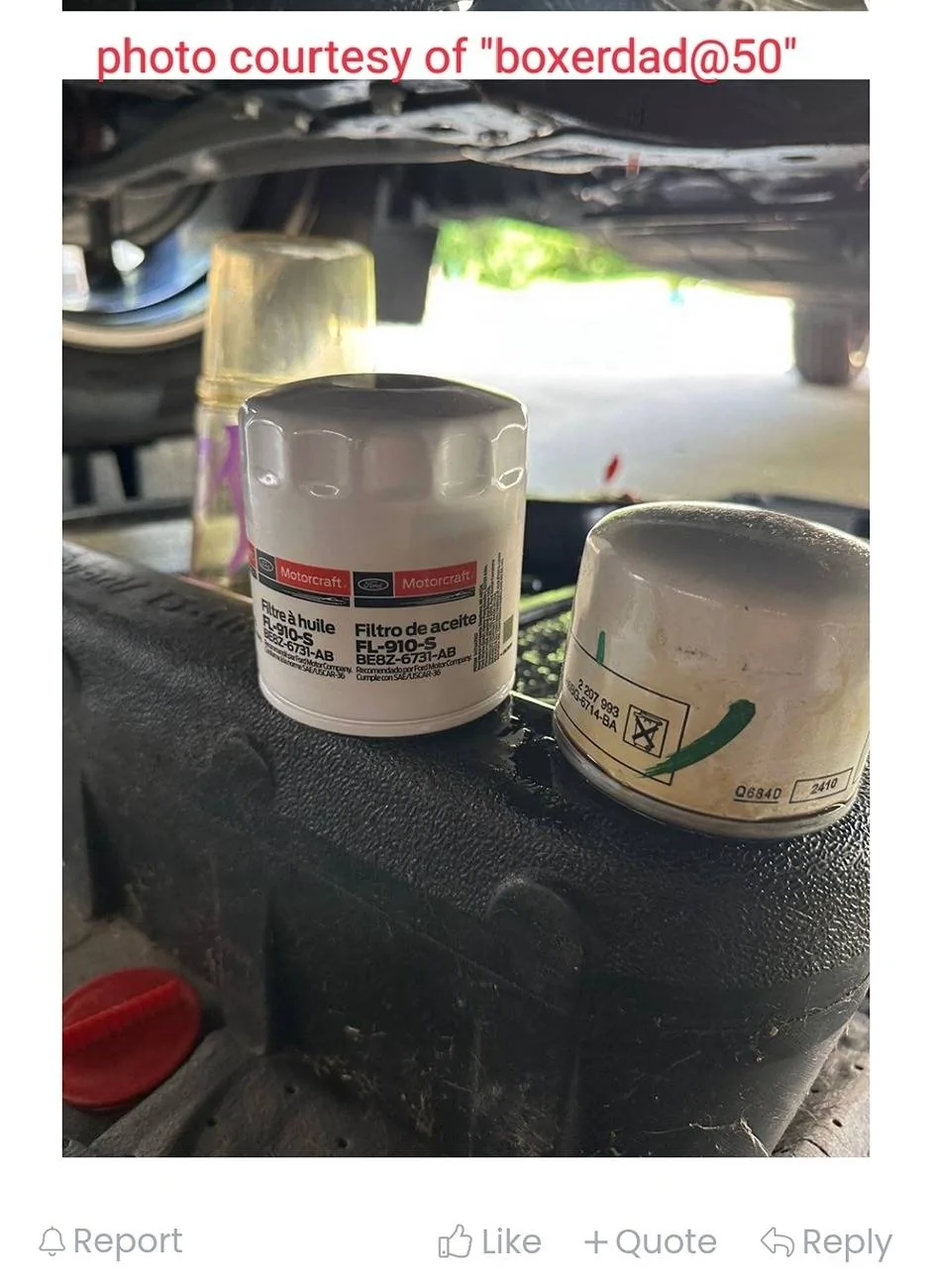

🤔 The OEM filter is a regular filter size for a Maverick?
Correction
Ford doesn't install a smaller filter just for production. If I'm wrong.
I am wrong
I would sure like to see a side-by-side picture comparison.
and here is the picture proof👇👇

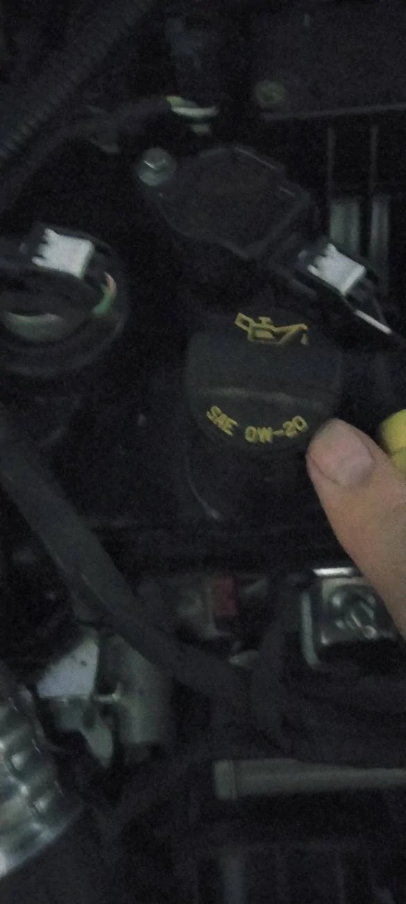

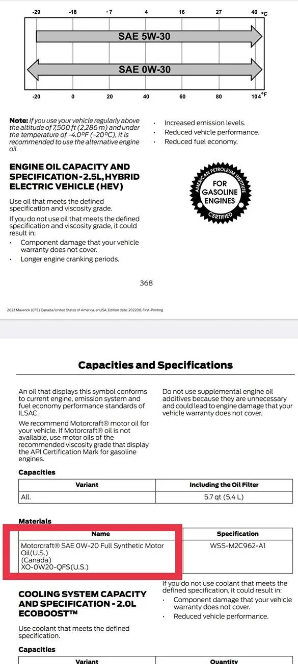

Yes. The Oil weight is 0w20 as stated in at least two places. Your manual and if you forget or don't feel like referring to the manual. Open the hood, it's on the oil cap👍
My 23 owner's manual states Full Synthetic for the hybrid 2.5

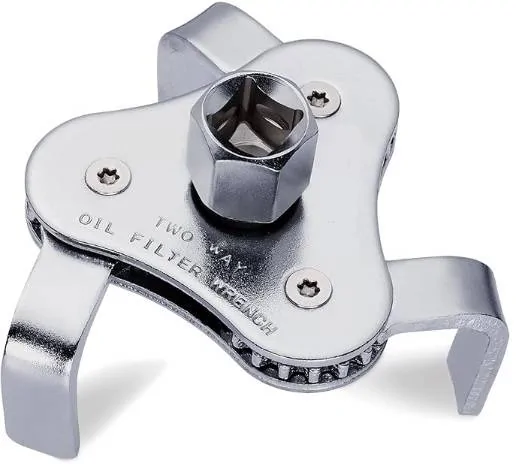

I think you might find a 3-jaw oil filter wrench like this $13 one from Amazon to be pretty handy. It will reach in there and give you all the grab you need even if your fingers are oily. It takes a standard 3/8" square drive and comes with a 1/2" adapter as shown here.
