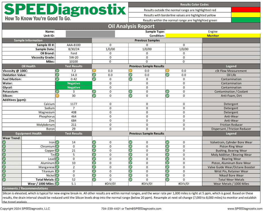

This is my first OCI since buying the truck with 5k miles on it, back in January. Just clocked 15k mi, and the 5w-20 (might actually be 0w-20) from the Ford dealership had 10,100 mi on it. Oil life was at 26%. Had a Ford filter.
As I am in North Texas, I replaced the oil w/ Kirkland 5w-30 synthetic, to see if I can lower the already excellent wear metal number. Also need to check the air filter to see if it is ingesting some dirt (silicon #).
Here are the results from SpeedDiagnostix
Ford Maverick Oil Analysis for 10k mi interval, '23 Hybrid XLT 1725630836162-u3

Well, the cap viscosity is always a compromise value for the variety of operating conditions where the vehicle is sold, and of course however Ford reacts to pressure from CAFE. Is 0W20 optimal for *my* Maverick, in *my* operating conditions? Maybe. Maybe not. Fortunately, I can be data driven here, rather than speculation based on superstition, guessing, anecdotal reports, etc.
I do *know* that Ford 0w20 (probably) and very likely other SN-Plus/GF6A rated 0w20 performs quite well for 10k miles in my truck, and I could continue using that viscosity in confidence. Will 5w30 be better, worse or the same? Time and data will tell.
My seat of the pants impression with 5w30 is that the engine is slightly quieter than on 0w20. No material change of MPG during 3/4 tank on 5W30, nor detectable difference in power.

You made my argument; for 0w20 or 5w20, vs 5w30, an immaterial to zero difference in viscosity for cold/cool ambient/operating, but a notable difference--I'm assuming beneficial until the next analysis-- in viscosity for hot ambient/operating, where my Mav spends the majority of its time. 5W is objectively plenty thin for NTX.
As for getting oil to all the bits in a timely fashion, it's a positive displacement pump, so it produces (in practice) the same volume of oil per rotation, for any commonly available gas engine oil. Whether it uses slightly more energy to do so for higher viscocities, for sure.

Also noted his Silicon ppm are higher, like mine. Would like to see that improved as well.

And who knows how much is just oil pan sludge from mfg. Too many variables..

The air filter was spotless, no tears. Will see if drops over time.
Not sure how good Motorcrwft filters are but apparently the Wix line is really good according to Project Farm.
All the talk of oil but honestly a non-premium air filter contributes a lot to wear.
