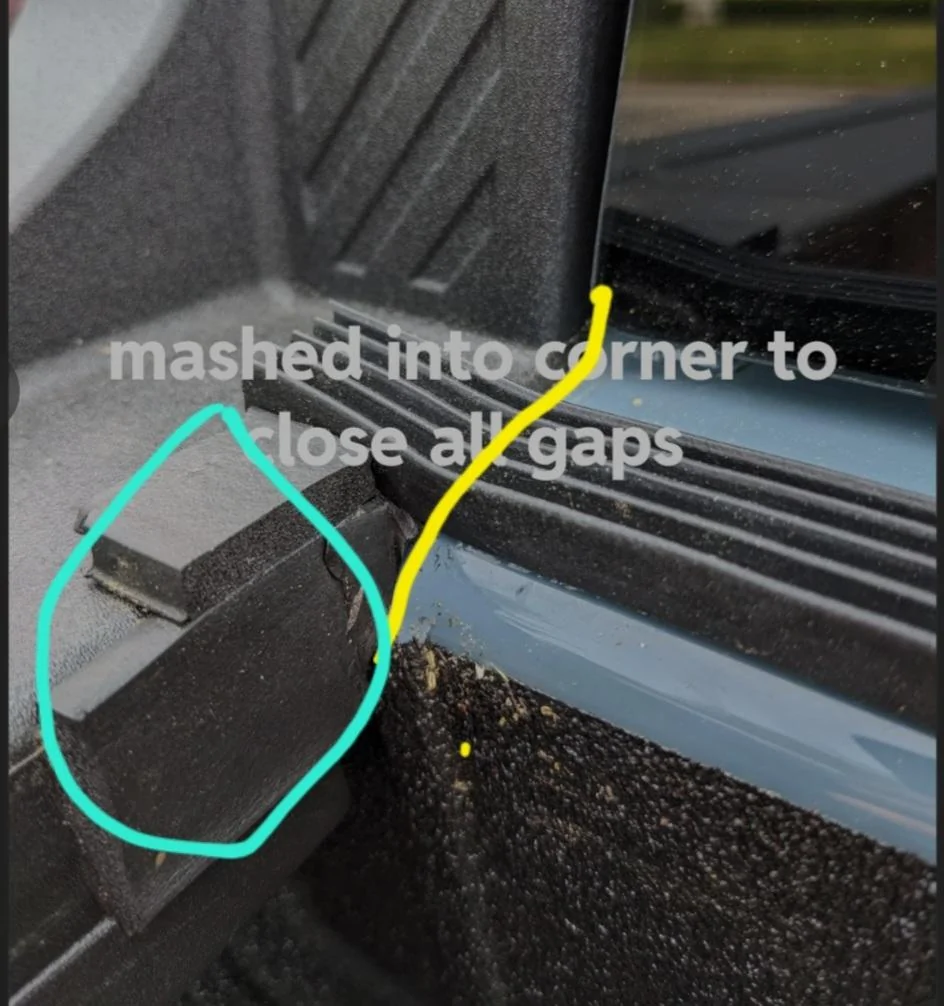

Where your yellow line is should already have filler material from the factory to fill the joint seam. I did not add anything to that, but yours may be different.
Look again at the first picture in the Reddit post and you'll see the gap to fill just above the text in the picture at the end of that piece of putty. If you look at the second picture in the Reddit post, you'll see the author's gap has been totally filled. I only filled the portion of gap that was under the rail of the bed cover.
The items circled in green are pieces the author added to better seal the forward corners against water intrusion. I did not need to use any extra pieces like that. It's soft foam like the multi-ribbed seal across the front, but thinner.

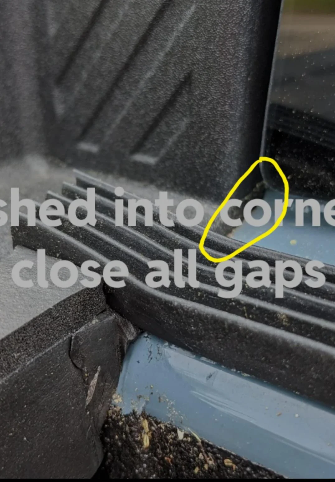

In the 3rd Reddit pic, it appears the silicon putty has been tucked in the joint up to the base of the window where painted body meets the black plastic trim( circled in Yellow). Maybe I'm not seeing it correctly. But this makes me wonder where the water drains in this "moat" that get formed at base of rear window when the putty and weatherstripping are applied. Concerned that it will over time try to leak thru window's bottom seal into cab behind backseat. Am I being too paranoid?

The article's author has clearly added putty to that area in order to make the water flow past it and up to the bedrail cap, where it can flow harmlessly and drain off to the rear of the vehicle. Perhaps it was a low spot or a depression, and he added putty to make a smoother transition and to force water around the ends of the rubber seal.
Are you being too paranoid? Nope. Maybe overthinking it a bit.
If you decide to make this modification on your Maverick, once you get things apart and see it better, you'll know how to proceed.

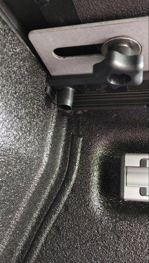

That statement sent me to take pictures because you should have drains if you have the same style hard cover.
Drain tube connection is at the front of both cover rails.
These are pics of the passenger side.
1. The drain port.
Ford Maverick OEM hard tri-fold tonneau leaks badly Drain
2. Drain tube installed.
Ford Maverick OEM hard tri-fold tonneau leaks badly Hose
Hope this helps.

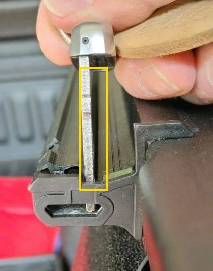

As promised, here are a couple pictures of my cover rail drain channel.
1st pic is at the tailgate end.
Any water that gets past the upper seal runs into the drain channel following the orange line.
As an aside, I also ran a bead of butyl rubber sealant between pickup bed and cover rail. You can see it just peeking out inside the red circle. That's so water won't get into the bed from under the rail.
Ford Maverick OEM hard tri-fold tonneau leaks badly Tailgate End-1
2nd pic shows the depth of the drain channel that runs the length of the rail. I stuck a key in it for scale. The yellow rectangle is the drain channel going toward the front of the bed.
There's an outflow at the tailgate end of the drain channel that I may have to redirect. Waiting for a daytime rainstorm to test.

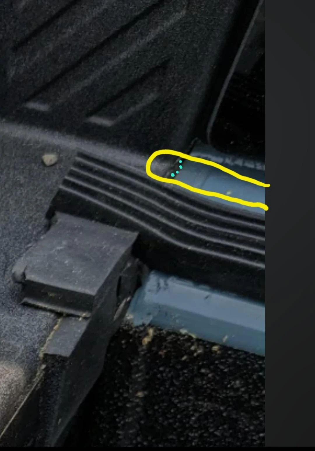

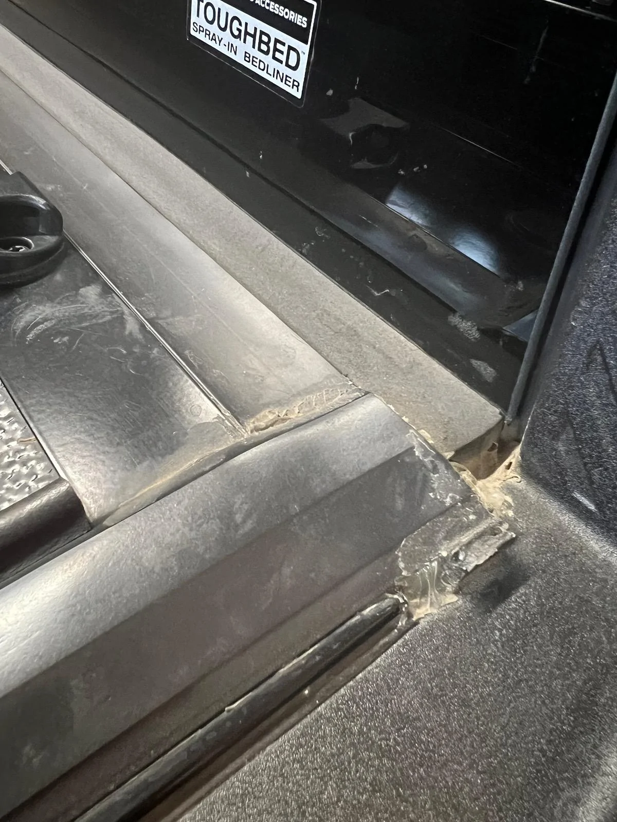

Thanks Steve, I'm still a little confused about what the cover looks like just behind cab & what happens to the water that gets trapped in the Gully formed at front of tonneau and base of window since the black plastic trim on each corner is higher than the metal of the bed.
I am trying to attach a pic but the " attach files" icon won't cooperate
HoiToid
Mar 11, 2024
232
117
. Here's the pic, the Green dotted line shows where the black plastic trim meets the metal of the front of bed under back window in the Yellow oval area
