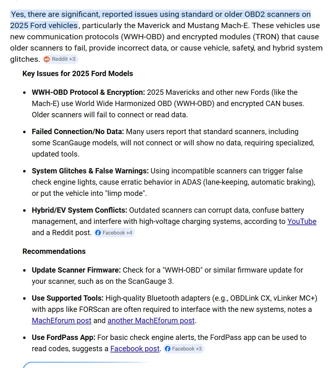

Does anyone have or can recommend a OBD2 scanner for the 2025 and newer Mavericks, that use
the WWH-OBD Protocol and Ecrypted CAN buses. Ford admits there is a known problem with the 2025
Fords and the emission test scanners.

At least several posters with 25MY are using Forscan (and making changes) or Forscan Lite (for viewing info) with one of their recommended adapters. Which are not the cheapest generic ones.
Not sure if that was the app then that got around the new protocol/security, or the adapter already supported it, but the adapters have been out for awhile.
The wireless ones work with Forscan Lite for your phone - should be enough for your usage.
And it should work with Car Scanner app for other vehicles. Or other apps that talk to adapters.
