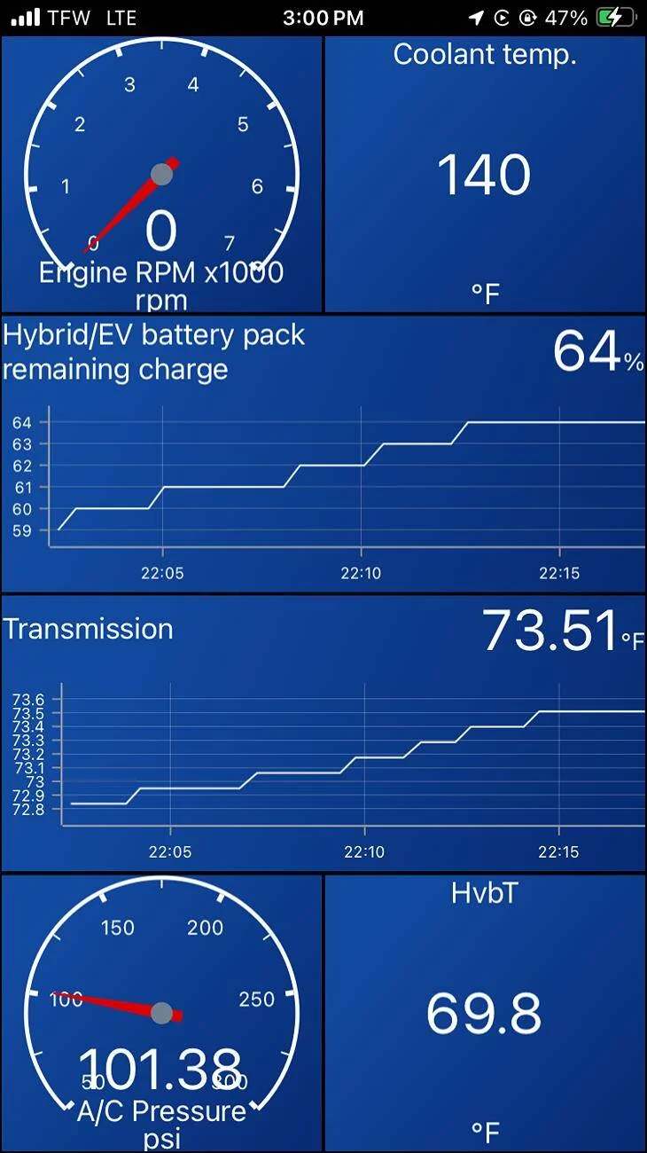

I'm interested in monitoring my engine and transmission temps, battery temps, and whether the a/c is engaged or not. Why? Because it's interesting and I know the a/c kicks on randomly when Ford thinks it should, but I'd like an indication it's on, personally.
I purchased, for only the 3rd time in my life, the full version of an app. This one is Car Scanner, and it was $8 for lifetime use. It's got a specific Maverick PID profile to grab lots of data coming off the OBD2, and combined it with my Vgate vLinker MC+, which wasn't super cheap but has a fairly quick refresh rate vs the cheap $10-$20 ones. Also, power draw is 3mah when sleeping, and the system turns off the OBD2 sometime after shutting down completely, so power draw is 0 when left plugged in.
This "dashboard" isn't set in stone but it's what I've got for now. For those who tow a lot, the temps could be useful information especially the transmission temp - as an example the ULV fluid temp range is up to about 215°F, and above that will start to degrade. Which means, if you exceed that temp, maybe a good idea to change it.
What's nice is you can even set triggers to certain events, or min/max value pointers, for your drive. Super useful.

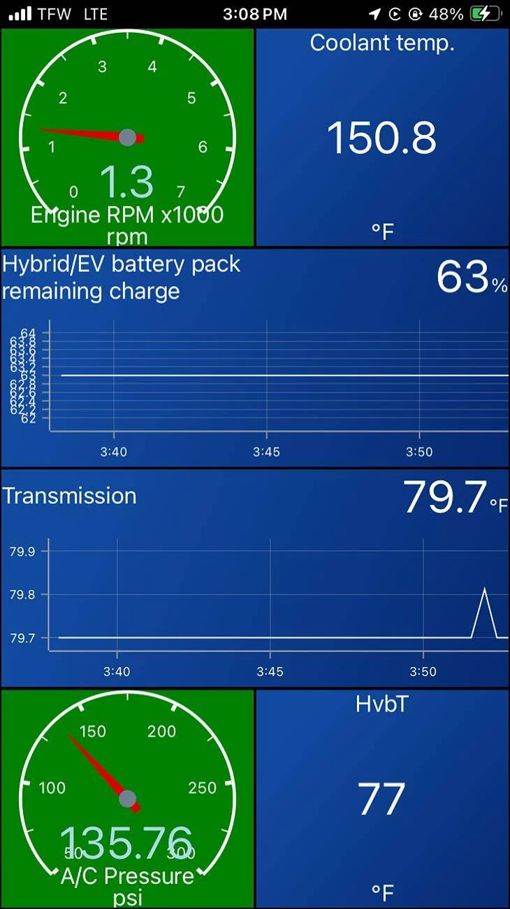

First pic is engine is not operating, and you can see on bottom left, the a/c pressure is around 100 psi. When the engine indicates >500 RPM, and when the A/C pressure indicates >110 psi (tbd if that is a good setting), the background of the gauges turn green (this is customizable, as are the range and look of the graphs and other things).

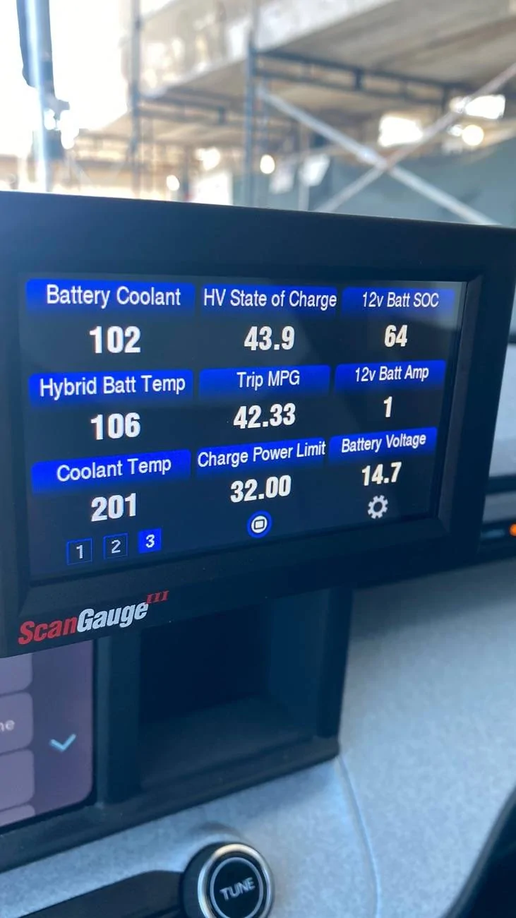

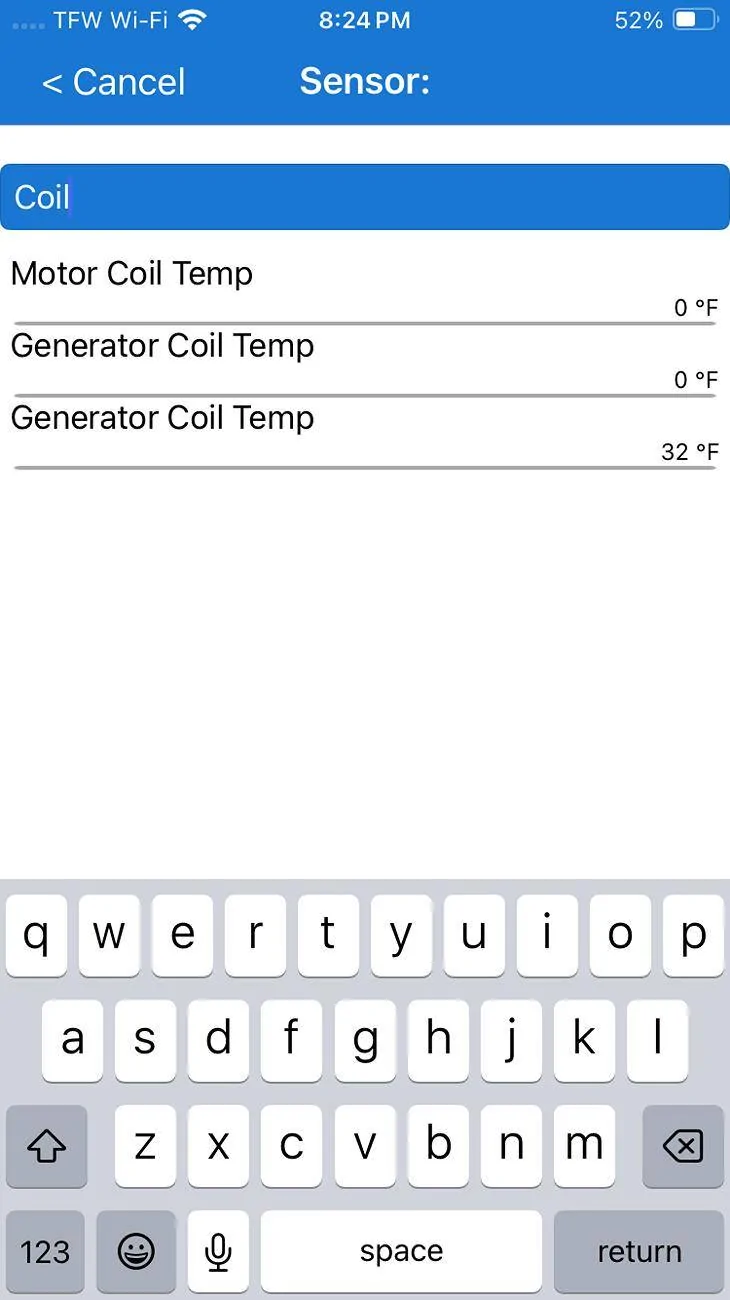

On your scan gauge, how are you tracking that gen temp? What's it labeled as? I'm going through the Car Scanner PIDs and can't find one specifically labeled Gen temp anywhere. Wondering if it's a variation of the ATF temps or something else.
IIRC you had emailed scan gauge and they made an update just for you.
Also are you able to track the traction motor temp?
I found some stuff on the Mach-E forum where they are repurposing the gen temp on the Fusion hybrid so it must be on there. I'm looking in the generic "modern Ford" file and can't find it. I'm sure it's somewhere.
EDIT: Found it, gen coil:

Ok, I had to select generic ford hybrid profile. Weird there are two:
Ford Maverick Monitoring engine / transmission / battery / HVAC parameters using Car Scanner IMG_3482
Thing is, not sure I can use that for the Maverick one. I don't know how to import the custom PID. Still working. This is solid info. Thanks 🙏.

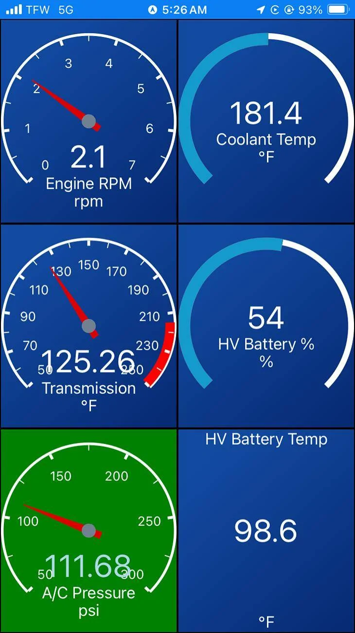

I'd like to get some "normal" parameter limits programmed into my gauges, for example coolant, and then add some trigger events like >250° or whatever makes it go red, same as I did with the transmission temp. I got the 215° temp from Ford for their ULV fluid specs for example.
You could also do something with the engine temp at the low end where the ICE will run till it hits that temp - I think it is around 130? Above a certain temp the ICE won't run unless the HE battery needs more charge or you are asking for more power.
