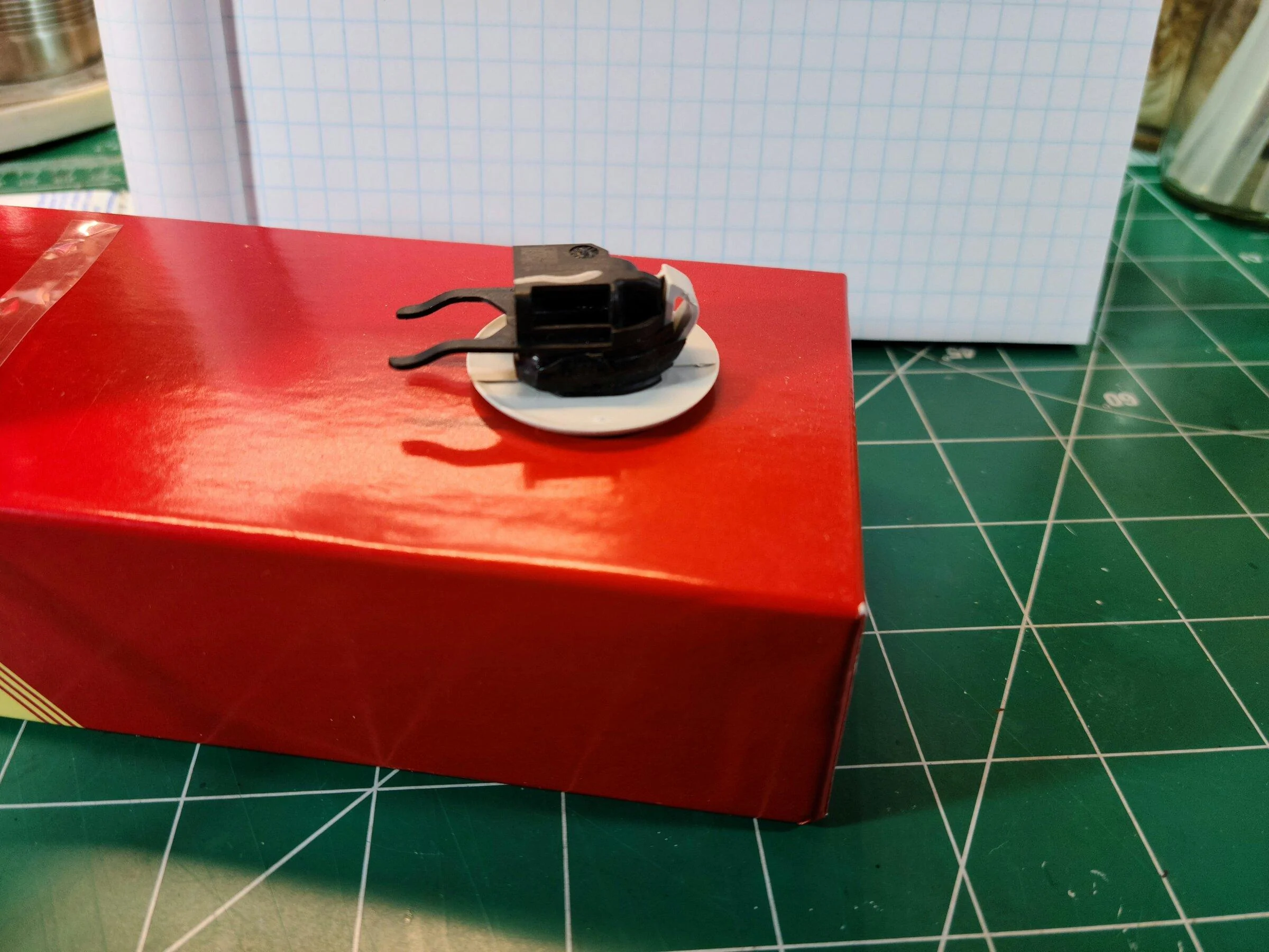

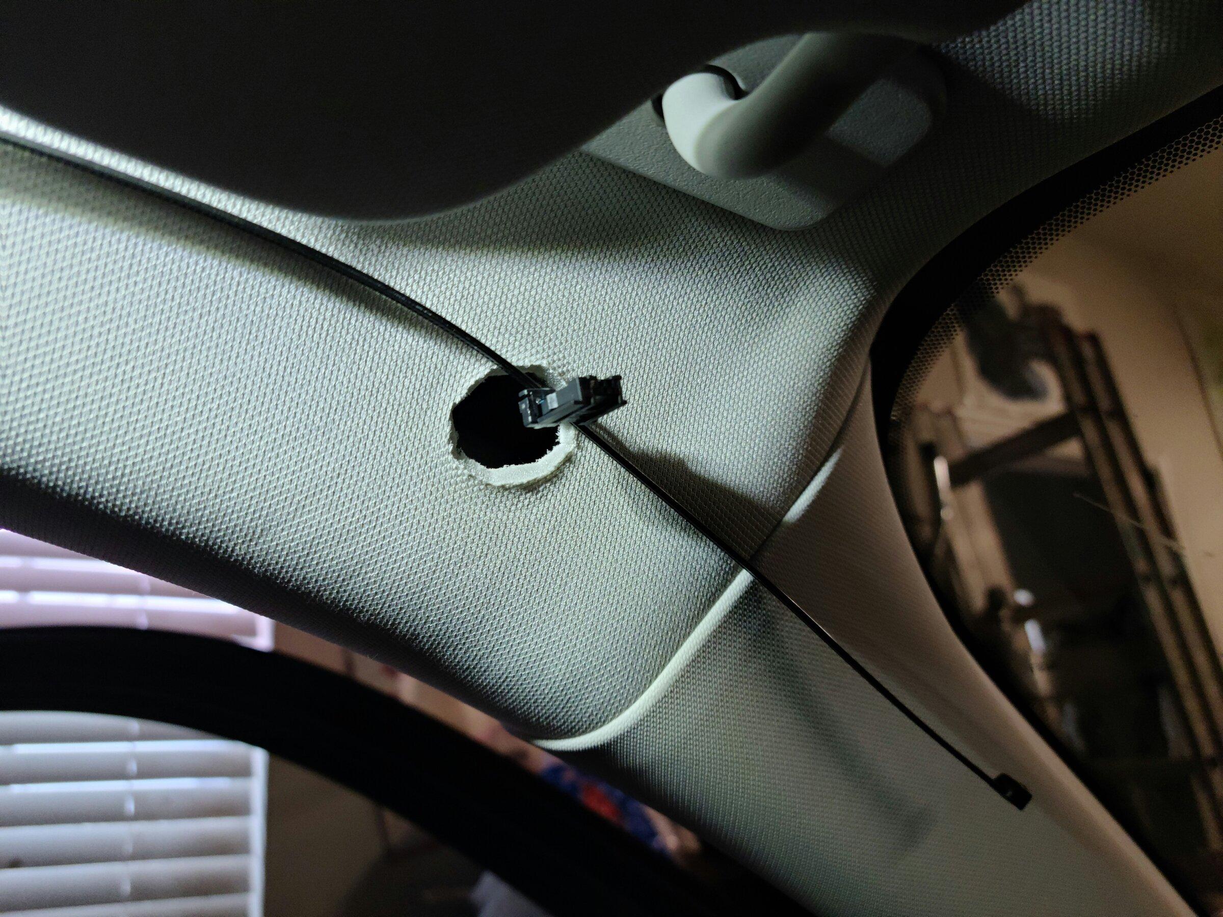

Here is what I found - the mic is a press fit in a fairly crude hole in the headliner:
Ignore the zip-tie, just used it to prevent the wiring from falling into the a pillar.

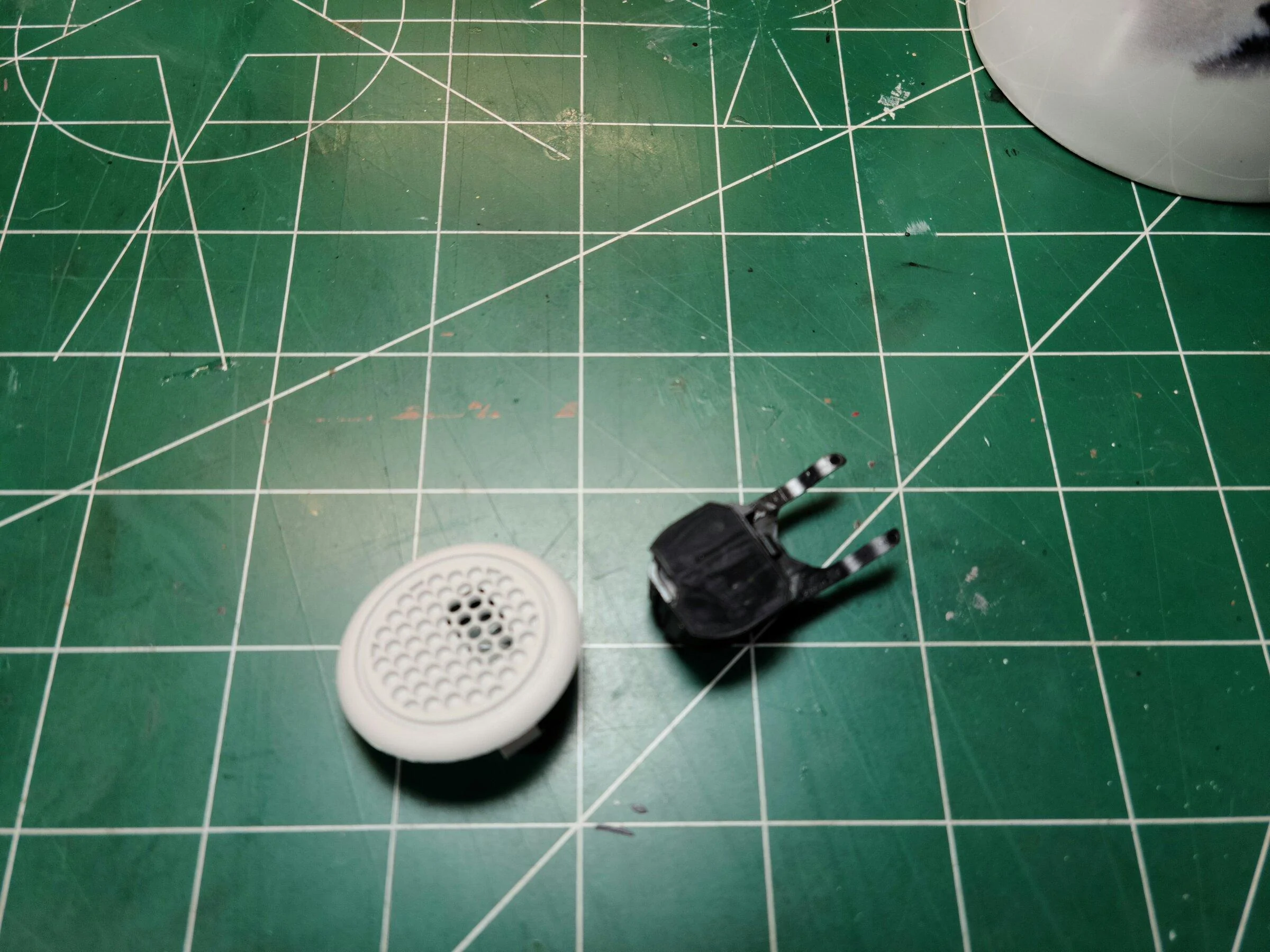

The mic just clips to the grill, and mine was only partially snapped in. I found that even fully snapped in the mic was still loose and would rattle around a bit. Also I found the fabric covering the mic was not installed correctly as it was creased and had gaps on the edges, inside the mic assembly was some headliner lint and dust, and in the plug socket were strings of silicone across the pins likely from whatever supplier makes the mic:
I carefully lifted the rubber grommet, then carefully removed and replaced the fabric after clean8ng all the lint and dust out, getting a full tight seal and no creases. I reassembled and finally I split a length of F4 tape and wrapped tightly through the gray grill clips getting a tight no wobble assembly:
The space behind the mounting hole is just m/t space, nothing back there excepting the air bag materials on either side of the hole. I reinstalled mine and got a tight fit back into the headliner.
Time will tell if this helps, I may pop it back out and stuff some lightweight insulation in there , but for now it is back to stock.
Thoughts?

All reports are that call quality is much much better than before. Some roads still kick up a lot of background noise, but even with that my callers hear me clearly. Sound deadening is still on the work list, but has dropped further down in priority.

I used a nylon trim tool, wouldn't recommend anything metal with an edge as it would be easy to damage the A pillar. Go slow and it will pop out easy enough. The wiring does not have much slack...
