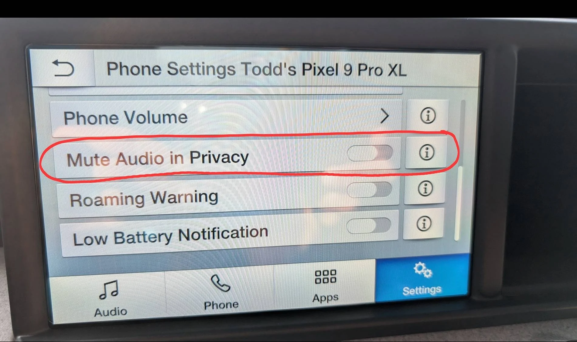

Check the phone settings in the radio, when I paired my new Google pixel 9 pro XL just last week for some reason it had the audio muted to where I couldn't hear the other person. I had to go into the radio settings under phone and undo the mute setting then I could hear the other people I was calling.
On my previous phone I had my Samsung s22 ultra I don't remember the radio doing that by default like it did on my Google Pixel 9 XL.
The setting I circled in the picture is the one I had to change to be able to hear people on the other line of my call.
