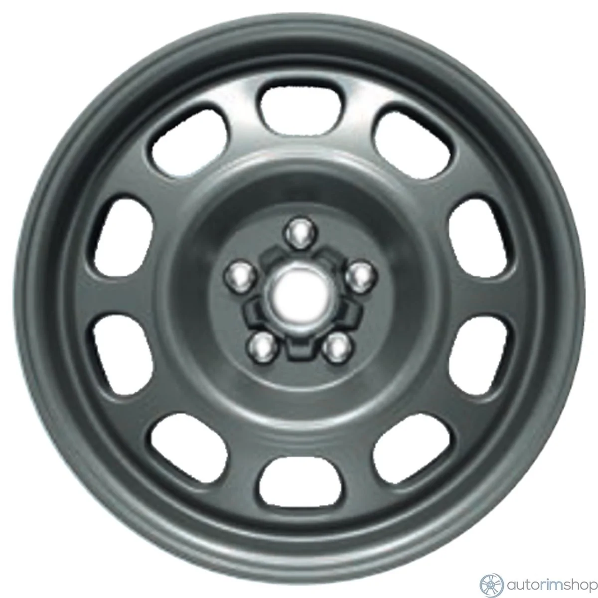

I am assuming the wheels are these...
Ford Maverick New tires and wheels and now it pulls and steers bad BS_wheels

Not sure if an Aluminum wheel could be bent or not. I thought maybe they were steel wheels[which could be bent] as some Bronco Sports come with steel wheels.
