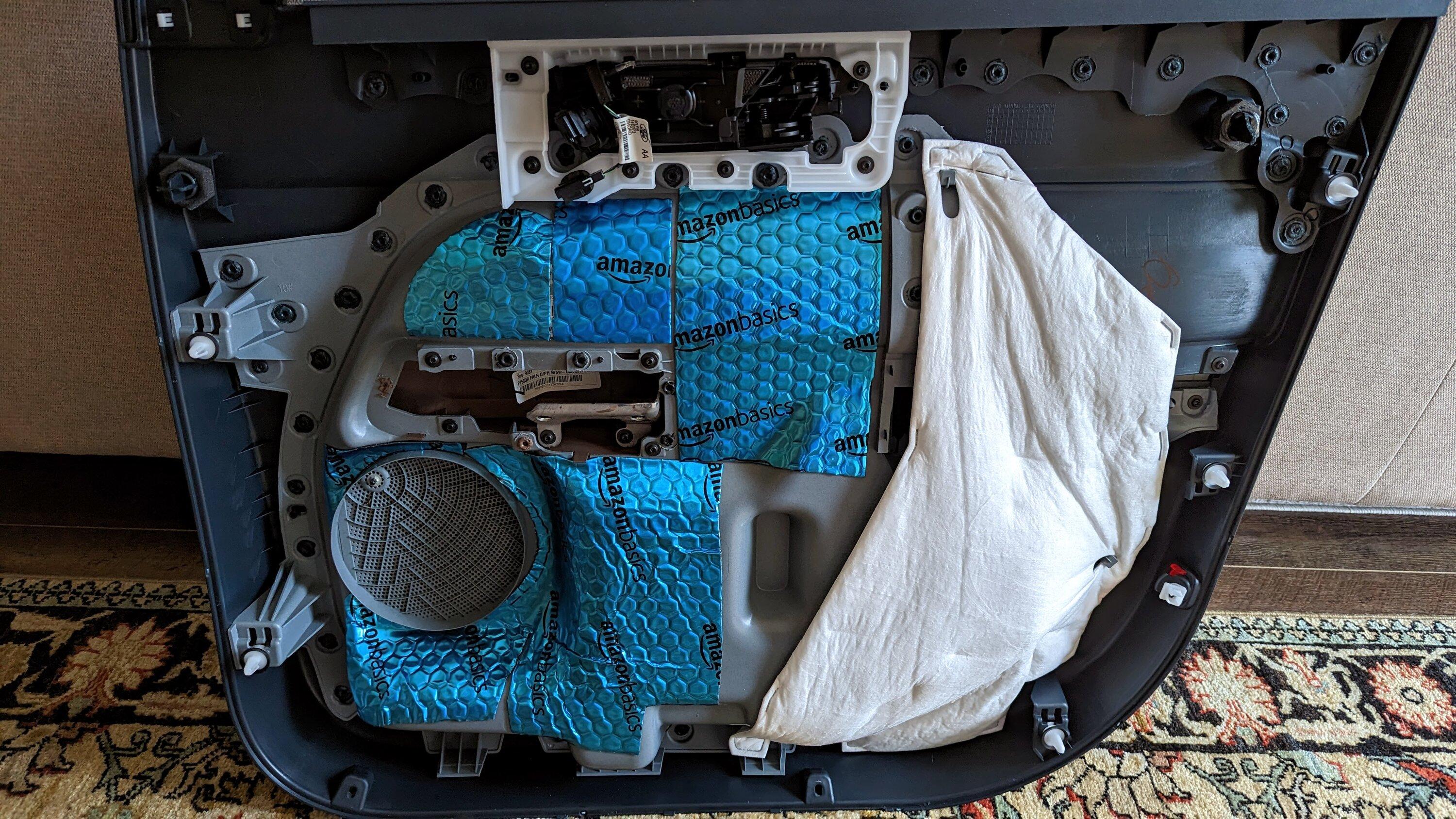

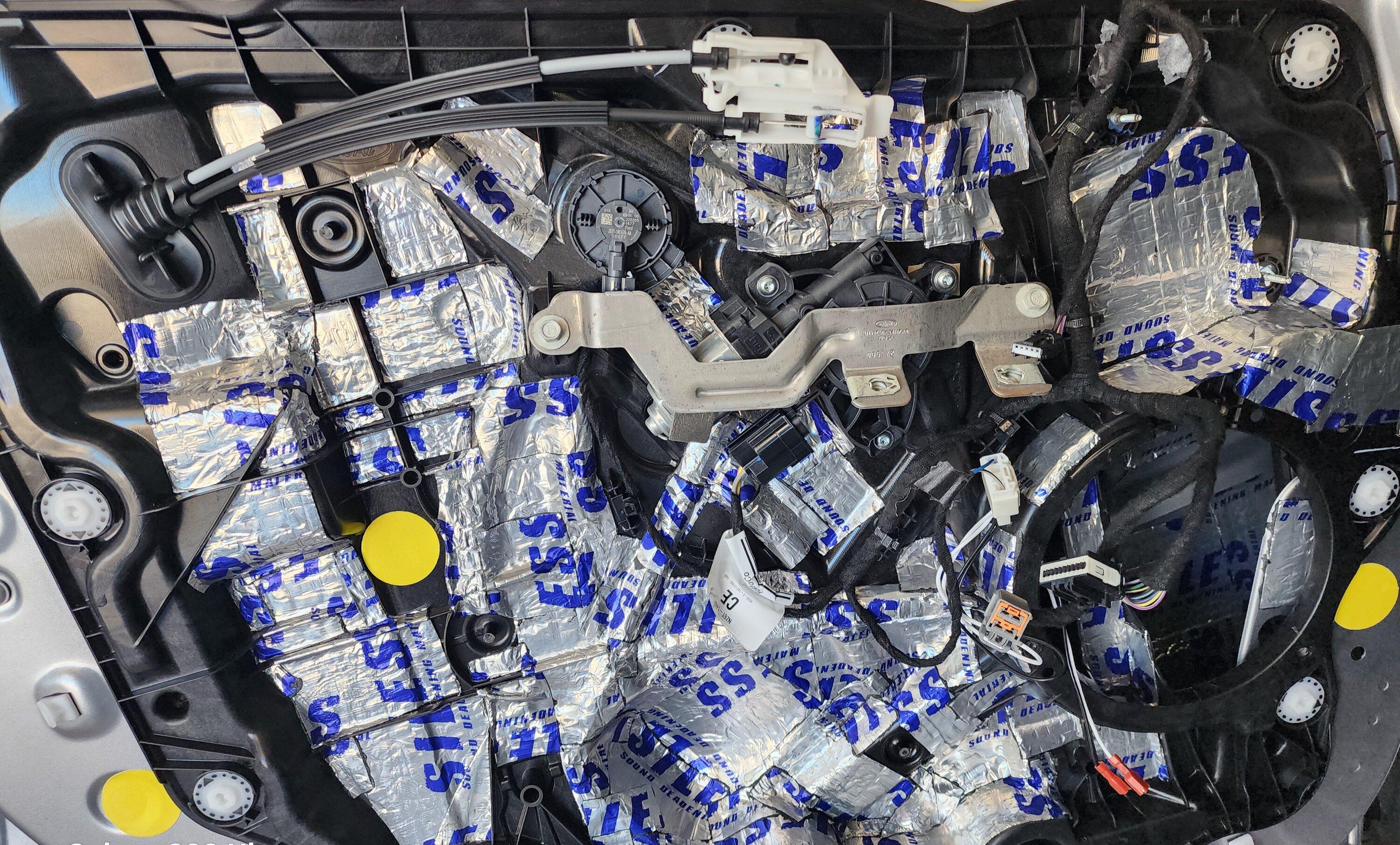

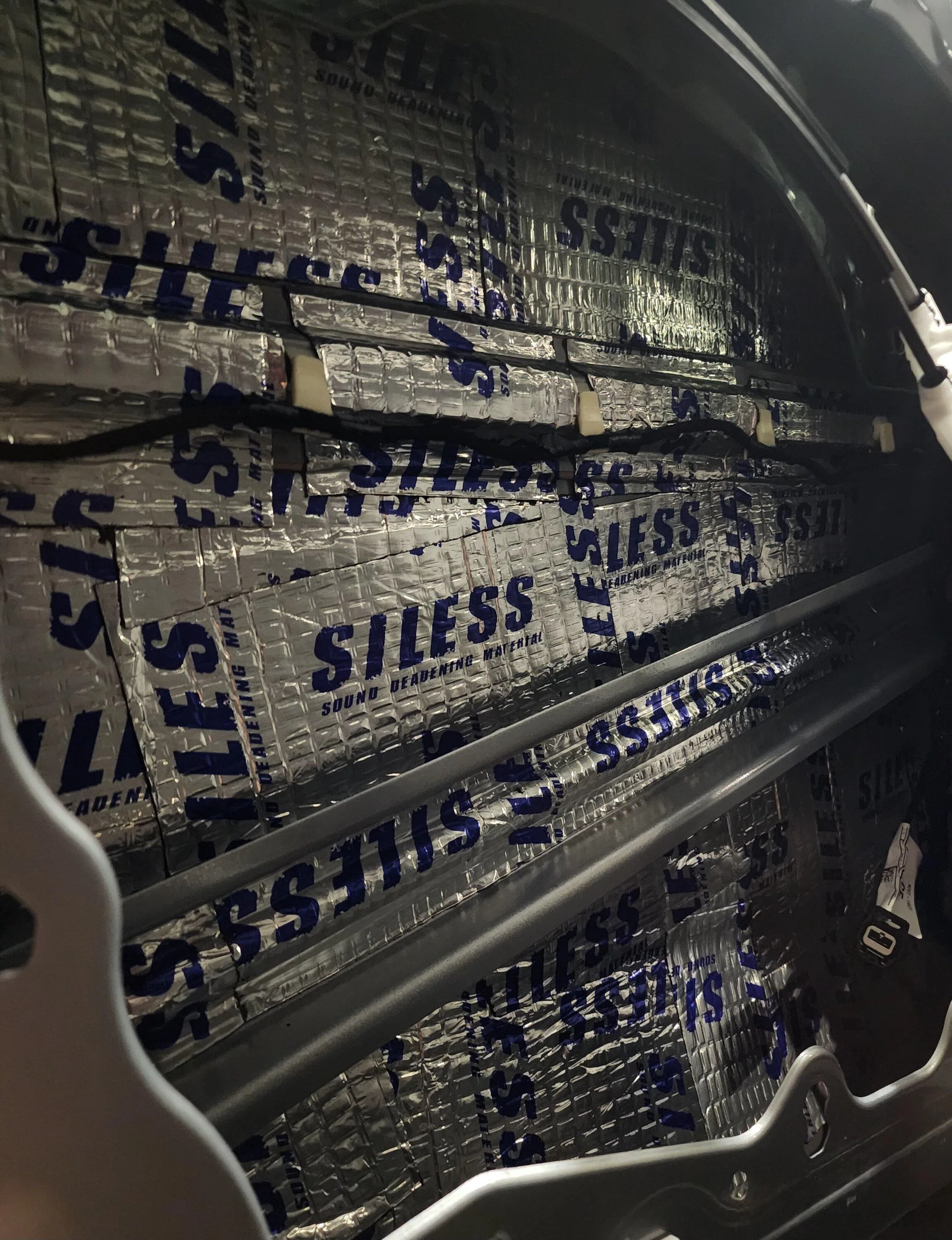

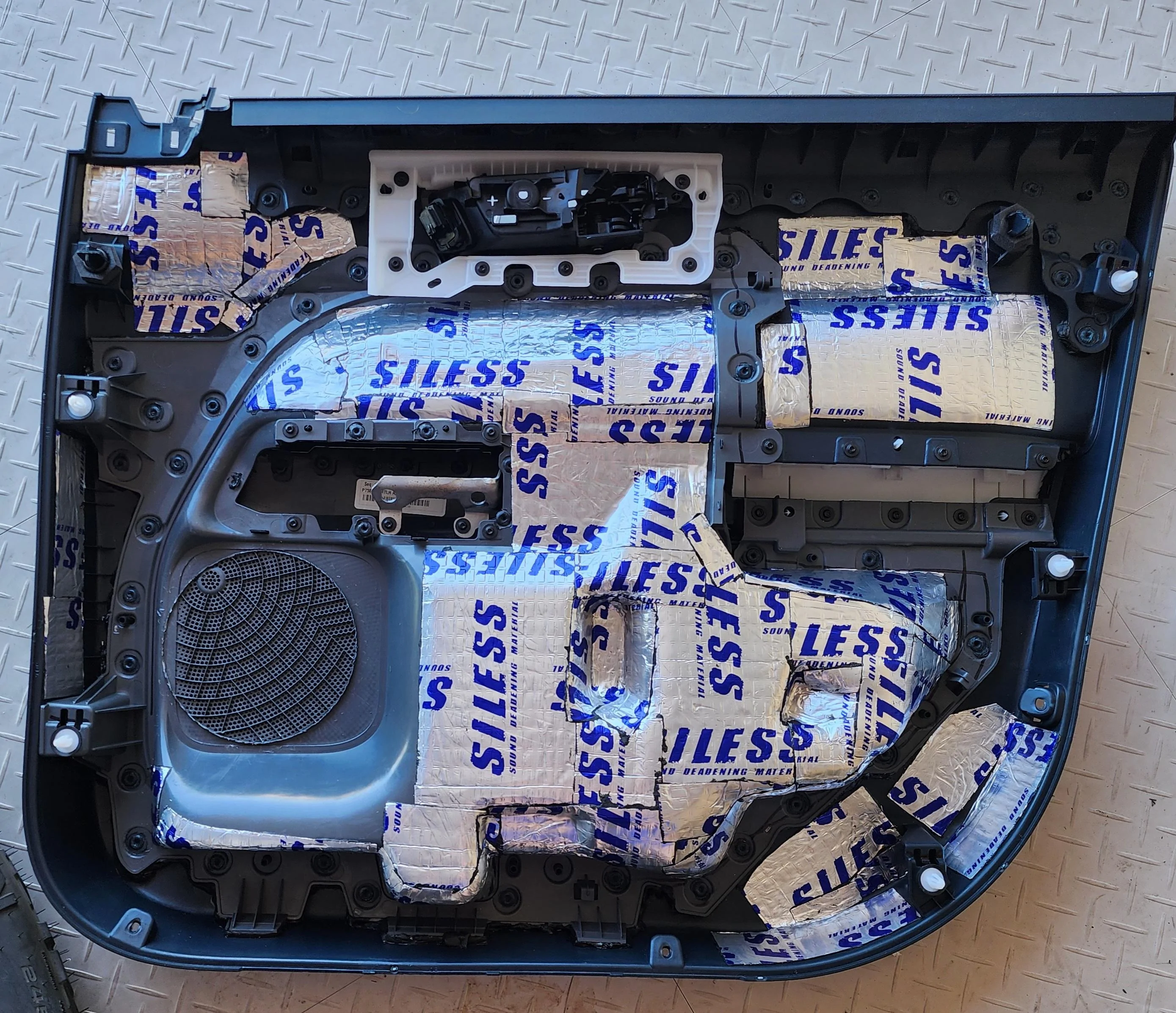

Embracing the process. I think I'm beginning to enjoy it? Still working on the driver door. After I get more complete coverage on all panels with the aluminum mat, I'll be using more closed cell foam on top.

Looking in a pro over there. Keep up the good work! It will get done slow and steady is the key.
