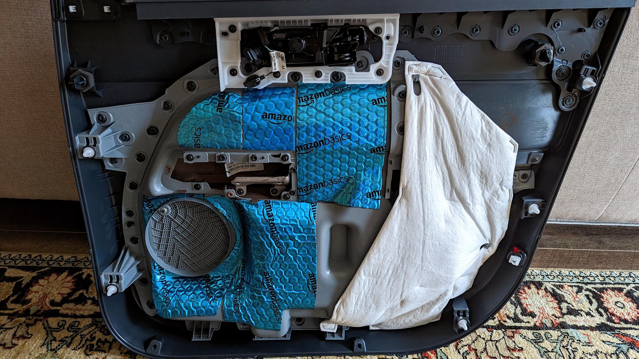

Do this at a minimum. I'm considering getting back in there and adding another layer. If you don't have the factory cloth damper, definitely add some in that location as well.
This is Amazon basics. I would do a second layer with another product like killmat or siless.
I also added O rings to the little white inserts to keep them from rattling.
