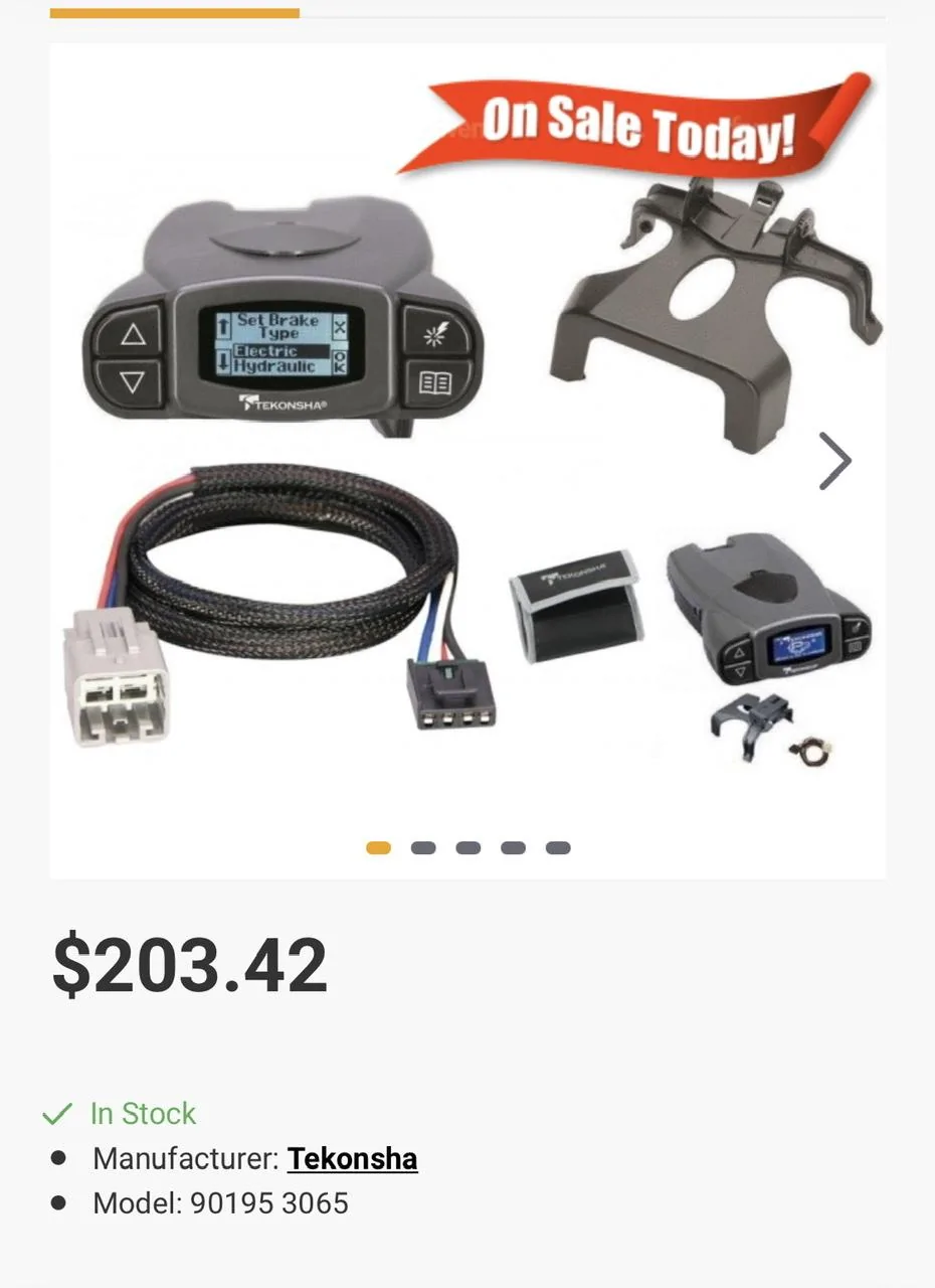

Tekonsha P3 is what I use.
Have had it since 2008 and I've used it in several vehicles. Has quick connect plugs.
I like having visual indication it is working and it's programmable. There are others.
Ford Maverick Need towing advice DEFFA14A-FC55-4E3D-8F21-C00B7CE420C2
You won't have a "port" to connect to, so just get a wire "pigtail" and run your own power.
Quick connect to the unit, then just 4 wires to run:
1:Ground
2:12v continuous or tied to Accessory
3:Brake power output to brakes
4:Brake Pedal signal or high mount third brake light signal.
