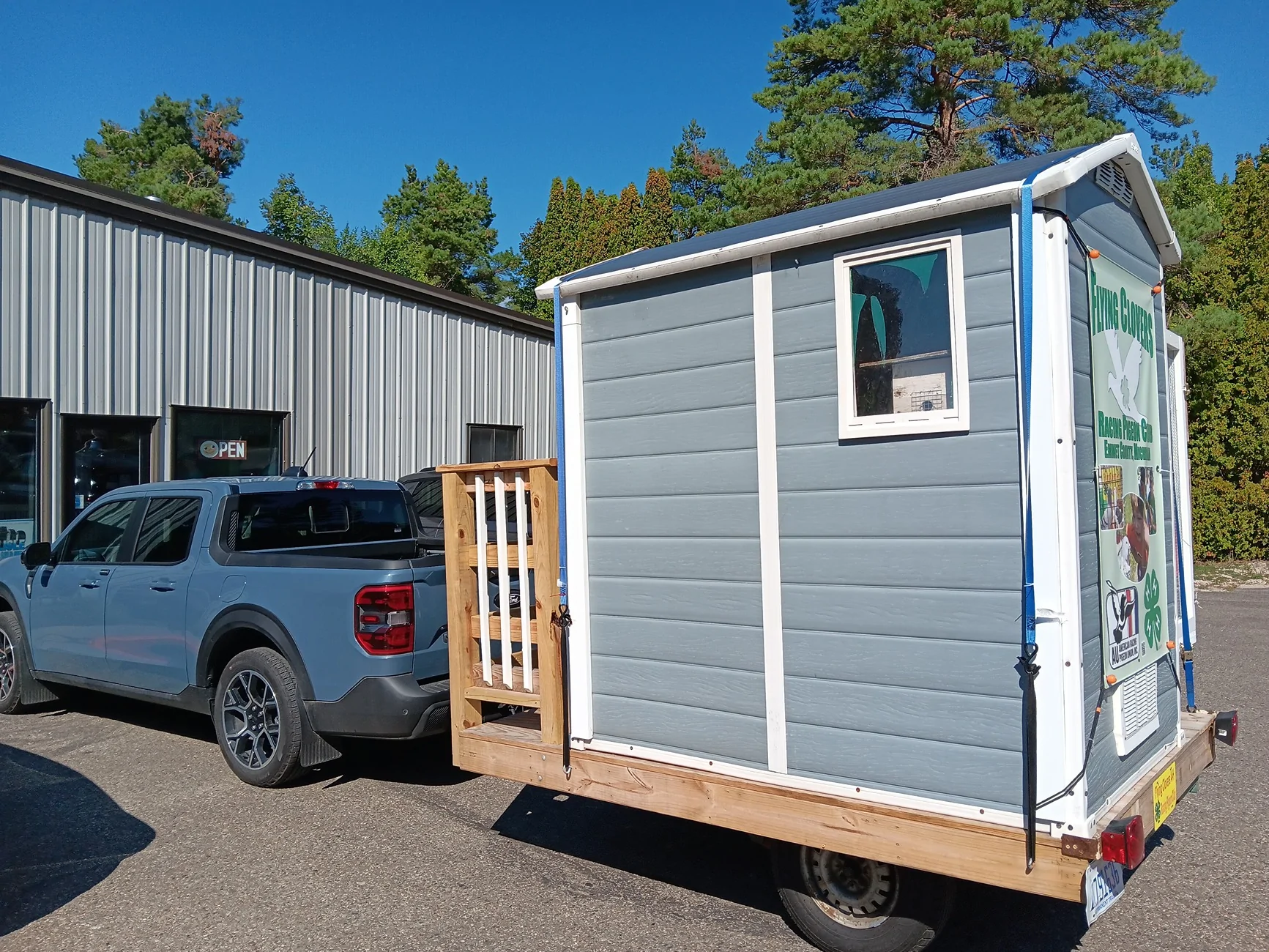

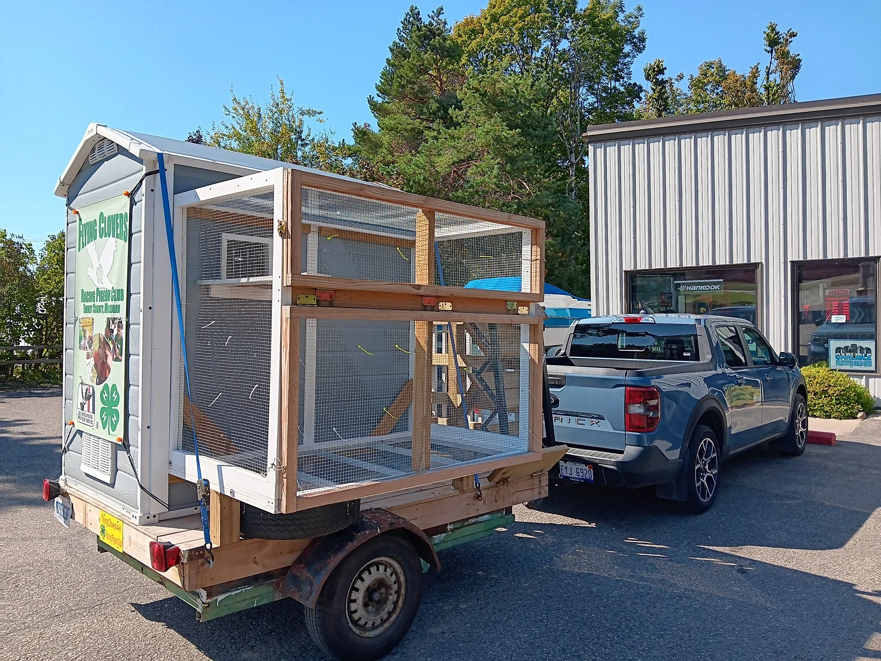

Hey All, I'll be pulling our 4-H's traveling pigeon loft from Northern Michigan to a Western suburb in Chicago. There is an AU (American Racing Pigeon Union) national convention there. The loft and trailer weigh 1040 lbs. (Commercial scale). I do not plan on any passengers or extra weight in my vehicles. My Maverick is a 2025 hybrid with the towing package. I plan on driving 55-65 mph. Here are some other facts to consider:
1. If I tow this loft in the trailer mode, I get about 16 mpg. (It seems that the electric motor never kicks in). If I tow in the regular normal mode, I get about 23 mpg. (Electric kicks in occasionally)
2. I also have a 2015 F150 which I get about 14 mpg with this tow.
3. No pigeons will be traveling in the vehicle or trailer.
4. What would be your advice??? My thoughts are to tow with the Maverick in Normal mode. What I'm I forgetting? Is this a "no brainer".

I would seriously upgrade your straps and their attachment points. Plan for the worst, hope for the best. Passing semi trucks can create a wind/vacuum effect. An unexpected road hazard to swerve to avoid will strain the marginal straps and anchor points. Imagine the coop coming off the trailer in front of tailgating traffic at highway speeds. Better safe than sorry (and sued for negligence)
Your totally right. I will definitely add additional straps and attachment points. Thank You.

Not additional straps, only use proper load rated straps. I'd also be concerned about the hold downs on the trailer. Are they lag bolts or through bolts passing through both pieces of lumber and do they have proper washers?
Also add me to the vote to use the F150. Too many chances to have the tail wagging the dog to leave the better option sitting at home for a couple MPG difference giving up the safety factor.
