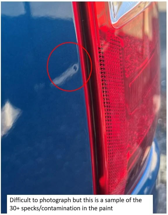

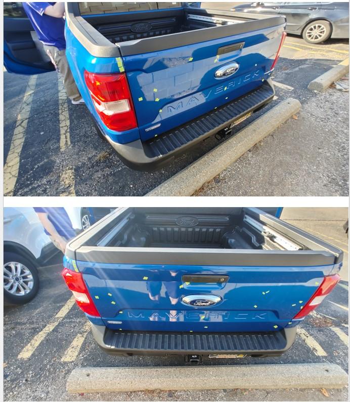

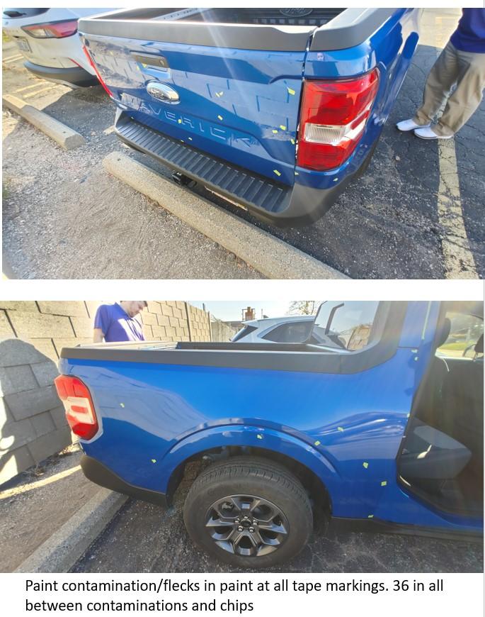

We found contimination in the paint that resulted in either a small pit or specks on 36+ spots between the right rear fender and the tailgate. I am sure a trained eye -body shop expert would probably find more.
Some of these spots, were chips in the paint. The rear passenger door frame shows rough overspray from where they masked it. The paint finish is much different from the factory paint with way more "orange peel".

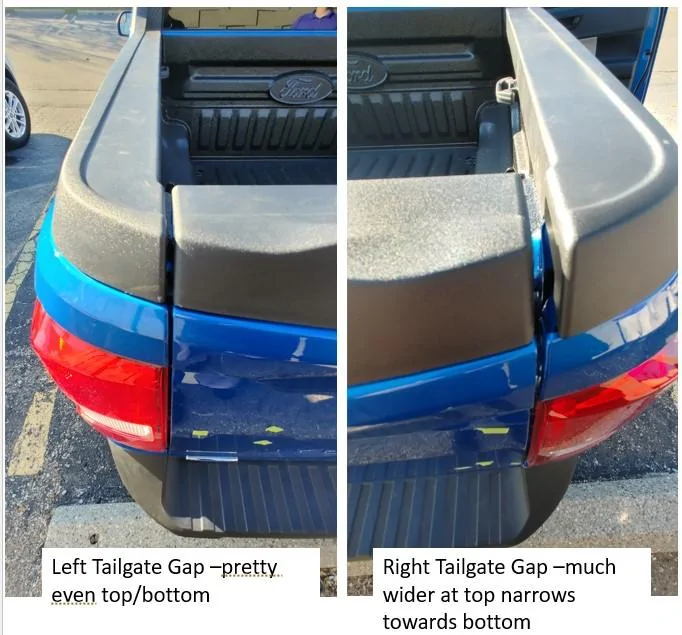

To add, there is a huge gap between the new fender and tailgate. Wonder if a tonneau cover will even fit properly with the gap? There is also a larger gap towards the front of the fender where it meets the rear window and passenger door. Quite a bit of difference compared to the other side. The plastic trim on top of the fender even seems off as it doesn't properly cap the top of the fender at the tailgate.
The fender does not sit flush at either the tailgate or the passenger door section of the cab. It's definitely noticeable relative to the other side.
I told the manager that the fender was not properly aligned -in fact, looking at the fender bolt inside the door frame, you can see that it sits about an inch lower than the original fender. I know they can be adjusted for sure to account for manufacturing deviations but all of this seems ridiculously poor and shoddy workmanship.
I told him they need to re-spray the fender and tailgate. He said "oh - we won't have to do that -we can just wet sand and buff to contaminants and re-spray those areas". Really? It is literally one end of the fender to the other - same with the tailgate.
In terms of the panel gaps I mentioned that it should be within a few MM - he said "well spec is up to 1/4"" but the gap at the front of the fender where it lines up with the cab is only about a 1/4" to begin with... No way the tolerance can be up to 2x the original space...

One other Q: How do I know if they've applied enough clear coat? Can I even tell? From my finger feel running across the panel, it doesn't quite seem as smooth at the original paint.
I also noticed a ton of very light scratches in the new paint. Could it be that they didn't properly buff the clear coat or they used too abrasive of a buffing wheel?

A good technician can buff the paint. I have seen the work performing in front of me. The technician use sand and some kind of compound. For your case, there are so many too buff. Unfortunately, repaint may not work if the same technician will be performing the job using the same paint and equipment.

Really hard to tell from your pictures, but the first picture looks like a "fish eye". It's caused by water or oil, likely from the air compressor powering the paint gun, contaminating the paint. Not an uncommon issue and can sometimes be an easy fix. Given the high number of defects you're noticing, I'd guess either dirt nibs or more fish eyes. They're usually items that can be taken care of with a good wetland and buff. The auto body industry is an extremely imperfect industry, but some shops are better than others.

As a former finish detailer and now avid at home detailer I would not stand for this one bit. If the insurance company agrees and wants it fixed but the dealer refuses, I would take it to a professional body shop, get an estimate and then get the insurance to approve it. Once approved have it done right and let the insurance company worry about who pays for it, they will go after the dealer.

It's really hard to tell with pictures but I would say their filtration system for their air compressor and spray equipment is either missing or just sucks as is the air filtration in their paint booth assuming they even use a paint booth. You might actually be surprised at what they can clean up with some wet sanding and polishing.
It certainly looks like you're passenger bedside isn't square and that plastic bed cap is certainly not installed correctly.
