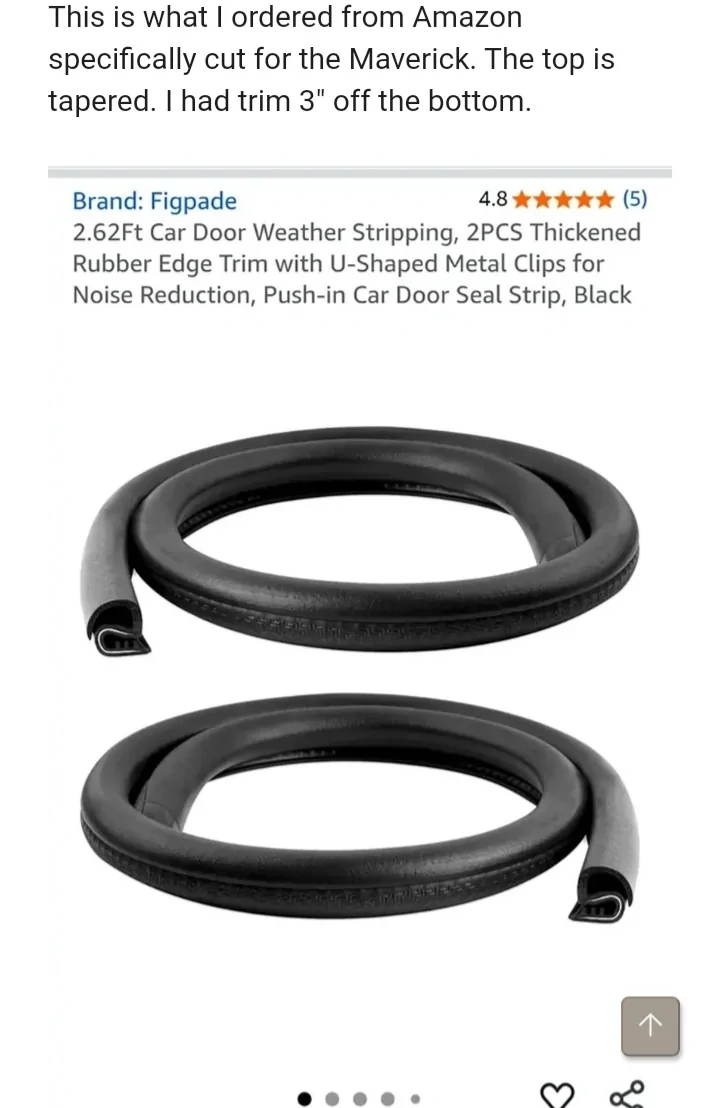

Tim @Pingme67
It installs on the front edge of the rear passenger doors.
This is what I ordered from Amazon specifically cut for the Maverick. The top is tapered. I had trim 3" off the bottom.
It's called a Margin Seal. Many high end vehicles have a small section seal around the doors, but they are designed in up front.
This is pretty brilliant. I commend your ingenuity, but be aware that this could affect your Door Closing Efforts (how hard you need to slam your Door to get it latched). Each vehicle can be unique depending on how the Door adjustment/fits to that particular unit BIW. You may have just got lucky if you aren't having issues, depending on the size and softness of the seal.
You can adjust the Door attachments to the Hinges a little if needed, but this is a bit of an advanced level shade tree mechanic task. Maybe a bridge too far. You can end up defeating the purpose if you adjust it too far out, you can increase the seal gap to the primary Door Seals and make a big mess, never get it back to the way it was, so I don't recommend it.

Oh, I don't think luck has anything to do with it. I'm pretty confident in saying, most Maverick door gaps are probably the same. There might be a few that have adjustment issues.
It's pretty much designed to do what it does. I'm not the only one on the forum who has installed it. I haven't heard of any problems so far.
It gives a nice tight seal.
And the door has no problem closing.
