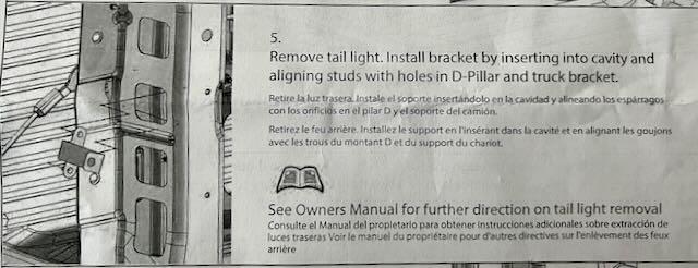

Step 5. instructs you to remove the tail light.

Ford Maverick Installing Swing-Out Tool/Storage Box IMG_0547
Was doing fine till I got to the "Then carefully pull the lamp assembly from the tailgate pillar by releasing the two retaining tabs."
Neither of the illustrations show the tabs, or indicate where they might be located. Lamp assembly only pulls away from the tailgate pillar about 3/4" max. Looked but cannot see anything to release, but assembly cannot be removed until something is released.
Don't want to damage the assembly or mar my paint poking and probing trying to get it out.
Anyone done this, or know where I can find more details, preferably with photos.
