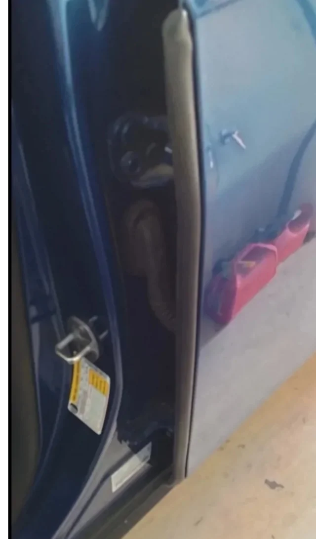

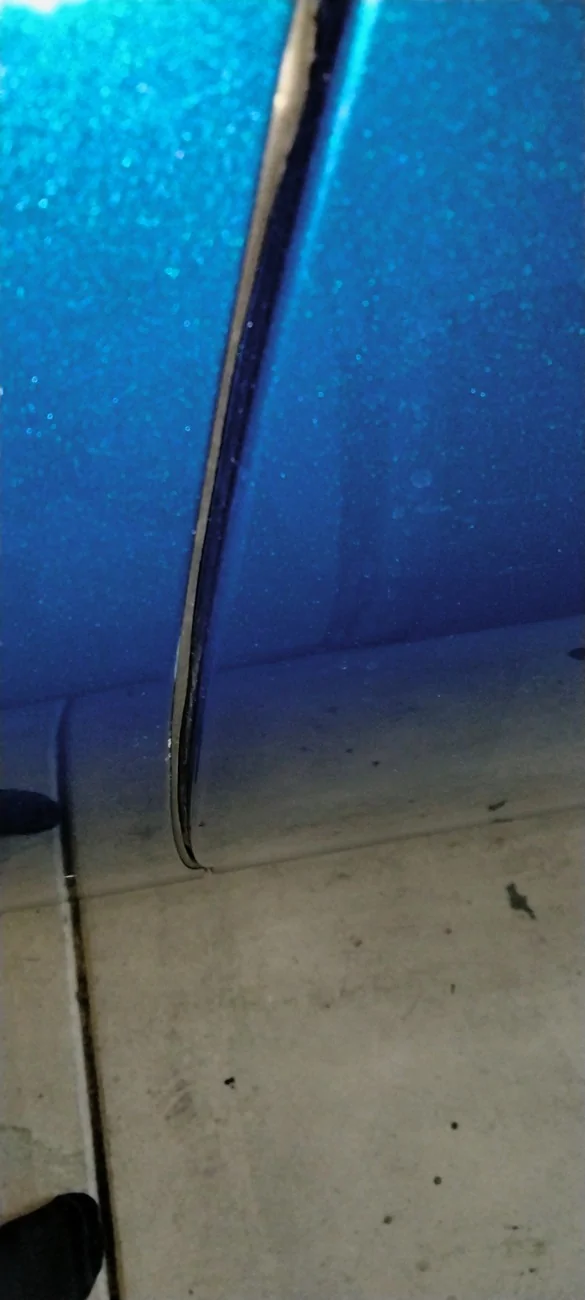

The only thing I hear wind leaking by the doors
Guess that is the good thing about hearing loss from living on an aircraft carrier for 4+ years. Ha Ha 26 hybrid lariat
Tim @Pingme67
It installs on the front edge of the rear passenger doors.
This is what I ordered from Amazon specifically cut for the Maverick. The top is tapered. I had trim 3" off the bottom.
It's hard to see but it makes a nice seal.
