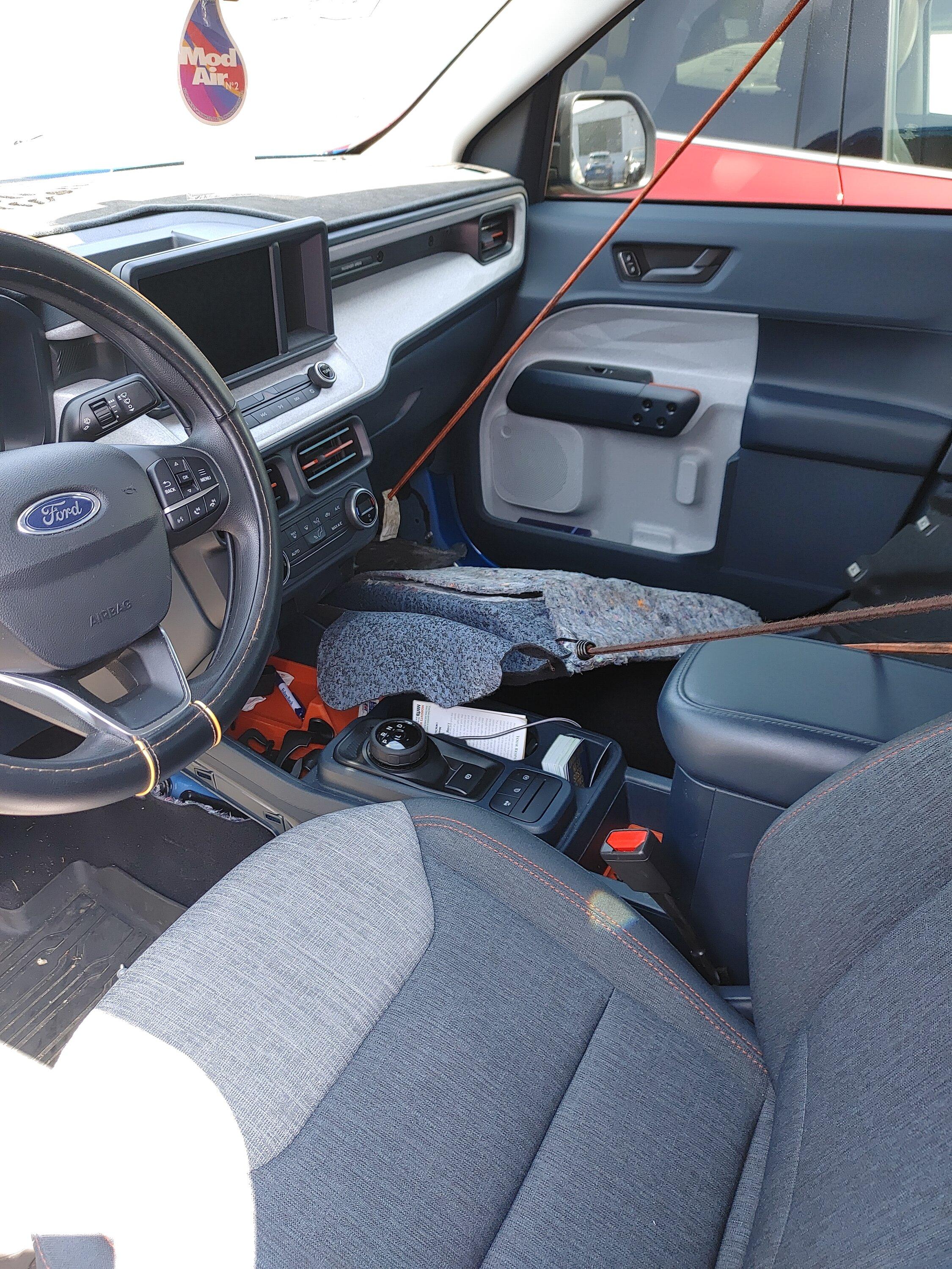

Ford Maverick My Maverick is Getting Wet 1722385059115-sv
Ford Maverick My Maverick is Getting Wet 1722385166296-3n
Ford Maverick My Maverick is Getting Wet 1722386781507-y0
Furthest right mayonnaise looking sealant seemed to be the fix (not sure). The staining from water flowing is where that wire harness enters or exits the firewall. They also had the cowl apart, most probable area for the leak.
Good luck! Ford wouldn't cover my floor mats (rubber and carpeted) even though they were ruined due to the stink. Mine is better with new carpets and jute, but that putrid smell is in the seats, headliner, etc. I've used sooo much anti stinky stuff, that IT now stinks... I don't want to talk about it any more.
