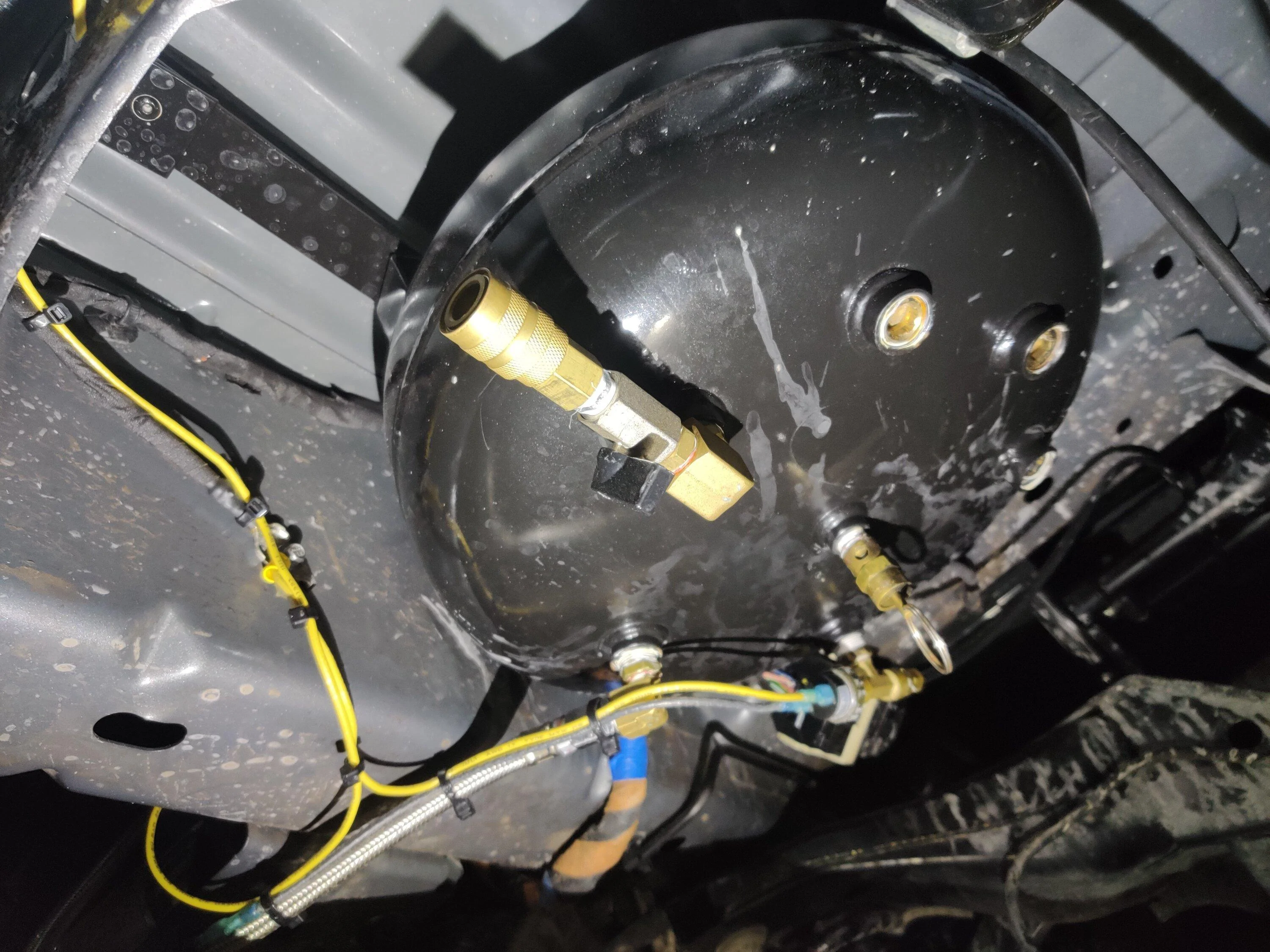

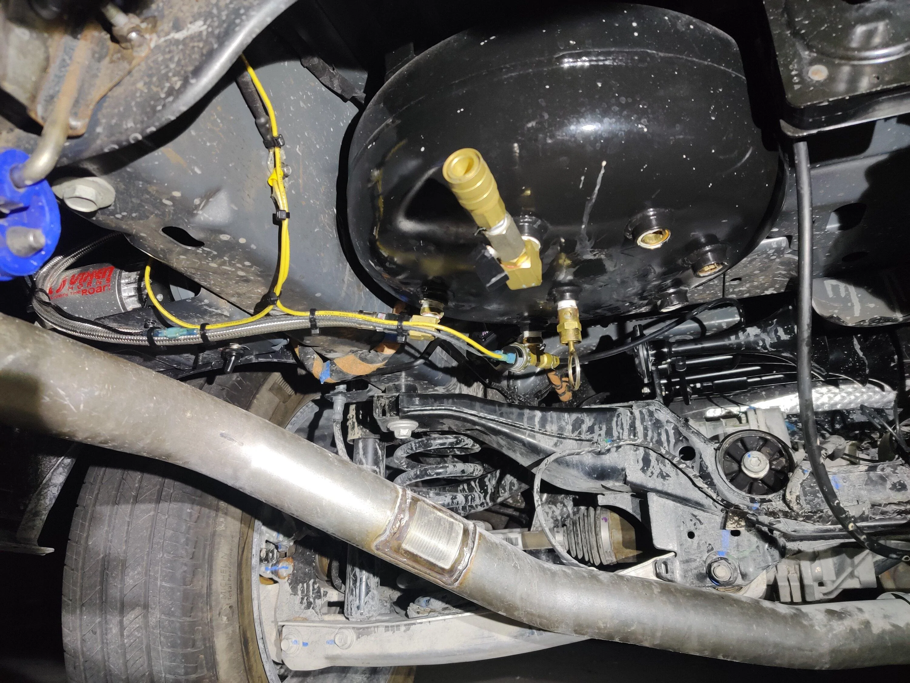

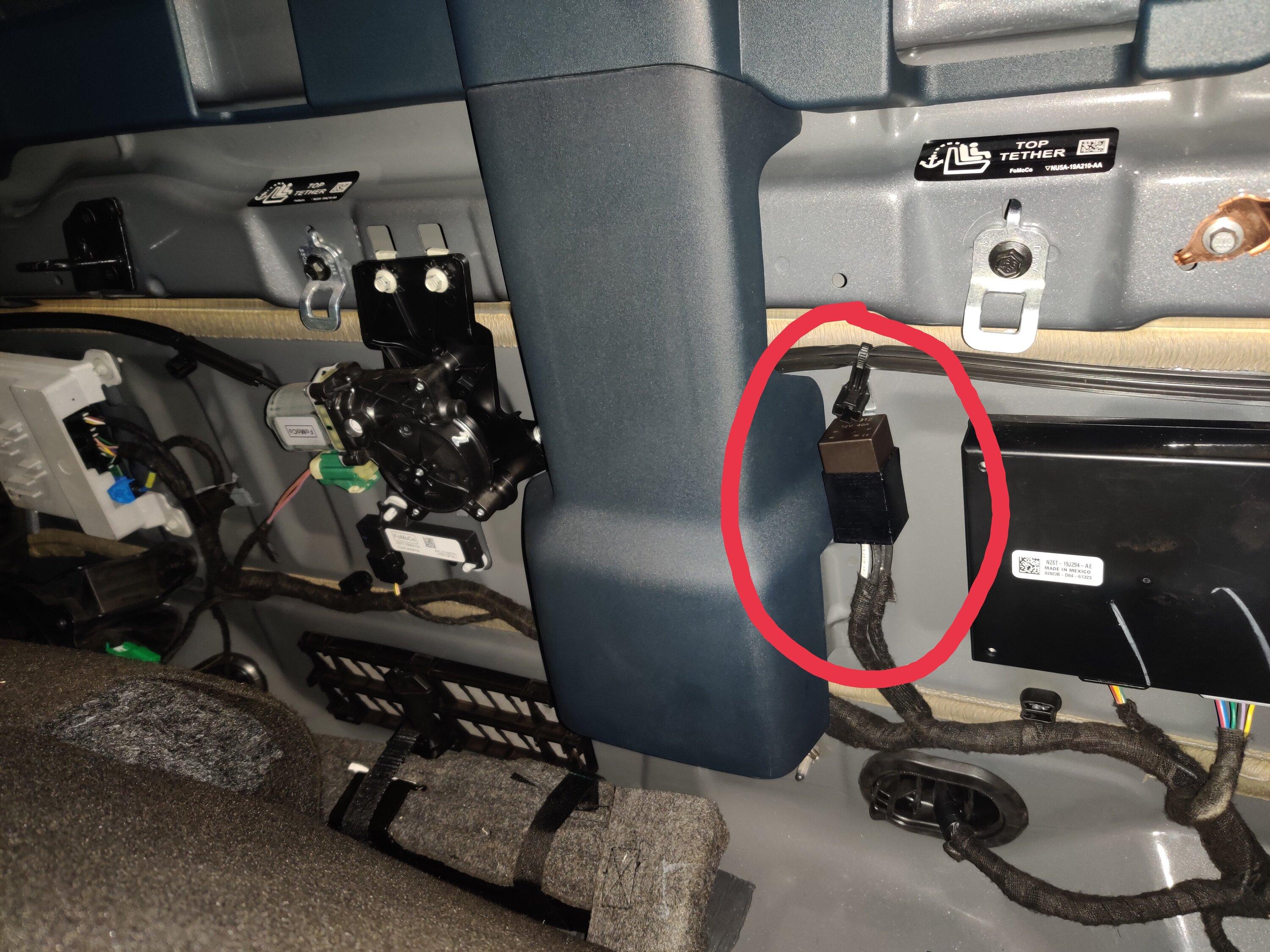

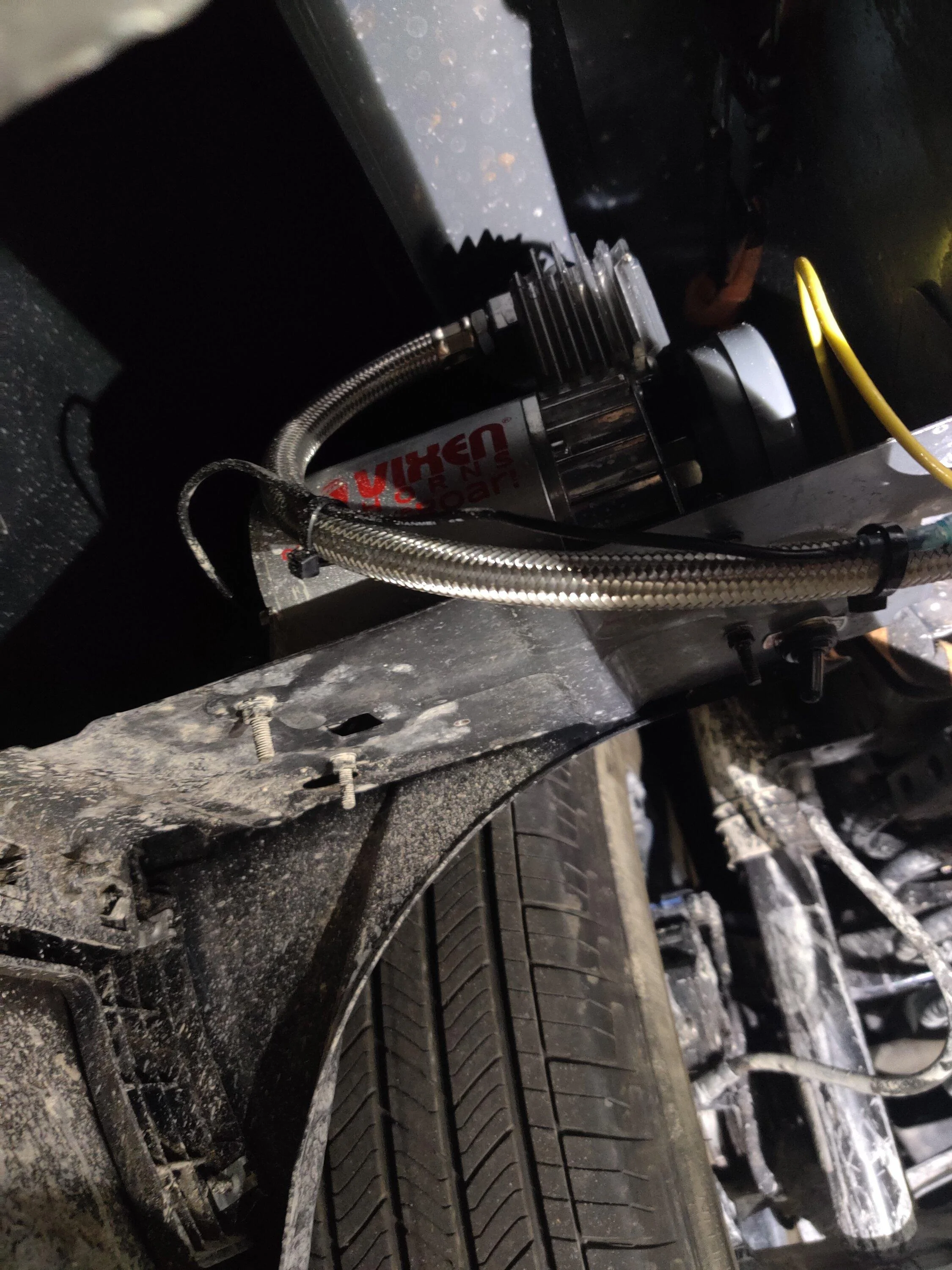

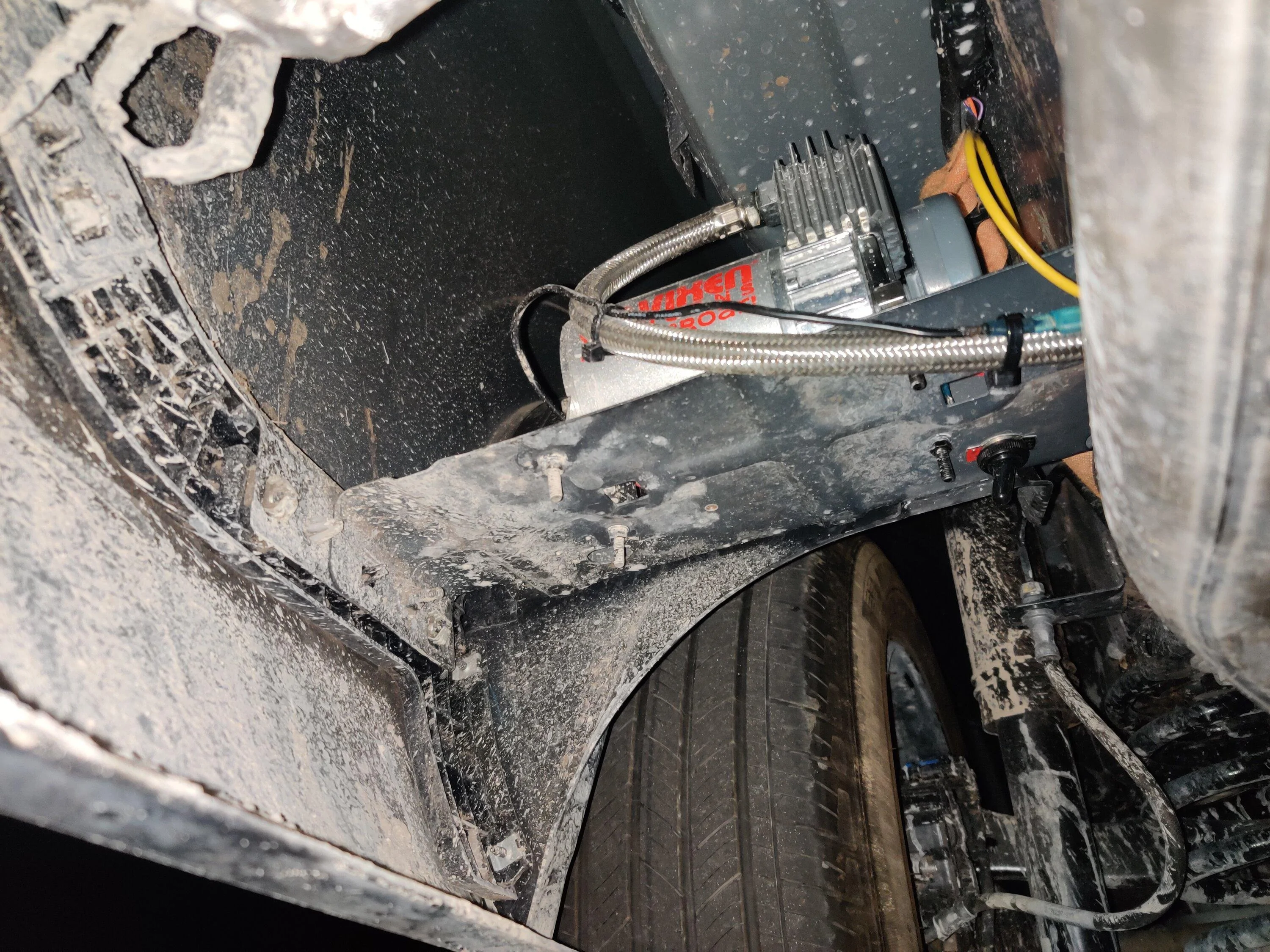

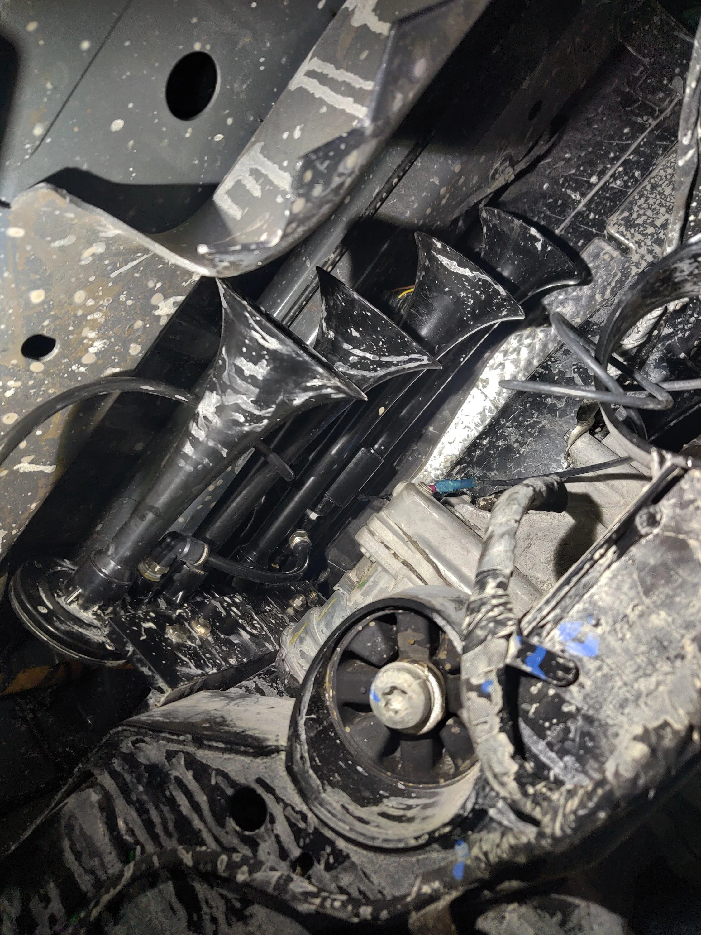

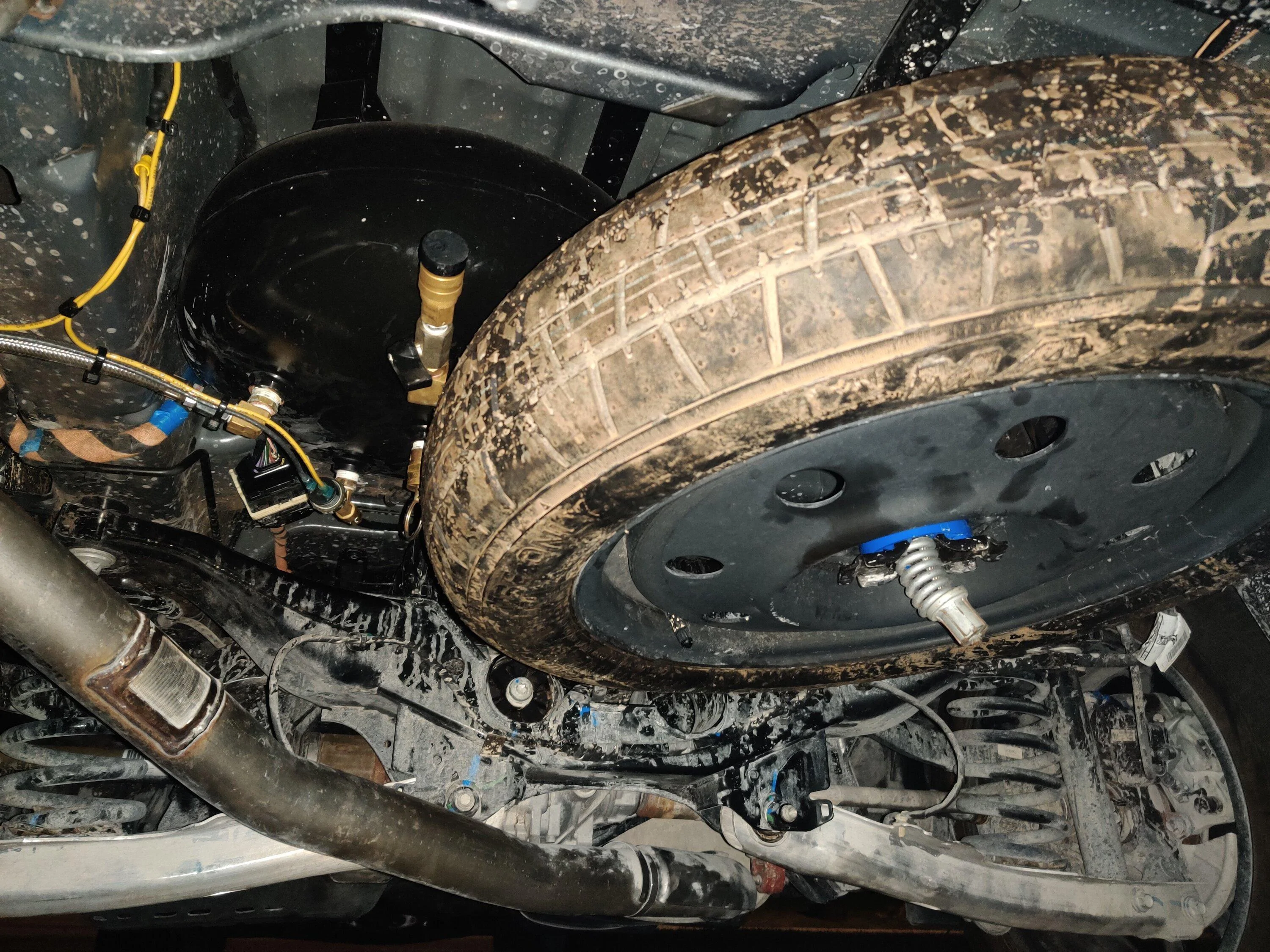

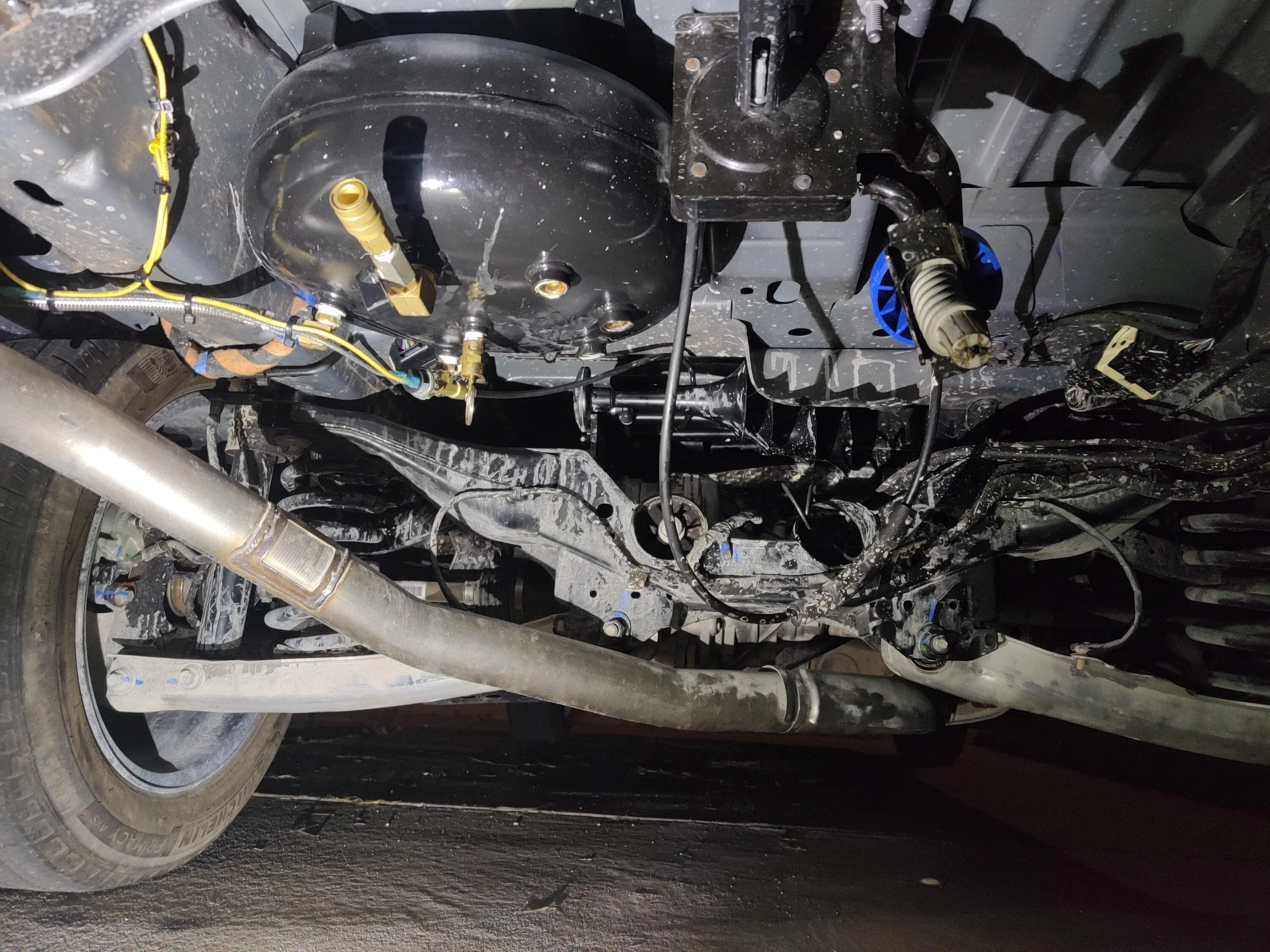

I have spent some time custom fitting this 4 gallon pancake tank to fit under my spare tire with out ruining the ground clearance for when I go off road. Main purpose is a self filling system for the train horns that are mounted above the rear differential with a quick connect on the tank to use for a flat or to air back my spare set of off road rims/tires I have. Tank has a pressure switch with a over pressure blow off. 200psi tank with a 150psi compressor that also have thermal protection from this brutal Florida heat. Power source wired to the trailer power supply with a cut off switch in case I need to tow some thing off the same power. No messy wire all the way up to the battery. Need to put the spare tire back up but it sits right off half the tank

Location was my biggest struggle. Didnt want the tank in the already small bed taking up space, and the horns are exactly small with very limited room in the engine bay. Over the diff was the perfect fitment with out it being a direct blast to a front facing vehicle. Ideally I think cylinder tanks in the quarter panels may have been a better option but i already had this tank from a previous vehicle. All Im saying is of you do it i deffinitly want to see pictures.

Updated the orginal post. Check out the video. Although I will say the video really doesn't do it justice. I had to go to the park avoid pissing off all of my neighbors.
