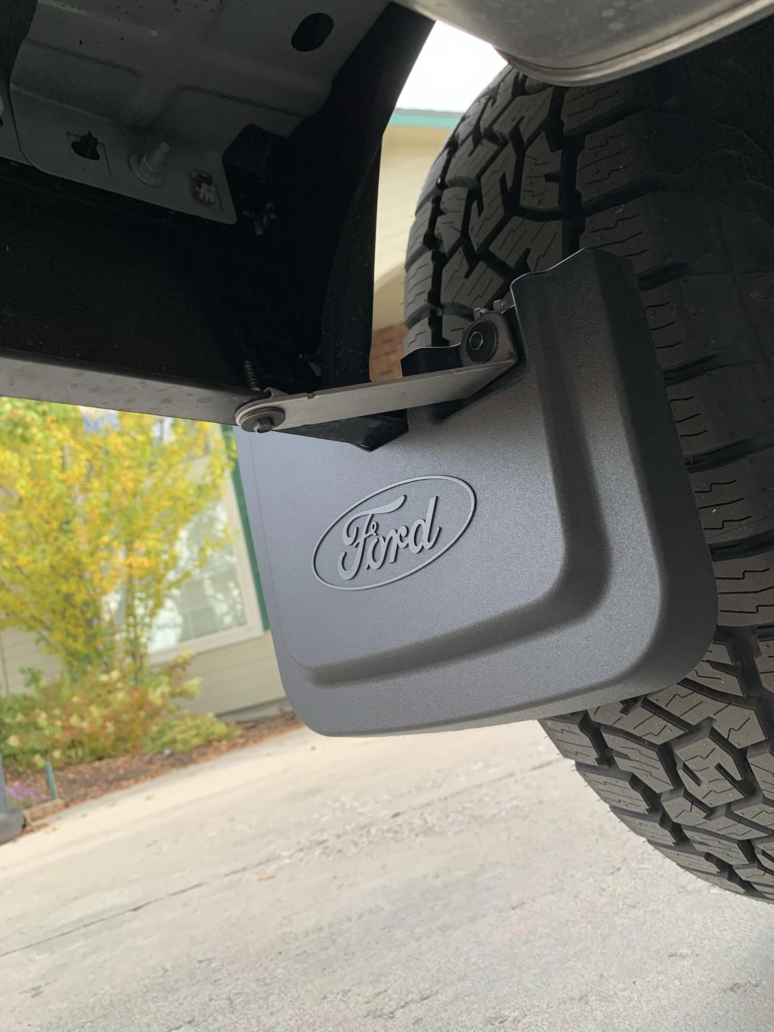

I just installed a factory set of mudflaps on my XLT.The left rear had no where to mount the hardware,just open space by the muffler What did I miss?Anyone have a picture?Thank you.

Should just be the push pins in the wheel well and then you tap a 7mm hole into the bumper for the bracket

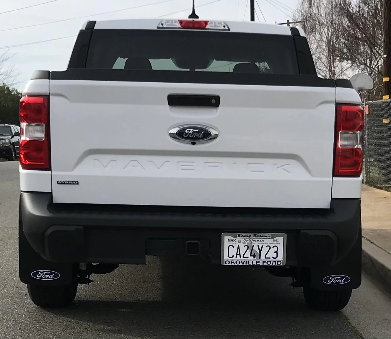

scotwhoo
Scott
Feb 16, 2022
57
62
Pine Grove, CA
Ford Maverick 2022 XLT Hybrid
I got these off Amazon and mounted them this week. $24.99 for the pair.
I used 3 locations already on the fender. Top was plastic push pin replaced by a bolt, two washers and a nut. The too lower 7mm head screws took a little longer screw with washer.
These look great. I bought them, but can't figure out how to install on the back near the exhaust pipe. Any chance you can take a picture of what you did?
