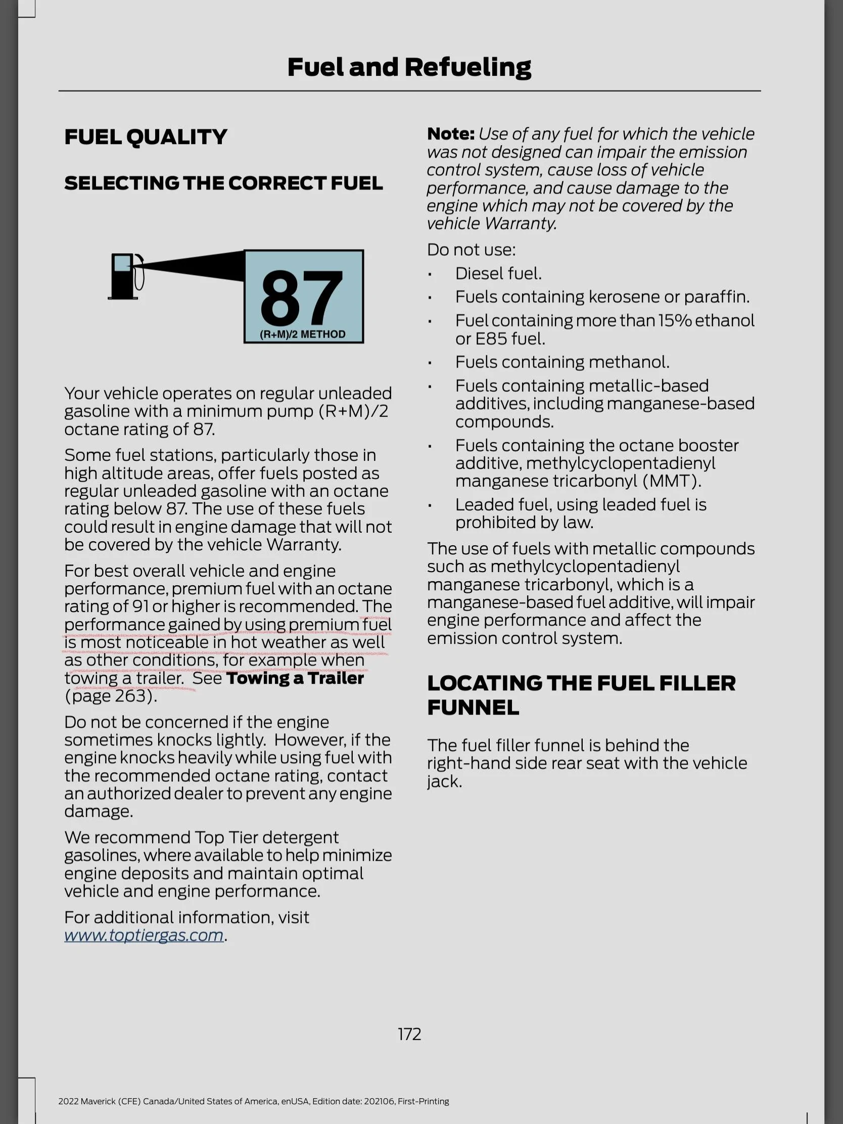

Ford Maverick MPG using different grades of fuel 8C6A85EB-39B6-496F-B910-0F71B4E38205
“The performance gained by using premium fuel is most noticeable in hot weather…..”
OP states they’re from Austin (👍🏻) so they know good BBQ and hot weather.
