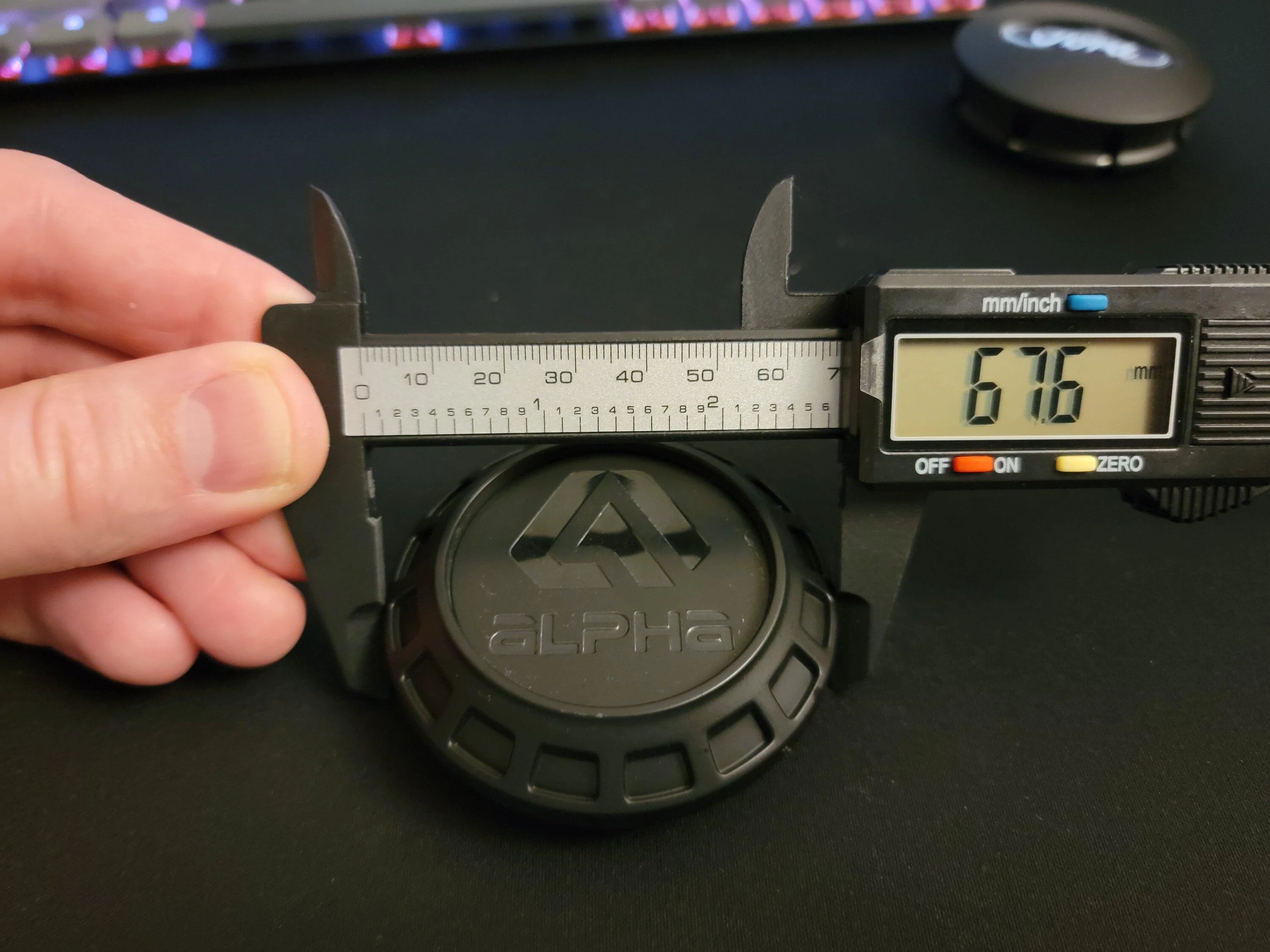

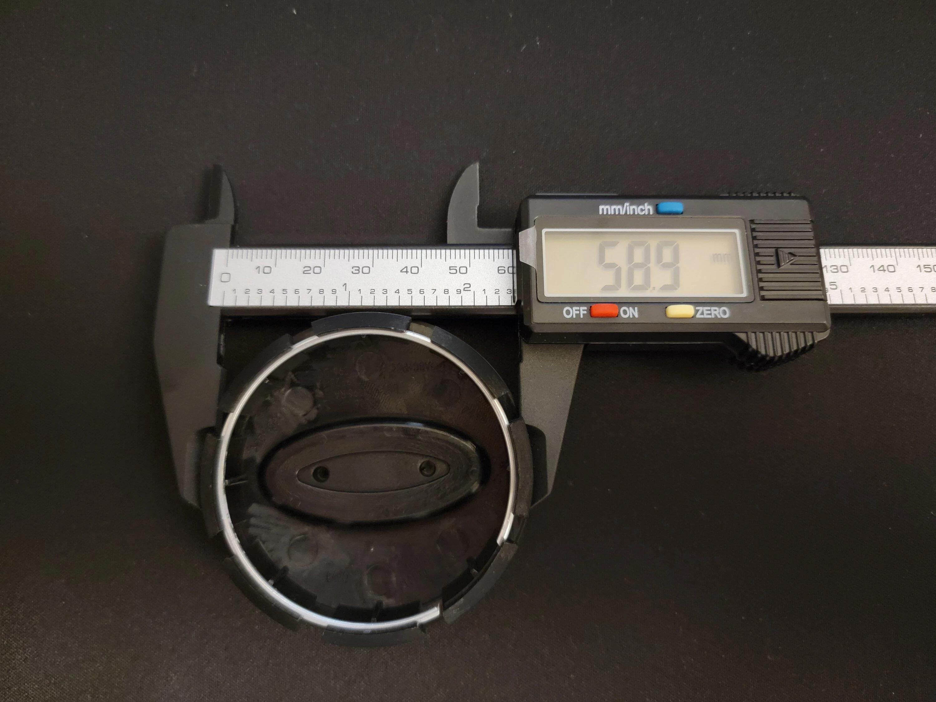

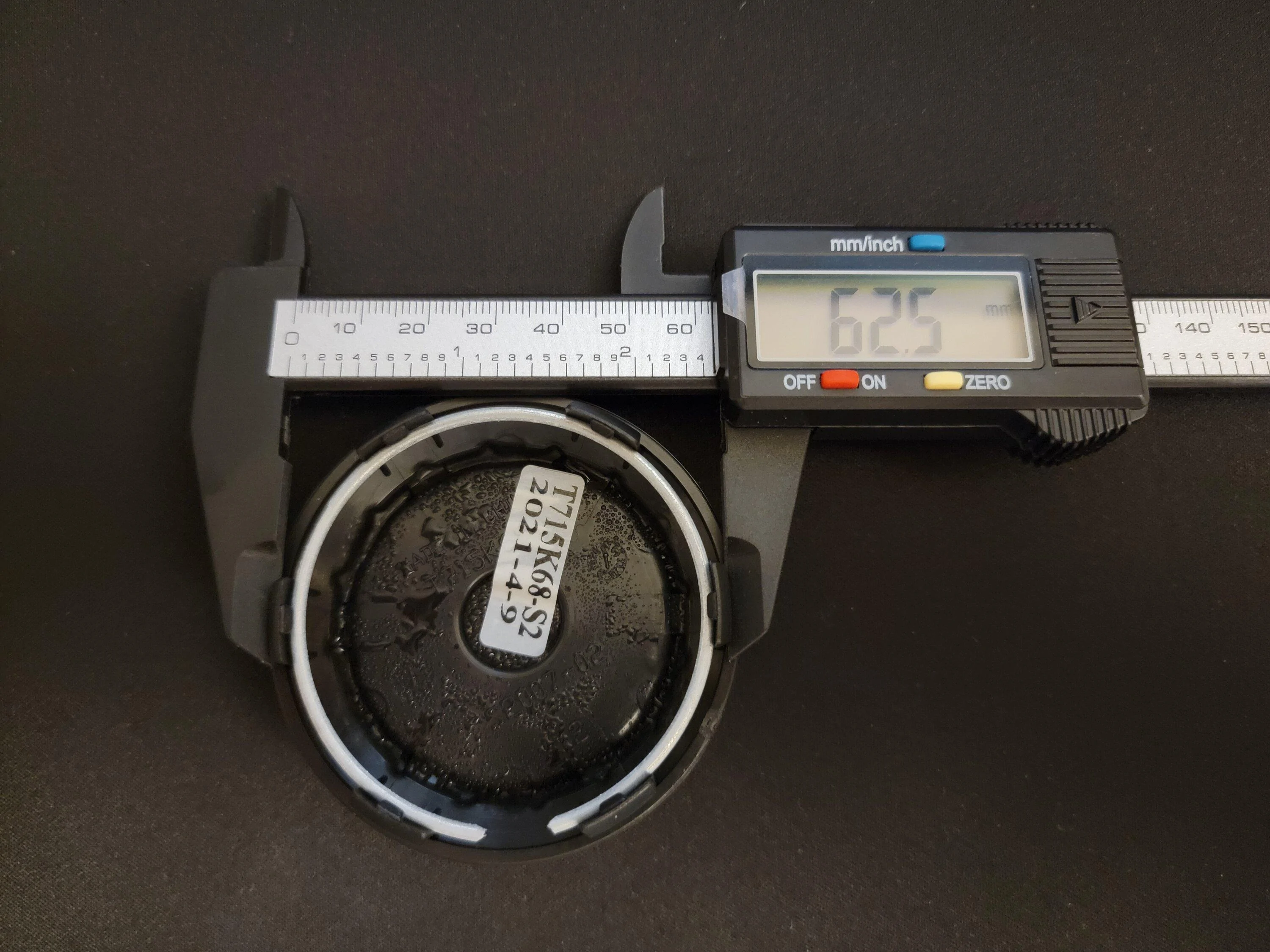

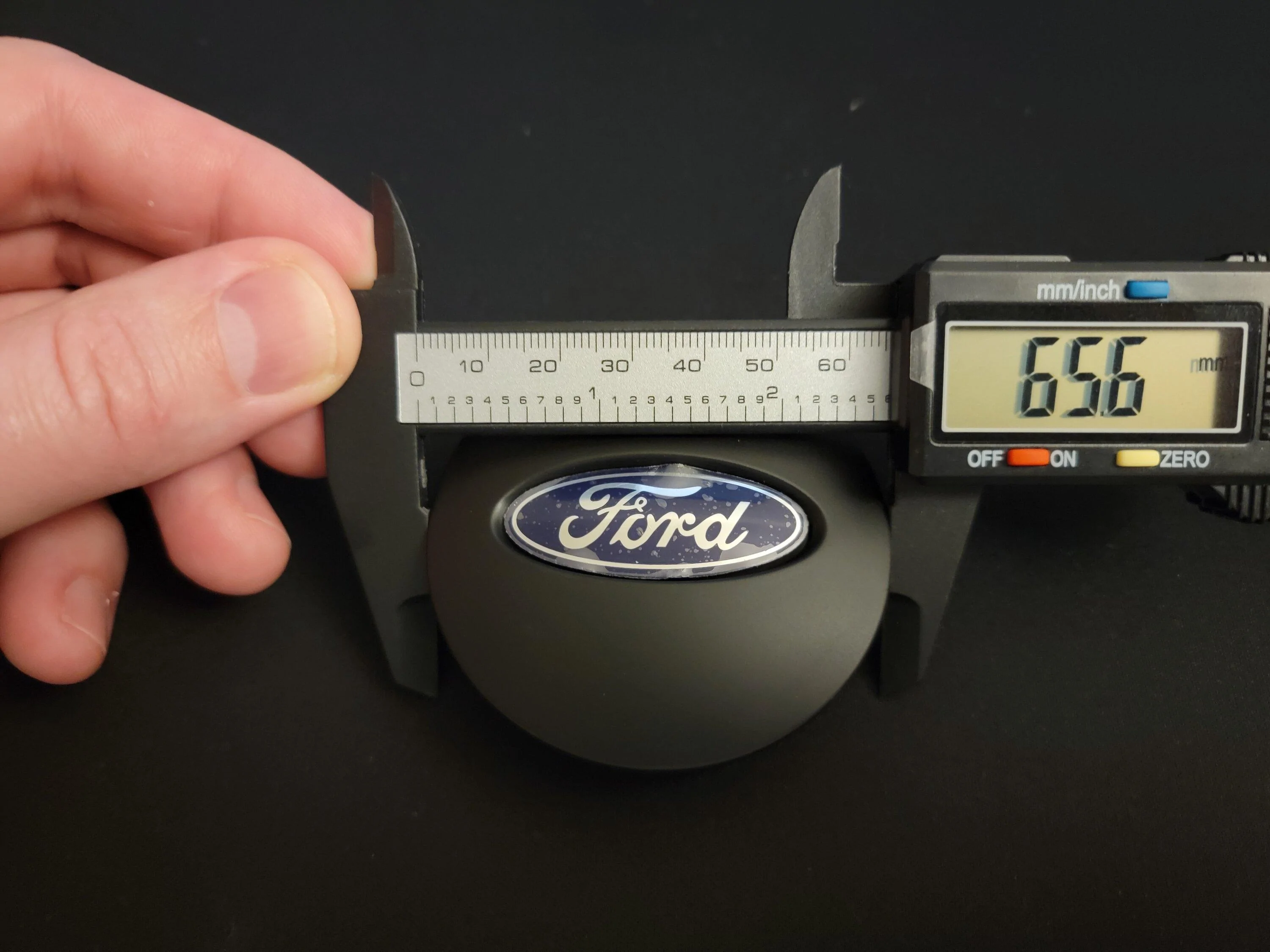

Well, pretty annoying that I ordered the correct size as specified by AlphaEquipt for the hub center caps and they are too small. AE specified with that part number they were 2.5" so I pulled the trigger on the same size for the FORD ones and it looks like I'll need to step it up to a bigger size if I can even find them, and the AE hub center caps have the shortest lip to grab I have ever seen, so still no guarantee. I may just JB Weld if these other ones don't fit.
Grr... it just can't be simple.
I'm curious if anyone has a solution or can find a slightly larger version? Maybe 68mm? They would have to be flat black with the blue oval and all I could find was 66mm. So I'm considering just JB Welding them in place. I suspect the only reason they don't actually work is because the difference in the inner clip size.
*Edit
Took some measurements and it appears that listing on the hub center caps was for 2.5" exterior... of course, I didn't think about it but I need to find some that show the inner diameter instead.
Here are the AlphaEquipt ones:
Ford Maverick Montana's Maverick - '22 Lariat Lux FX4 4K EB 20230718_032628
Ford Maverick Montana's Maverick - '22 Lariat Lux FX4 4K EB 20230718_032654
Here are the ones I ordered:
Ford Maverick Montana's Maverick - '22 Lariat Lux FX4 4K EB 20230718_032447
Ford Maverick Montana's Maverick - '22 Lariat Lux FX4 4K EB 20230718_032524
So at least now I have the measurements I need, which I should have done first. I may just order some inserts to place inside the AE ones if I can't find some matte black ones with the blue oval that show the inner diameter measurements as well as the outers.

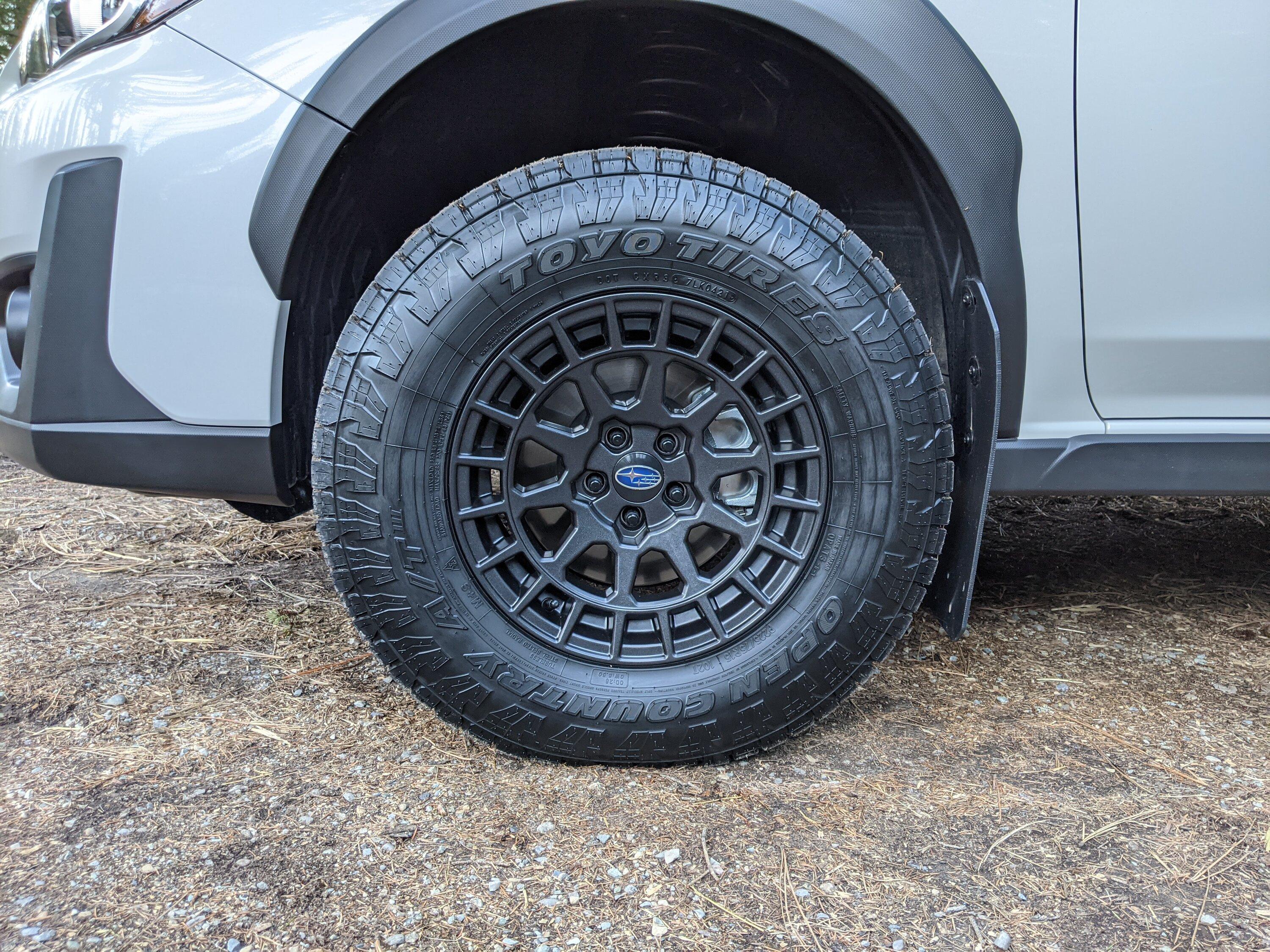

I really want this to happen lol. I did this with my previous Subaru and it looked really good:

Update since my last post:
Unfortunately, I could not make the correct wheel center caps for the AE wheels. Kinda bums me out. I went through the trouble of replacing the lug nuts with a chrome set that is 1.38" long and they fit perfectly. There is 1/4" left, so plenty of thread left. The ones Discount gave me were actually used and stuck out way too much for my liking. I also asked for the chrome ones and they gave me black ones. So, I got a refund from them and got my own for half the price. I can't believe I forgot to bring a set when I was getting my tires/wheels mounted. Discount charged $70 for the $40 set I got off Amazon. They also improperly balanced every single tire. I had to get them rebalanced at the local Les Schwab and thankfully, they did not charge me. This was my first not so great experience with Discount. Not sure what happened but given the fact their tires are about half the cost of anything at Les Schwab and many other places, I'm still going to buy from them in the future.
I was able to find a decal that is similar, but from the pics I've seen they are usually pretty glossy and grey, not so black, and it's due to the coating that goes over the decal.
Ford Maverick Montana's Maverick - '22 Lariat Lux FX4 4K EB Captur
Either way, I plan on making them work. They should fit right inside the AE wheel center caps and I'll just use JB Weld to hold them in place. Really looking forward to the contrast they provide.

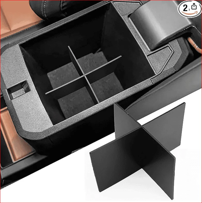

I also got a divider for the bottom of the center console:
Here is the link for that:
Center console divider
