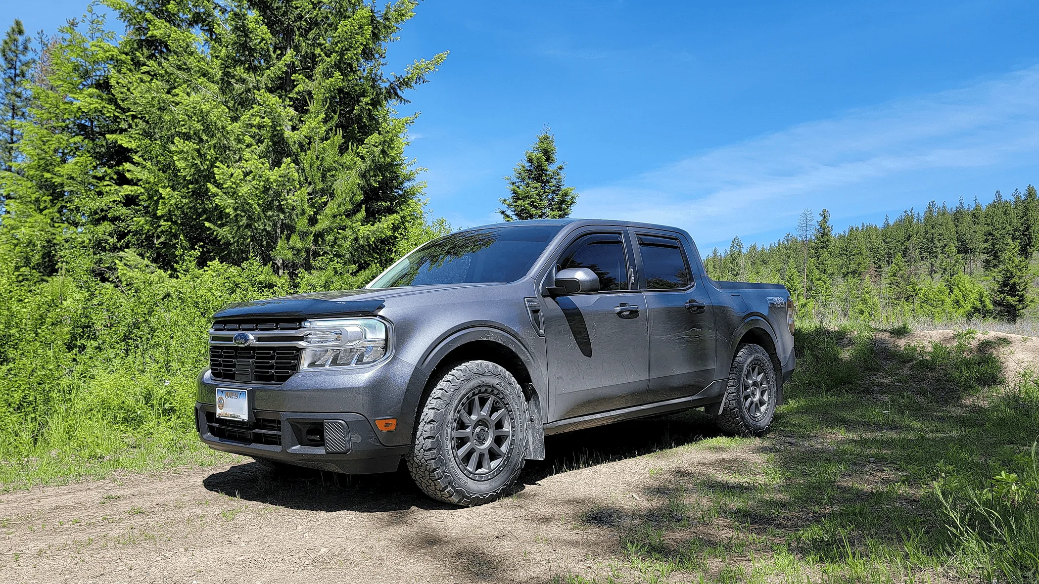

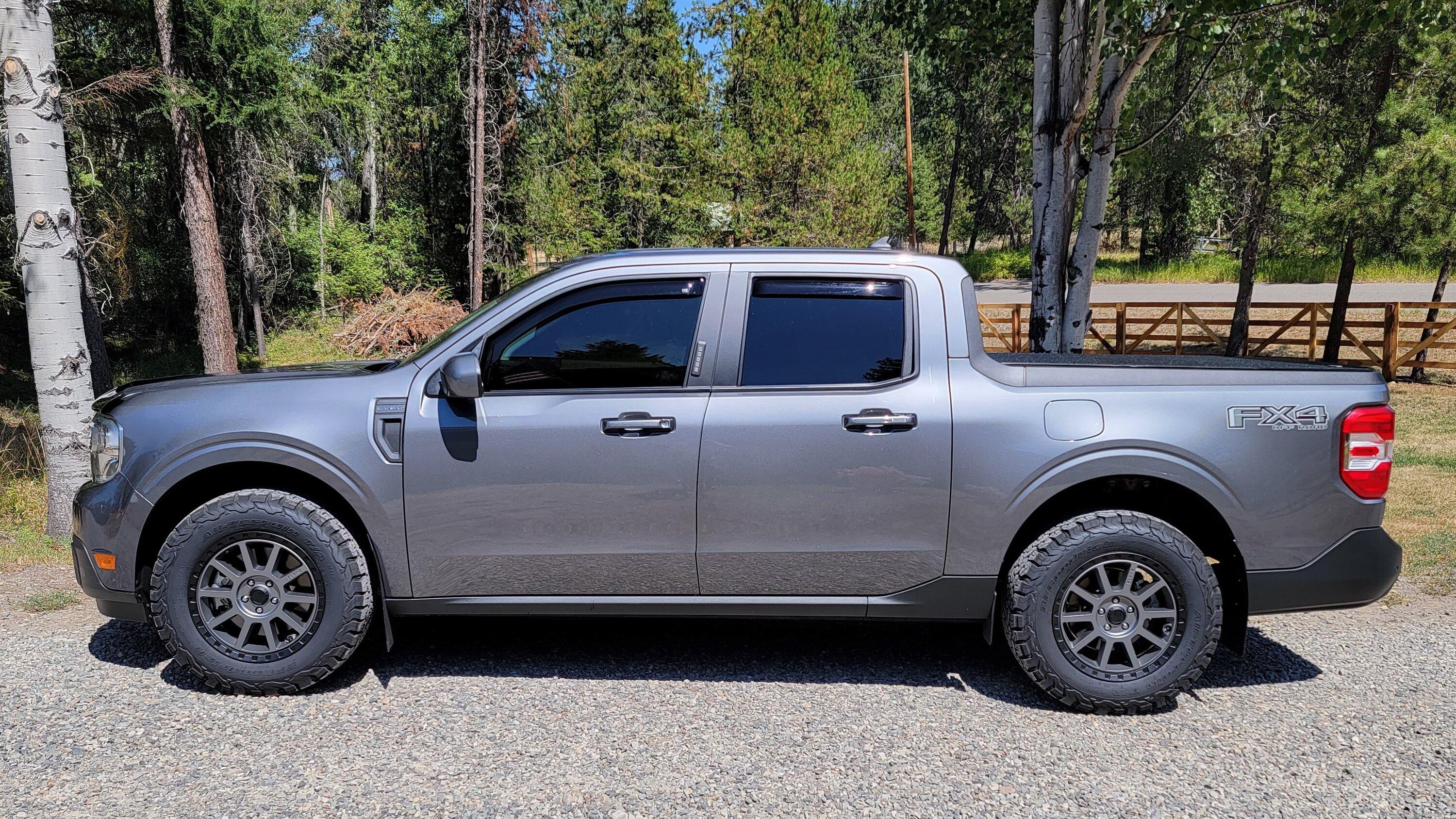

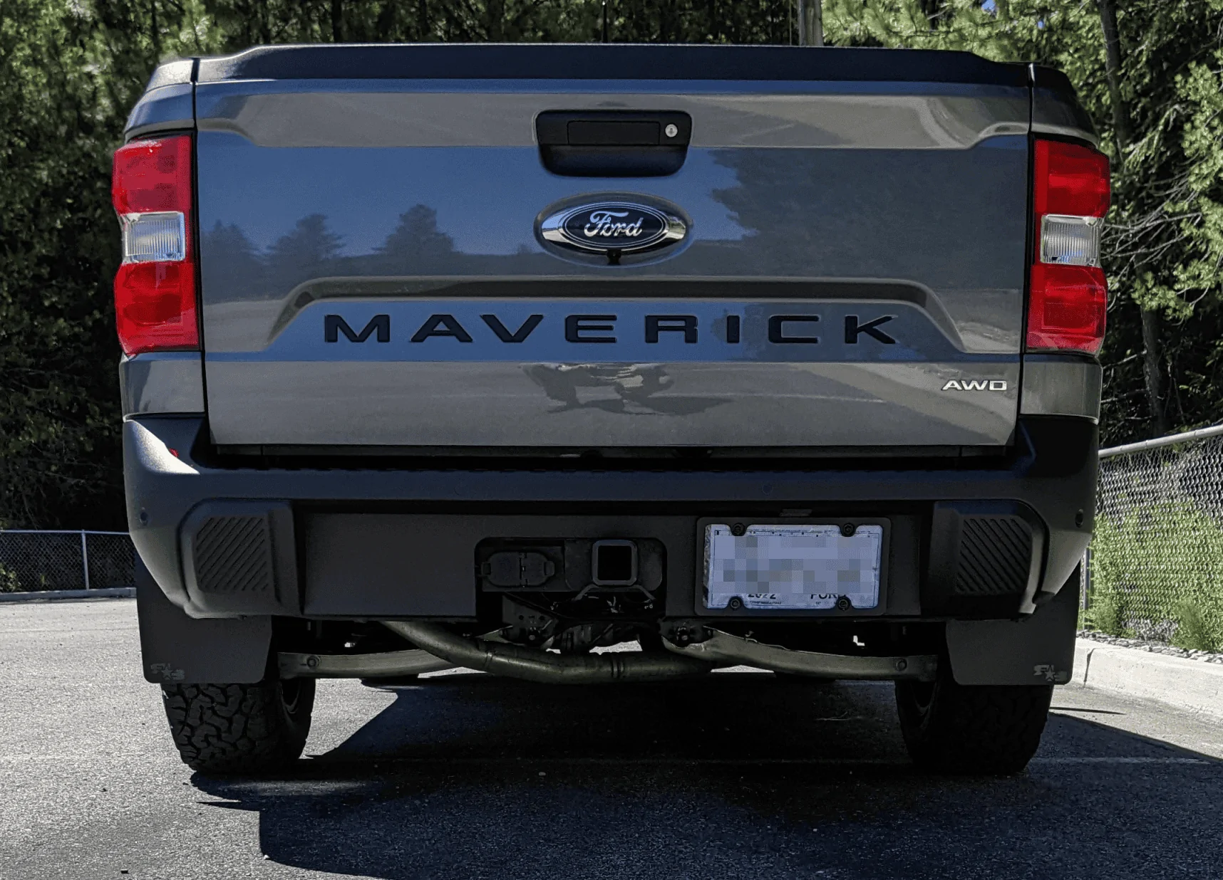

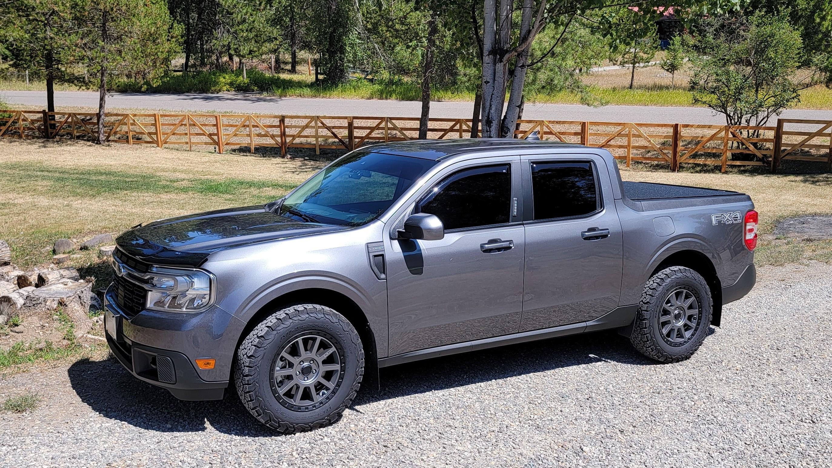

'22 Maverick Lariat Lux FX4 4K Ecoboost
Ford Maverick Montana's Maverick - '22 Lariat Lux FX4 4K EB 012
Ford Maverick Montana's Maverick - '22 Lariat Lux FX4 4K EB 013
Ford Maverick Montana's Maverick - '22 Lariat Lux FX4 4K EB 008
Ford Maverick Montana's Maverick - '22 Lariat Lux FX4 4K EB 009
Ford Maverick Montana's Maverick - '22 Lariat Lux FX4 4K EB 011
Ford Maverick Montana's Maverick - '22 Lariat Lux FX4 4K EB 015
Modifications:

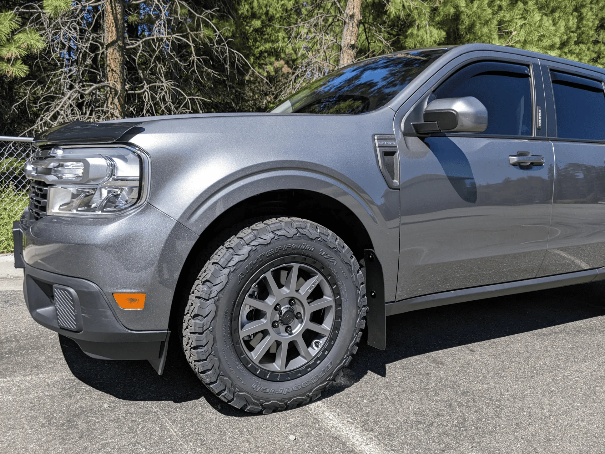

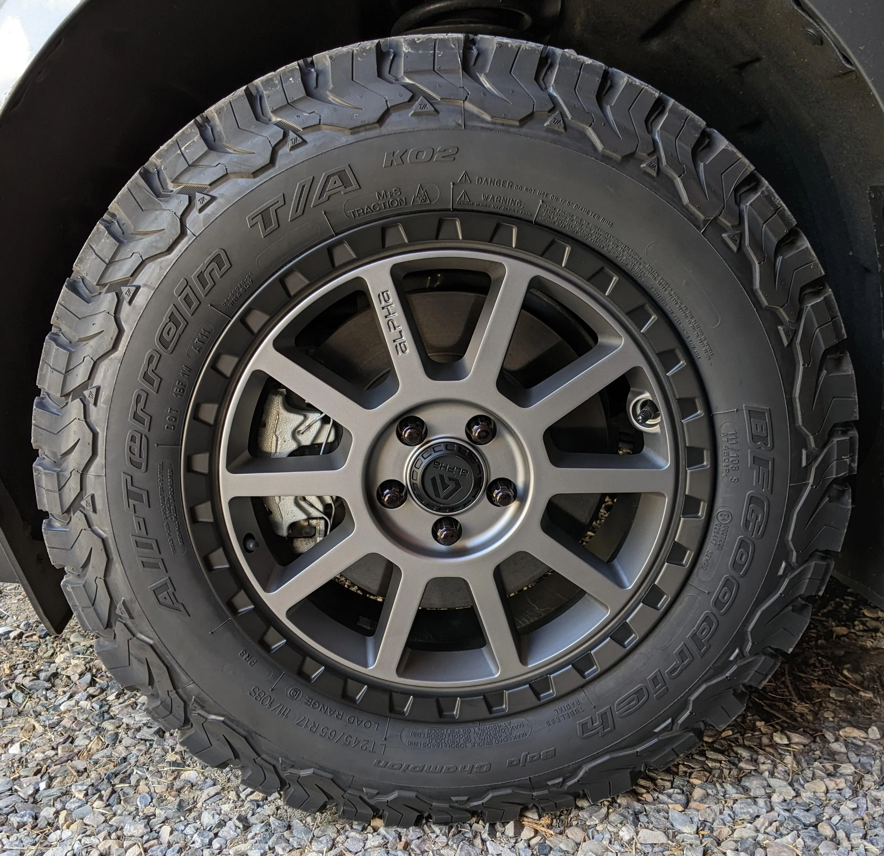

  • 245/65R17 KO2's
  • AlphaEquipt Foxtrot's (17x7.5) (+35 & 27 #'s)
  • AVS Window Deflectors (Smoke - Exterior as of Aug '24)
  • AVS Bugflector II (Smoke)
  • LoMax Tri-Fold Tonneau Cover (Urethane)
  • DeeZee Tailgate Assist
  • RokBlokz
  • TuxMat Floor Liners
  • Stubby JR. Antenna
  • Tint (15% fronts, 5% rears, 5% sunstrip)
  • Viofo A139 Dashcam
  • Removed Wheel Air Dams
  • Double Honk Disabled
  • Tow/Sand Removed
  • Sport Mode Added
  • Seatbelt Chime Disabled
  • Turn Signal Outage Disabled
  • Lasfit LED kit

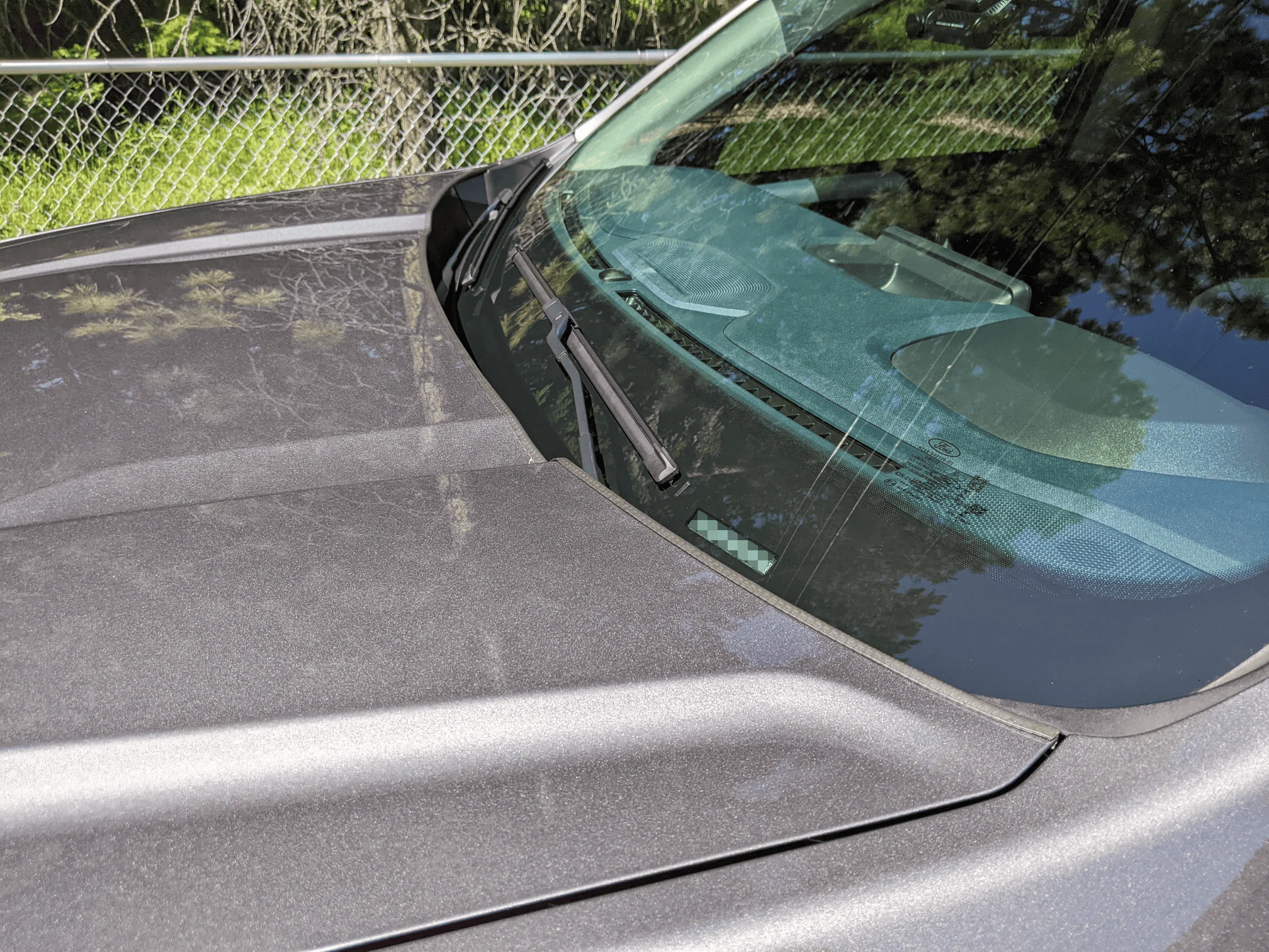

  • Wiper Arm/Hood Protection
  • Top Gun Maverick Decal
  • Tailgate Letters

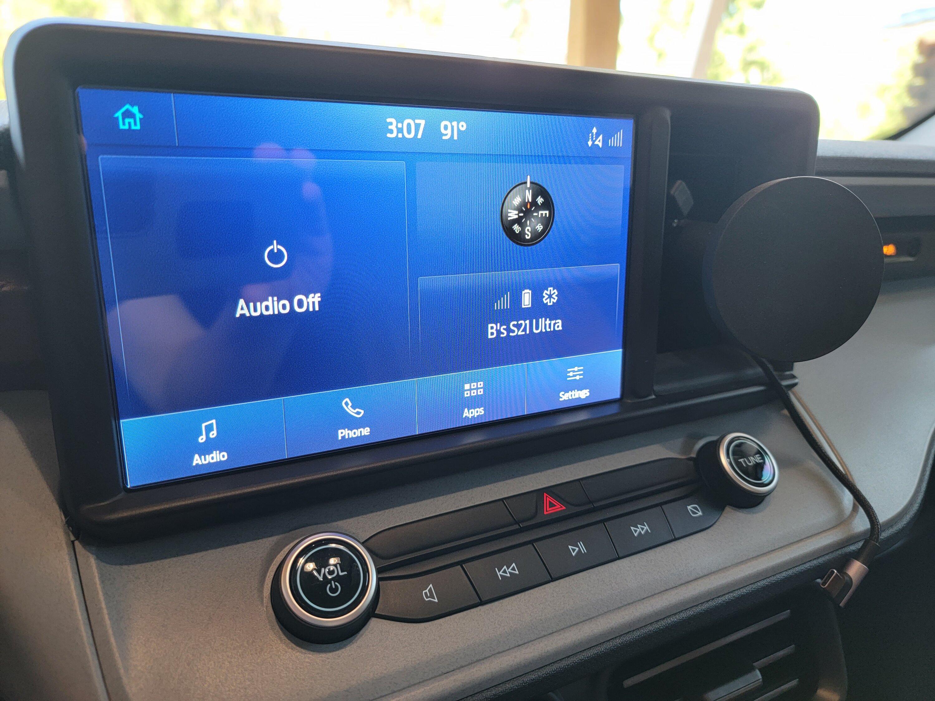

  • RAM Magnetic Phone Mount
  • Muslogy bed net
  • Keeper - Ratcheting Cargo Bar

Some close ups and specifics:

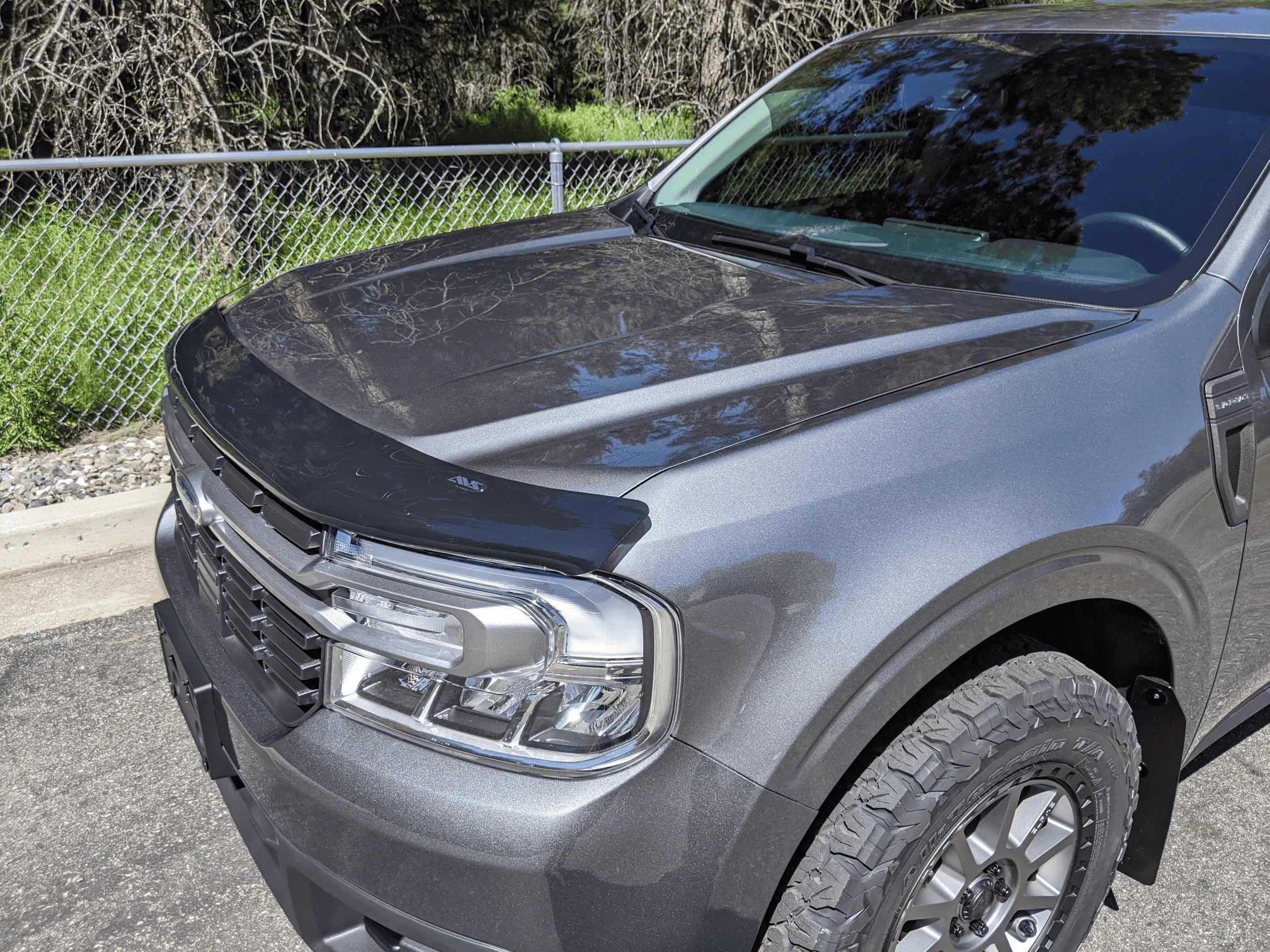

Hood modifications:
Ford Maverick Montana's Maverick - '22 Lariat Lux FX4 4K EB Hood 001
Ford Maverick Montana's Maverick - '22 Lariat Lux FX4 4K EB Hood 002

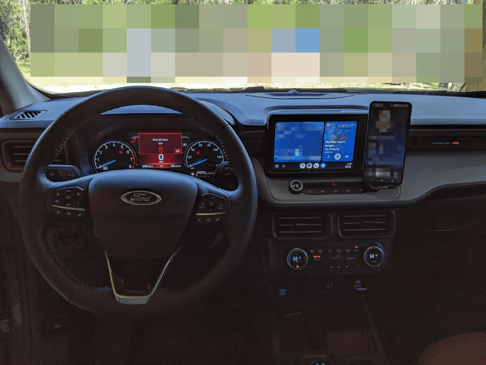

Interior:
(Full pack out
here on page 3)
Ford Maverick Montana's Maverick - '22 Lariat Lux FX4 4K EB Interior 001
Ford Maverick Montana's Maverick - '22 Lariat Lux FX4 4K EB 20230730_150831
Ford Maverick Montana's Maverick - '22 Lariat Lux FX4 4K EB 20230730_150708

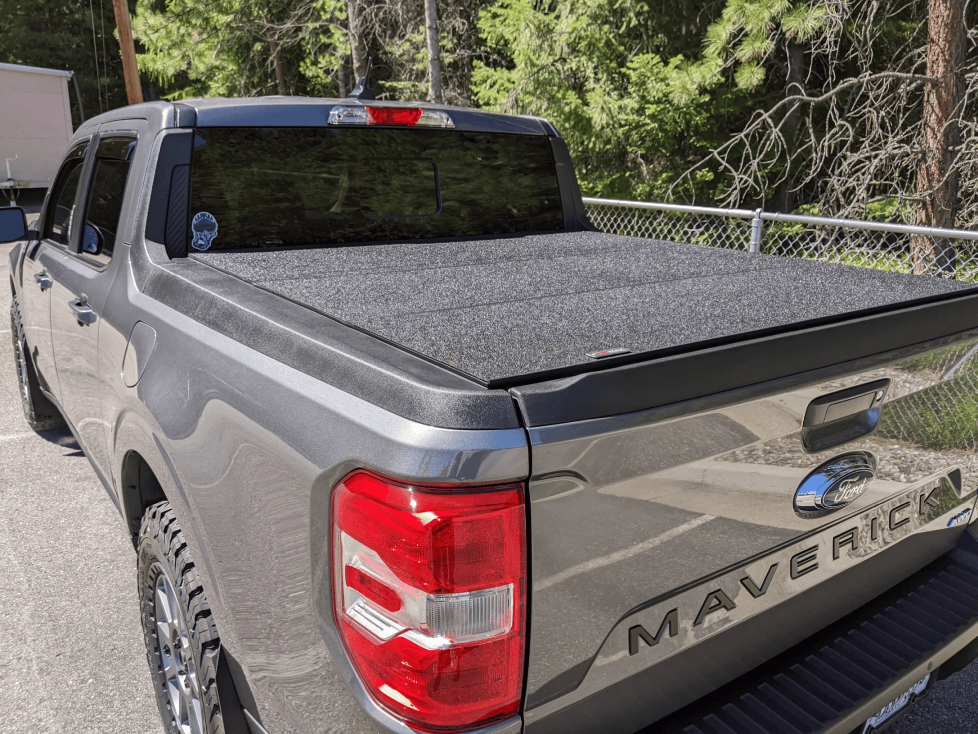

Tonneau Cover:
Ford Maverick Montana's Maverick - '22 Lariat Lux FX4 4K EB Tonneau Cover
Wheels:
Ford Maverick Montana's Maverick - '22 Lariat Lux FX4 4K EB Wheels 001
Ford Maverick Montana's Maverick - '22 Lariat Lux FX4 4K EB Wheels 002

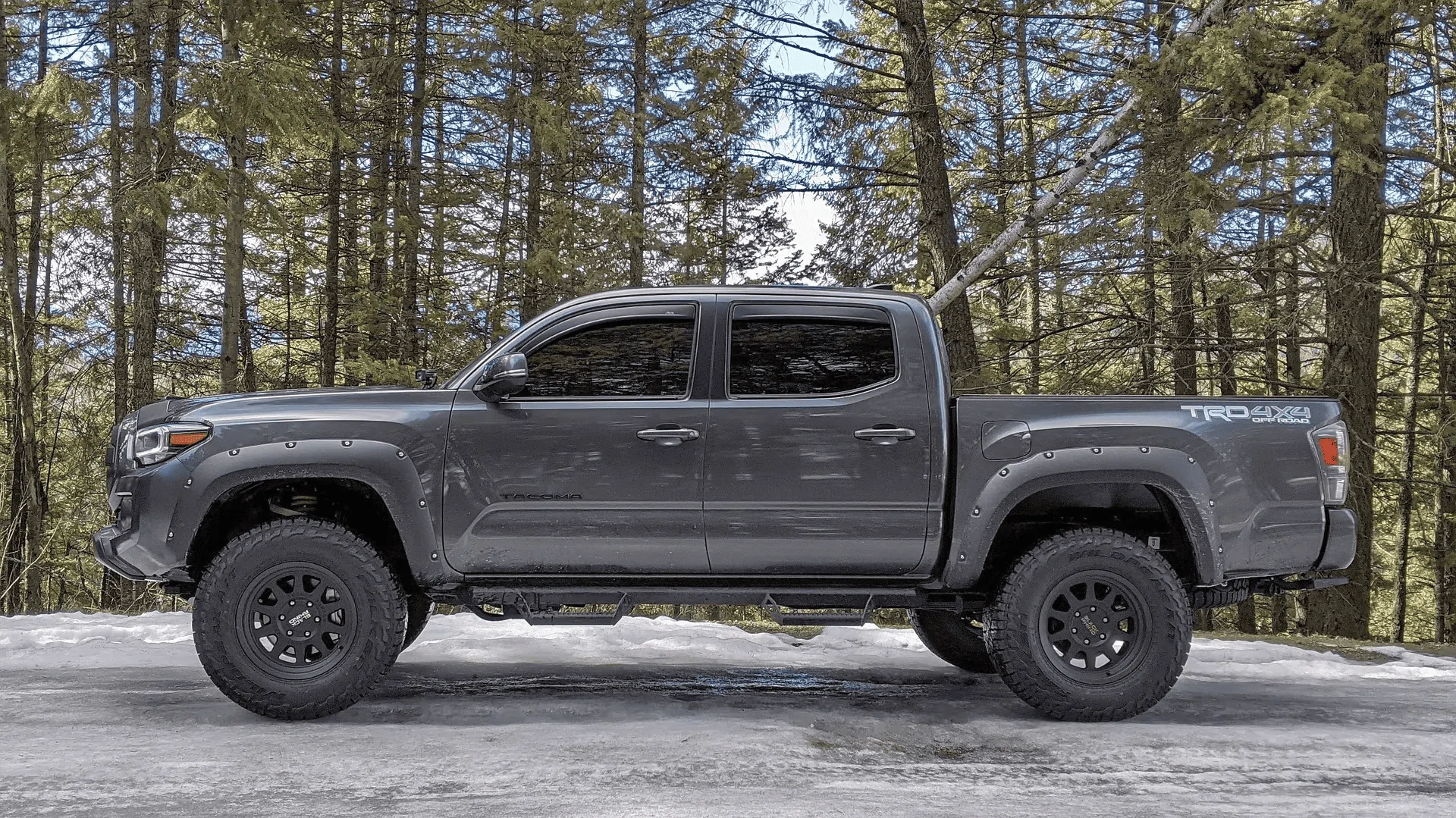

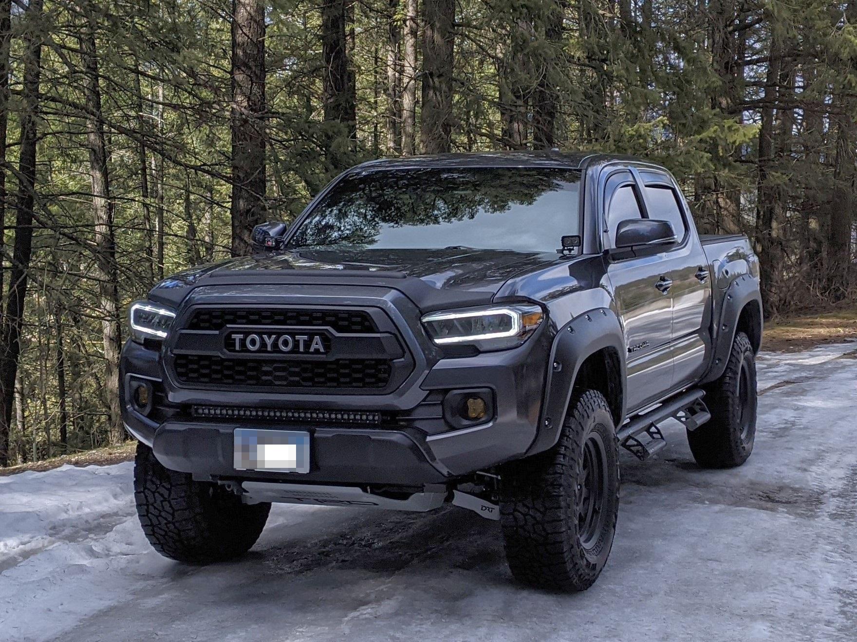

My previous 2 that I sold for this one:
'22 Tacoma TRD OR DCSB
Ford Maverick Montana's Maverick - '22 Lariat Lux FX4 4K EB 001
Modifications:
  • 285/70R17 Falken Wildpeak AT3's (E rated) (Full size spare and wheel tucked under bed)
  • 17" Black Rhino Stadiums (0 offset)
  • IronMan Stage 2 Foam Cell Pro 3" lift
  • ECGS Bushing
  • Nitro 4.88's
  • KDMax Pro Tune
  • LoMax Tri-fold hard tonneau cover
  • Swing out bed boxes
  • Tint (15 front, 5 rears)
  • Predator Steps
  • Rough Country 30" lightbar
  • Diode Dynamic SS3 Pro fogs
  • Diode Dynamic SSC2 ditch
  • OEM Plus Audio Reference 500
  • AVS Aeroskin II hood deflector
  • AVS low profile matte window deflector
  • Viofo A139 3ch Dashcam
  • VLED Footwell Lighting (blue dimmable)
  • Tacoma OEM Bedmat
  • Cali-Raised bed tie downs
  • Total Chaos Bed Stiffners
  • Fumoto Valve
  • MESO Total Tail V1
  • TRD skid plate
  • DRT Fabrication LCA Skids
  • KTJO Grab Handle
  • AMP-Research Bed Step

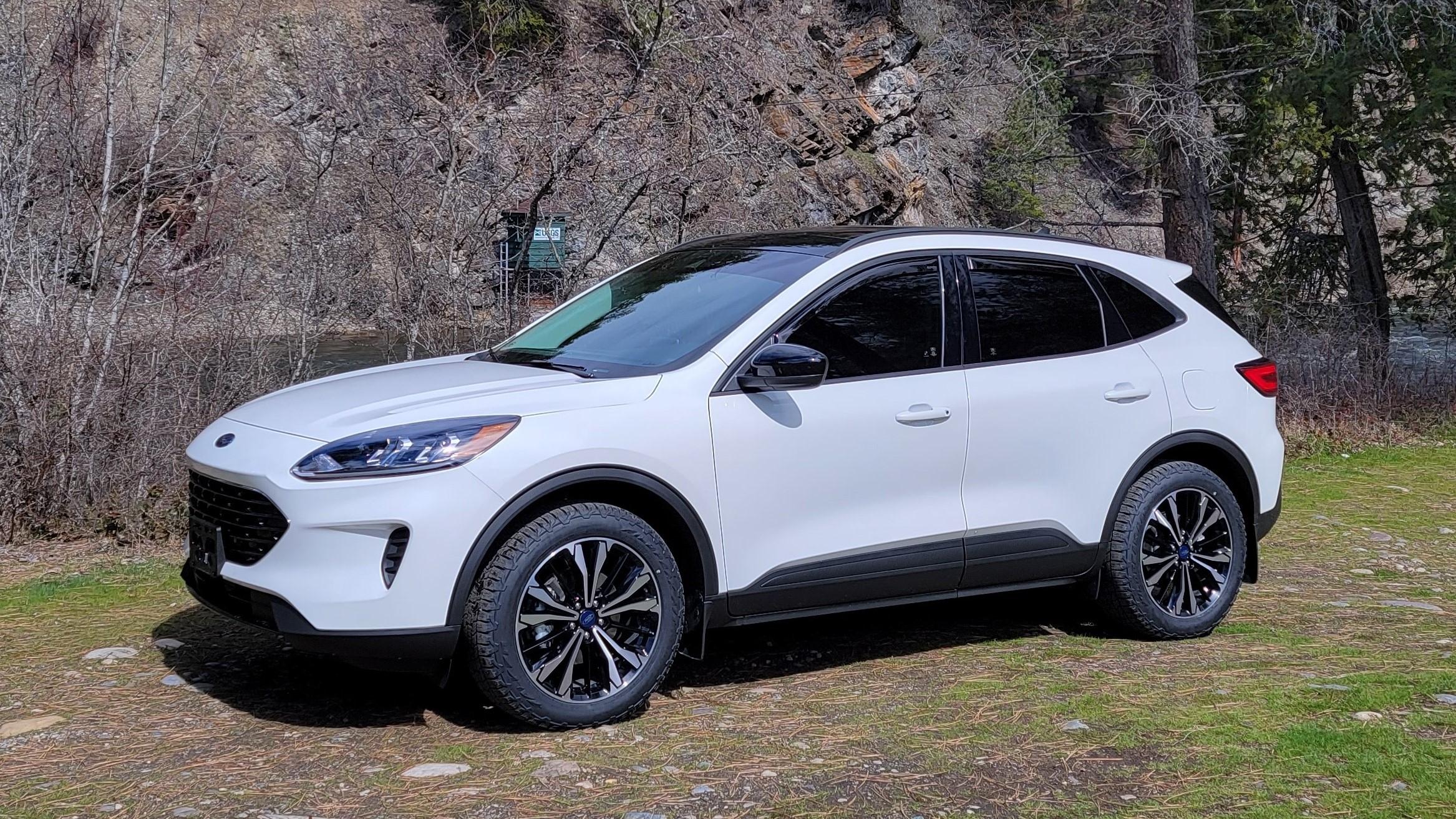

'22 Ford Escape SE 2.5L Hybrid Sport AWD
Modifications:
  • Falken Wildpeak Trails
  • Lasfit LED's

Like the Lomax cover. How’s the urethane finish with dirt and cleaning?

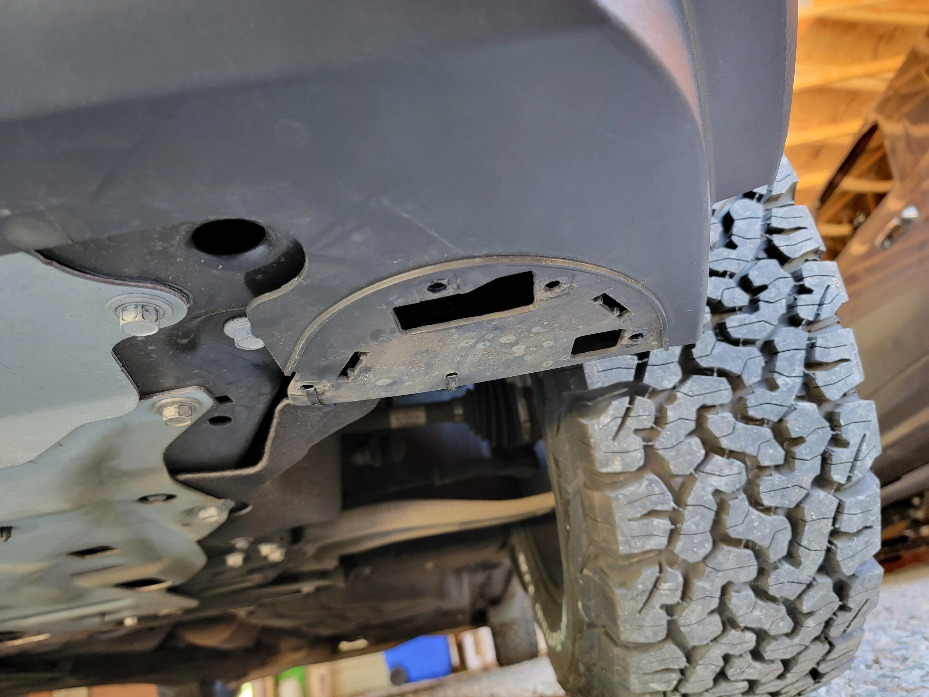

Also, here is a pic of the zip tie locations I used when I removed the front wheel air dams:
Ford Maverick Montana's Maverick - '22 Lariat Lux FX4 4K EB 20230702_161817
I drilled one hole in the "carpet" lining closest to the skid plates and another one in the plastic below the existing hole in the middle where the plastic clip is removed. The only downside to this is the holes that were under the air dams. I may explore a way to cover these up in the future.
It's not that I wanted a more "aggressive" look or anything, it's just they are REALLY low. I never had an issue in my lower Escape but twice since I've had the Maverick I've scraped them on something, and it's clear the previous owner did too. I'm also pretty sure they parked inside a giant tree... Literally inside of it... Debris removal wasn't crazy, but there was quite a bit. Same with the area the mudflaps installed on, and under that plastic piece where the wipers are. I removed that via the clips near the strut bolts. There was also a fair amount of smaller items lodged in small crevasses in the bed. Nothing crazy - but again, a good reason to negotiate the price down.

So far it's been a simple wipe down. It's not a gritty matte texture like a bed liner. It may not be as flat as the plastic trim pieces but I think it looks better than the other version they offer. I had that one on a Tacoma and it just doesn't look the same on the Maverick from the pics I have seen. It's really shiny.
Admittedly, I like the look of the REV/FORD one because it has the same finish as the surrounding plastic, but I would rather save $500. The LOMAX fit needed a bit of extra love and it still doesn't really seal near the rear window or the tailgate. It's good enough for me. If I was going for a perfect seal, the REV/FORD version would be a better option from what I hear on this forum.
Comparing the install to both a RAM 2500 and a Tacoma I have done with the same LOMAX cover, it's definitely better on the bigger trucks. There is more room for adjustment and play. There is virtually none on the Maverick, and you need a second person to help push down on the brackets while you tighten to avoid a really poor fit. I never had that issue on the other two I did. I clamped them in place and was able to tighten and adjust very easily.
Overall though, it's good if you want to save that money. I'd likely buy it again due to it's cost.

How do you like the Bugflector II? Does it install with clips on the underside of the hood or is it taped to the hood? I can’t tell from other pics if it sticks out too much or if it looks better in person.
I've had the other version of the Bugflector that is flush with the hood but has that little bump in the middle on a previous Tacoma. I didn't like the fact that it was not totally sealed underneath. There were tons of spots for debris to enter and fester underneath. I almost considered removing it before I sold the Tacoma just to see how bad it was after two years, but I chose not to. Not my problem anymore haha!
The smoke one I have on the maverick I've also had on a previous F150 and I loved it. It does a lot more for deflection, even though as you mentioned, they do protrude a bit. It definitely does not stick out much or I wouldn't have bought it either.
Onto some installation tips and walkthrough:
You will need some double sided tape to put the weather stripping back up in the spots the visor and it's clips have taken over because AVS did not provide any and the clips no longer retain it like the stock ones did. Don't lose faith - it's still a VERY easy process and a decent product compared to the other options. You may also have to drill a correct hole in one single location as many people on this forum have noted that one does not line up. Don't get all bothered by it and just fix it yourself. It's simple. Moving on...
As for the mounting, you have to remove the weather stripping in 4 spots and they provide new (very crappy) clips. Use a grease pen to mark under the hood where the holes are on the visor when you are test fitting it. Doesn't have to be exact, just so you know which clips to pull and what portion of weather stripping they are under.
The stock clips are inside the weather stripping, so when you pull to either side gently and downwards, the weather stripping will pop off. Then you use a pry tool to remove the stock clips. They get discarded, but you may want to retain them for the future if you plan to resell or something. Label that bag and put it with anything else you might have saved - like stock clips from mudflaps or the extra 12v cable they put in the glovebox when you buy the truck.
Now you are good to put the visor back up and start installing clips. You will install them UNDER the weather stripping and they do not provide any adhesive to put the weather stripping back on, so it's a good time to plan on adding some. I used a thin layer of double sided extra strength 3M. Start left to right because the far right hole may not line up. I'll cover this in the next paragraph as it's an easy fix that most people over react to and try to return the product. All you have to do is drill a new hole, but if you start on that side it will be much harder. So, working left to right (and assuming said far right hole does not line up properly), get your replacement clips on the first 3 holes in place. They will screw in and they are plastic, so be gentle. No need to torque them down. In fact, wait until after the final screw is in place to finalize tightening everything, but get them snug enough the visor does not move.
As many have mentioned on this forum and I stated earlier, often there is one hole on the visor that does not line up. So now that you have all the other 3 clips in place, you can drill the correct hole. You are not drilling into the hood, just the plastic of the visor. Of you got lucky and yours does line up, obviously skip this step and you are done after the 4th clip. If not, drill the hole needed or extend the current one. The clip will still retain the visor due to it's lip.
Now your Bugflector II is mounted. Notice how the weather stripping just kind of hangs there. It's not super loose, it won't fall, it will still seal, but why not add some double sided tape to those spots? I measured about 3" of double sided 3M for each one and applied it to the visor, then stuck the weather stripping to it. Violla - stand back and marvel at your master mechanic skills and realize you can never expect a 100% product from any company anymore. You are now equipped to take on any challenge life throws at you :cool:
Here are some pic underneath after it's all said and done (please excuse the bug guts, it's 90 degrees in rural Montana and I chose a day I didn't feel like cleaning to show you this lol):
Ford Maverick Montana's Maverick - '22 Lariat Lux FX4 4K EB 002
So, all that said... it's a product that deserves 3 stars because of the modifications needed, but if it wasn't for that it would be a 5 star rating in my opinion. Again, I think it's better than the options that stick to the hood and not even close to worth the hassle for a return. Even if I got it via Amazon prime and stuck it back in the box for a quick drop off, it wouldn't be worth returning. I'm a DIY kinda guy and this was simple grade school stuff.
I hope this was helpful!
