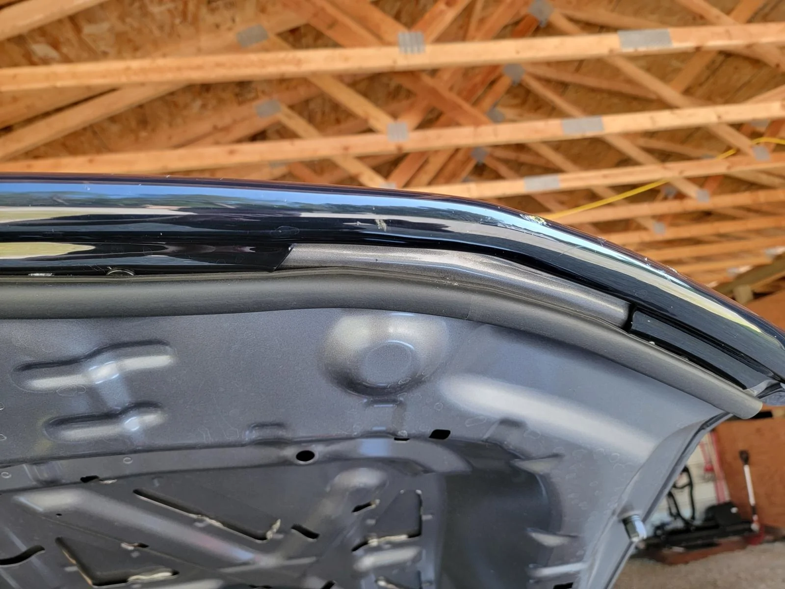

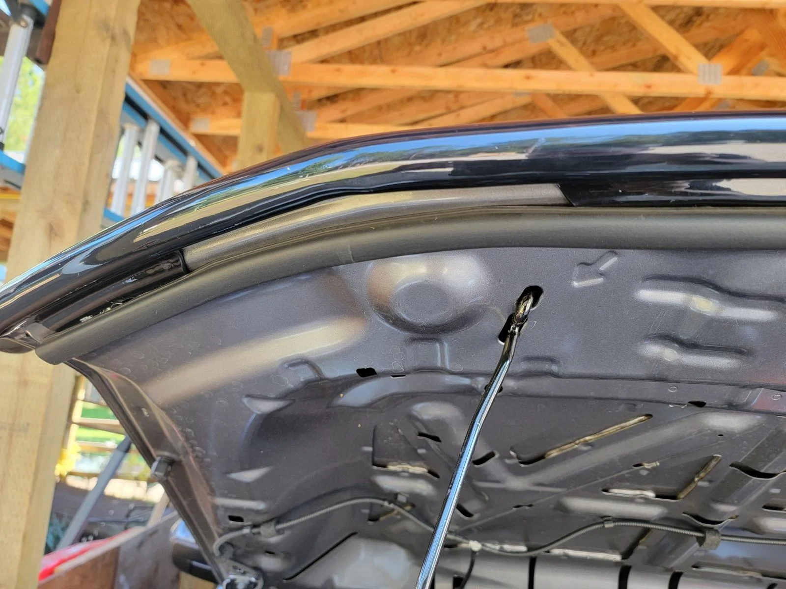

I've had the other version of the Bugflector that is flush with the hood but has that little bump in the middle on a previous Tacoma. I didn't like the fact that it was not totally sealed underneath. There were tons of spots for debris to enter and fester underneath. I almost considered removing it before I sold the Tacoma just to see how bad it was after two years, but I chose not to. Not my problem anymore haha!
The smoke one I have on the maverick I've also had on a previous F150 and I loved it. It does a lot more for deflection, even though as you mentioned, they do protrude a bit. It definitely does not stick out much or I wouldn't have bought it either.
Onto some installation tips and walkthrough:
You will need some double sided tape to put the weather stripping back up in the spots the visor and it's clips have taken over because AVS did not provide any and the clips no longer retain it like the stock ones did. Don't lose faith - it's still a VERY easy process and a decent product compared to the other options. You may also have to drill a correct hole in one single location as many people on this forum have noted that one does not line up. Don't get all bothered by it and just fix it yourself. It's simple. Moving on...
As for the mounting, you have to remove the weather stripping in 4 spots and they provide new (very crappy) clips. Use a grease pen to mark under the hood where the holes are on the visor when you are test fitting it. Doesn't have to be exact, just so you know which clips to pull and what portion of weather stripping they are under.
The stock clips are inside the weather stripping, so when you pull to either side gently and downwards, the weather stripping will pop off. Then you use a pry tool to remove the stock clips. They get discarded, but you may want to retain them for the future if you plan to resell or something. Label that bag and put it with anything else you might have saved - like stock clips from mudflaps or the extra 12v cable they put in the glovebox when you buy the truck.
Now you are good to put the visor back up and start installing clips. You will install them UNDER the weather stripping and they do not provide any adhesive to put the weather stripping back on, so it's a good time to plan on adding some. I used a thin layer of double sided extra strength 3M. Start left to right because the far right hole may not line up. I'll cover this in the next paragraph as it's an easy fix that most people over react to and try to return the product. All you have to do is drill a new hole, but if you start on that side it will be much harder. So, working left to right (and assuming said far right hole does not line up properly), get your replacement clips on the first 3 holes in place. They will screw in and they are plastic, so be gentle. No need to torque them down. In fact, wait until after the final screw is in place to finalize tightening everything, but get them snug enough the visor does not move.
As many have mentioned on this forum and I stated earlier, often there is one hole on the visor that does not line up. So now that you have all the other 3 clips in place, you can drill the correct hole. You are not drilling into the hood, just the plastic of the visor. Of you got lucky and yours does line up, obviously skip this step and you are done after the 4th clip. If not, drill the hole needed or extend the current one. The clip will still retain the visor due to it's lip.
Now your Bugflector II is mounted. Notice how the weather stripping just kind of hangs there. It's not super loose, it won't fall, it will still seal, but why not add some double sided tape to those spots? I measured about 3" of double sided 3M for each one and applied it to the visor, then stuck the weather stripping to it. Violla - stand back and marvel at your master mechanic skills and realize you can never expect a 100% product from any company anymore. You are now equipped to take on any challenge life throws at you :cool:
Here are some pic underneath after it's all said and done (please excuse the bug guts, it's 90 degrees in rural Montana and I chose a day I didn't feel like cleaning to show you this lol):
So, all that said... it's a product that deserves 3 stars because of the modifications needed, but if it wasn't for that it would be a 5 star rating in my opinion. Again, I think it's better than the options that stick to the hood and not even close to worth the hassle for a return. Even if I got it via Amazon prime and stuck it back in the box for a quick drop off, it wouldn't be worth returning. I'm a DIY kinda guy and this was simple grade school stuff.
I hope this was helpful!

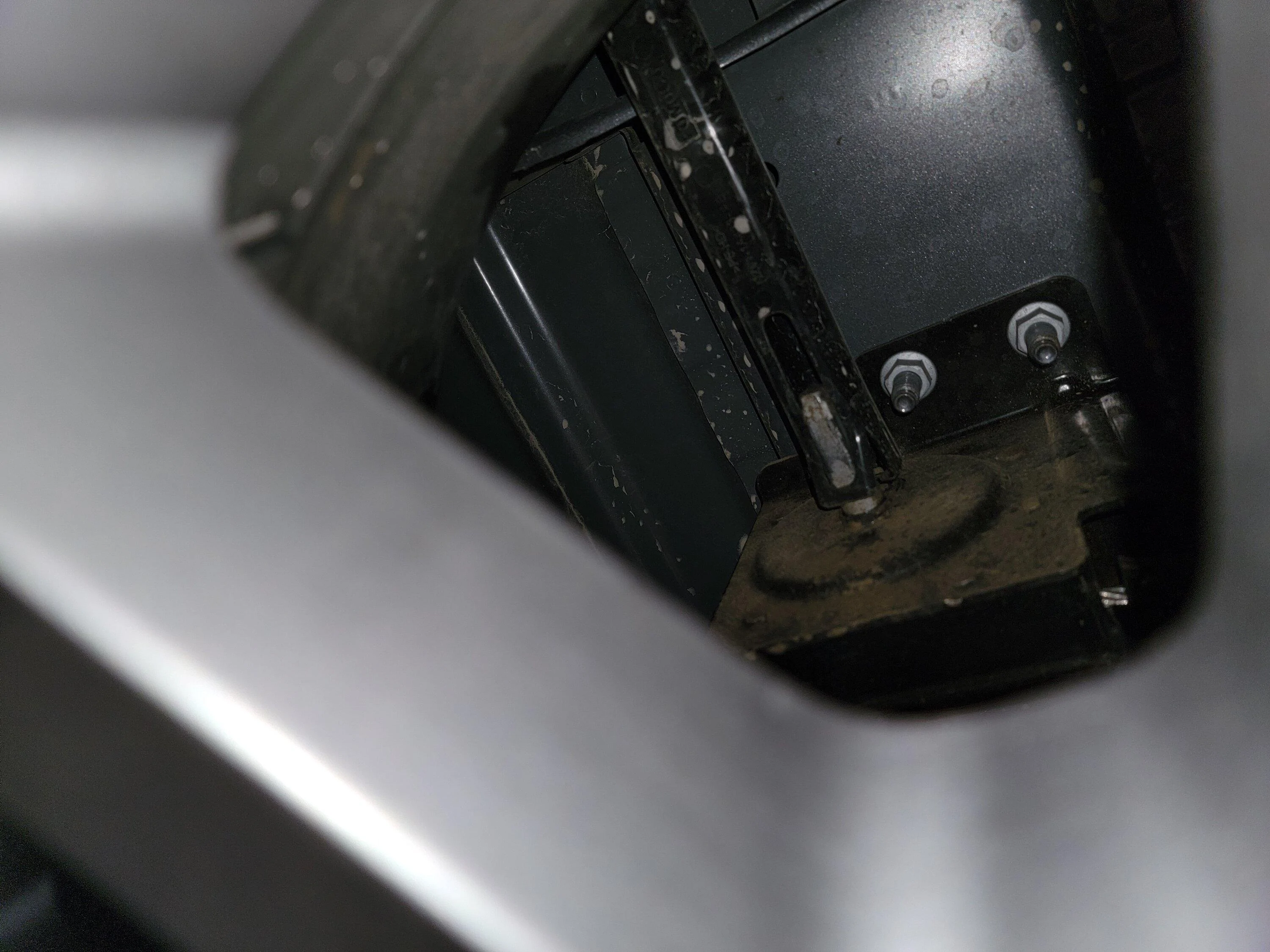

Confirmed today that a full size 245/65R17 does fit as a spare with plenty of room. However... ran into an issue and thought I had broken the housing for the tool that drops the spare. Tightening the full size I had the complex design that needs a degree to figure out how to piece it through the wheel in order all messed up and it pulled too much on the guide to the part you hook into. Also, why can't they just make the damn tool 1/4th or 3/8's size. It just has to be some proprietary part between those two so you can't fit your own tools on it. Smh.
But this is what happened:
Ford Maverick Montana's Maverick - '22 Lariat Lux FX4 4K EB 20230711_144741
So immediately I thought the worse because it looks like the housing was bent during the process. Turns out they don't secure that guide to anything the entire way though. It's just loose and the only attachment it has is at the bumper. So I wedged a pry bar in there from the exhaust side and was able to pry it down very easily to get the tool back on and lower the full size spare (which was my drive tire that I was testing).
I will say that the amount of effort to get the spare down and out from the wheel was appalling. First, you need to remove a 21mm bolt that is attached to a safety line. Then you can lower and you have to give it about a foot of slack because once the tire is on the ground you will need to feed the slack through so you can wedge one piece at a time through the wheel - but first you have to slid off a little blue spacer. So imagine doing all this on the side of the road or anywhere for that matter and not knowing any of this. It's a good thing I tested this. I always check the spare regularly but I never thought I would need a degree to figure out how to lower one. By far the most complex setup I have ever dealt with and you will hate it if you ever have to use your spare.

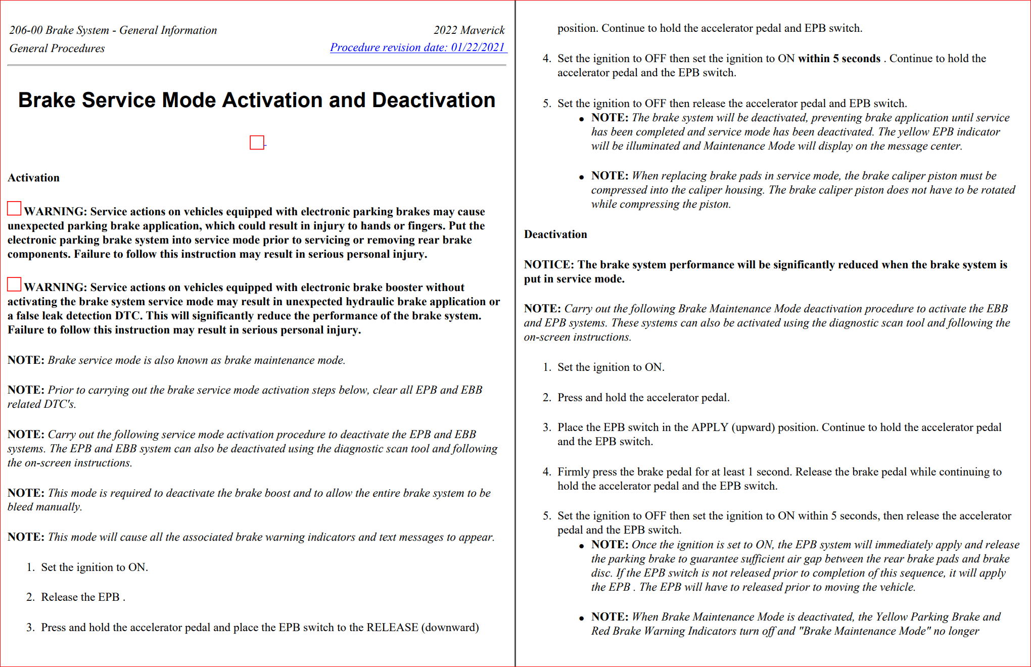

Brakes. Well, the truck wouldn't go into brake service mode. Apparently there is a TSB on it. There is a single thread on it here. So now because my truck won't go into service mode, the only thing I can do is front brakes. This means EVERY SINGLE TIME I need brakes I have to take it in to get the rears done and pay someone for such a simple task.
@Ford Motor Company , you guys need to figure out a solution for this. Because currently your solution is to take it into someone equipped with a Ford Diagnosis and Repair System (FDRS) scan tool to activate the Brake Service Mode. Run the ABS-Electronic Parking Brake (EPB) Service Tools app and select enter park brake maintenance mode. Normal people do not have these things. I have Forscan and it can't even be done on that. FDRS cost way too much money to invest in to simply change my brakes, and I'm not paying someone else hundreds of dollars for something that costs $50 and 2 hours tops. That is not a solution. This needs to be a TSB and have an actual fix. Please address this issue.
Obviously I'm not happy about all this and today kinda sucked. Two VERY simple tasks and it took me all day. I guess I'll see what the local dealer says tomorrow about all this, but honestly, I kinda feel like this is what happens when a majority of people don't know how to service their own brakes. Hell, people can't even change their own oil...
For reference, here is what you are SUPPOSED to be able to do:
Ford Maverick Montana's Maverick - '22 Lariat Lux FX4 4K EB Service Mode 001.PNG
Seriously annoying. At this point, if this system is this complicated, I'd rather have rear drums and a cable parking brake. I can't help but wonder how many people are totally clueless due to how new these setups are and just paying other people (dealerships) to work on their vehicles for the sake of convenience and if FORD will ever develop a fix for those reasons. Hopefully I am proved wrong, but I won't let the issue get buried for all the people that have noticed the issue and will continue to in the future.

I confirmed at the dealer today there is currently NO FIX for vehicles that cannot enter brake service mode. The only option is to pay someone with FDRS then the service app.
It's not even a TSB... it's an SSM. I'm very flustered by this failure. This kind of thing should not happen and it's happening across tons of FORDs with EPB's. The dealer said they had to do it for a Mach E and a couple F150's this year already. I have no issue with recalls and TSB's but this isn't even being addressed.
I tried doing it again today, thinking I did something wrong. But after 20 times it's clearly not me. I was able to do the seatbelt chime sequence in 3 tries.

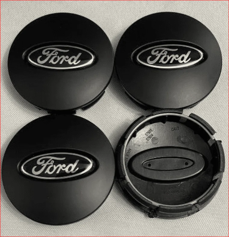

I did order some more goodies today at least:
These to replace the center covers on my AlphaEquipt Foxtrots
Ford Maverick Montana's Maverick - '22 Lariat Lux FX4 4K EB Captur
Maybe help bring back the stock look a little more since I went pretty aggressive with the wheels and tires. I also got some chrome lug nuts to sort of tie in the bright accents on the front and the rear badging, and I plan to add an FX4 sticker in a grey variant but I'd like to find one with a silver outside lining to also tie in the lighter accent colors. Still looking on that one. I found this one but I'm worried I won't like it once it's on the truck.
Ford Maverick Montana's Maverick - '22 Lariat Lux FX4 4K EB Capture1
Pic is not from a Maverick and it's sitting really low, but just showing for the color options.
Opinions welcome.

You could find something that wraps around the wiper arms if you dont want to stretch a molding across the hood. I actually didn't consider doing this until just now because I've used that molding for so many other things like tool racks and gun racks, so I didn't buy it specifically for the hood and was extra I had stored. It just kinda popped in my head since my Maverick is used and the paint is already chipped there on the hood. But I suspect something thin with a strong adhesive backing, like a black felt or carpet like material, would be small enough to not be so obvious and durable enough to withstand years of use when placed directly on the wiper arm.

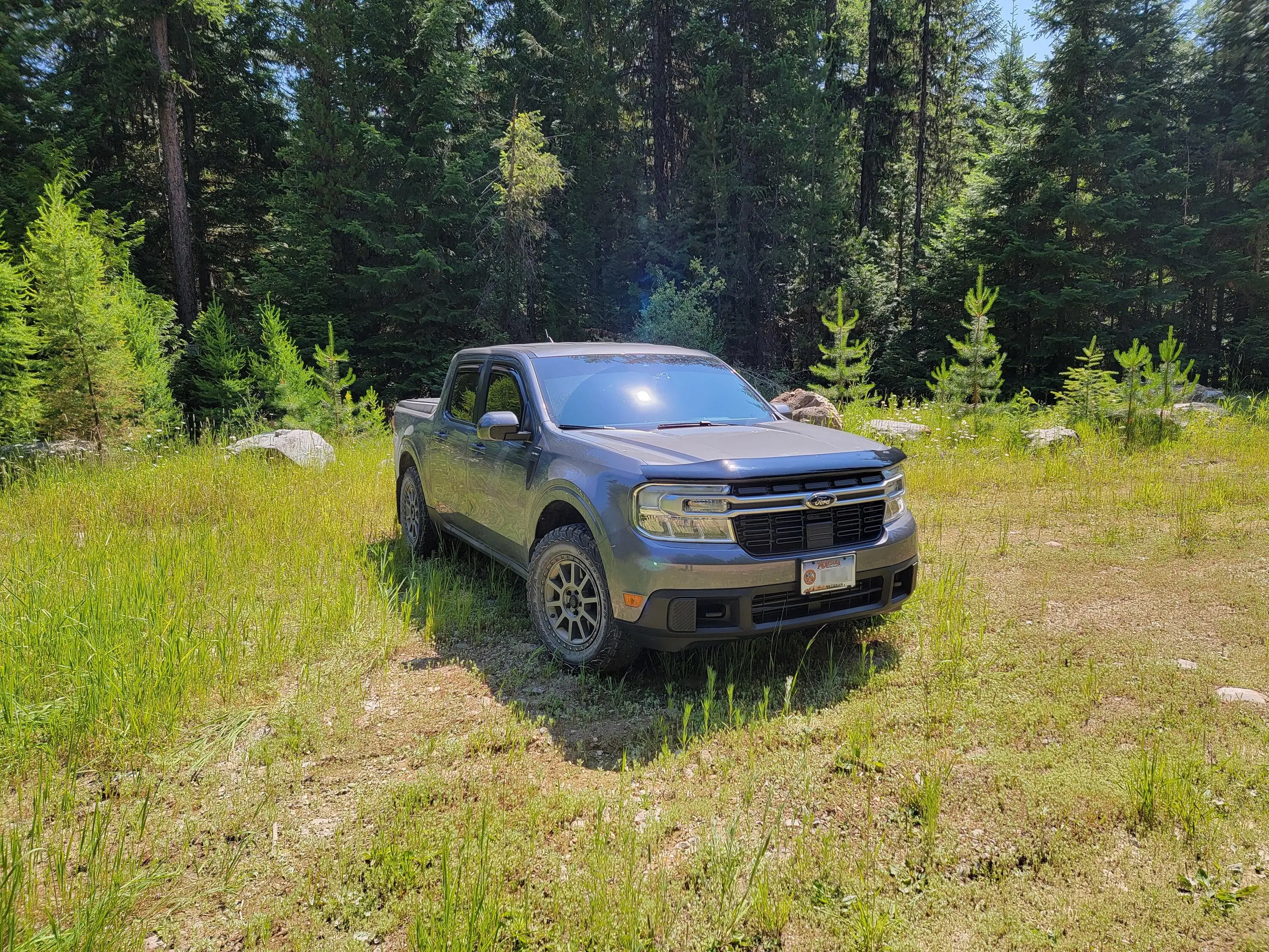

Outstanding write-ups and solid suggestions/links man. Truck looks fantastic.
