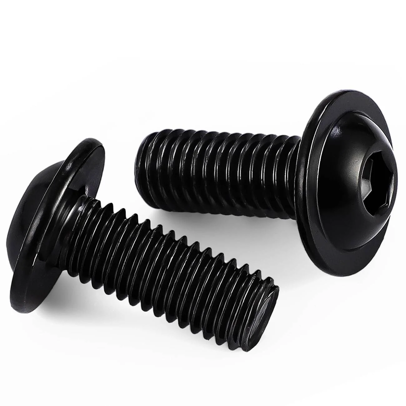

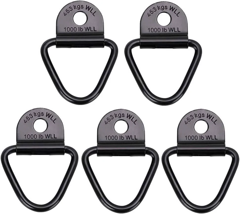

FabMav
JR
Nov 7, 2021
275
292
XL
I went with the same cheaper Amazon V-rings. I didn’t see the need for fully adjustable sliding attachment points on a short bed, especially with the cost difference.

I was thinking the same about just installing individual rings, but someone mentioned that attaching ratchet straps to individual rings and tightening them could - depending on how Ford attached the bolt holes in the bed - pull and possibly distort the bed walls. I am thinking that attaching the DIY channel to multiple bolt connections could spread the stress better.

Agree - the rails absorb some of the force and provide load distribution across the system instead of putting it on a single attachment point.
The D rings also do not provide as much flexibility as the entire system to attach other accessories.

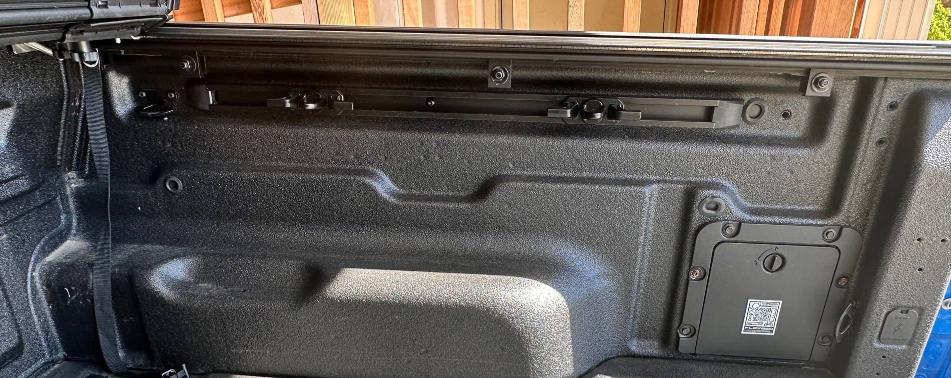

I also just bought Ridgeview Bed Rails. Great look and functionality!

Hi Brett are you satisfied with your purchase I am looking at this option also. Not much mounting info on the product. Thank you, Paul

Yes. I've only used it a few times but no issues. There are 3 bolts that hold the rail (2 are behind the tie-downs. The tie-downs slide to any position and will tighten down by turning the middle loop clockwise. It's very straight forward. Best wishes on whichever direction you choose.
