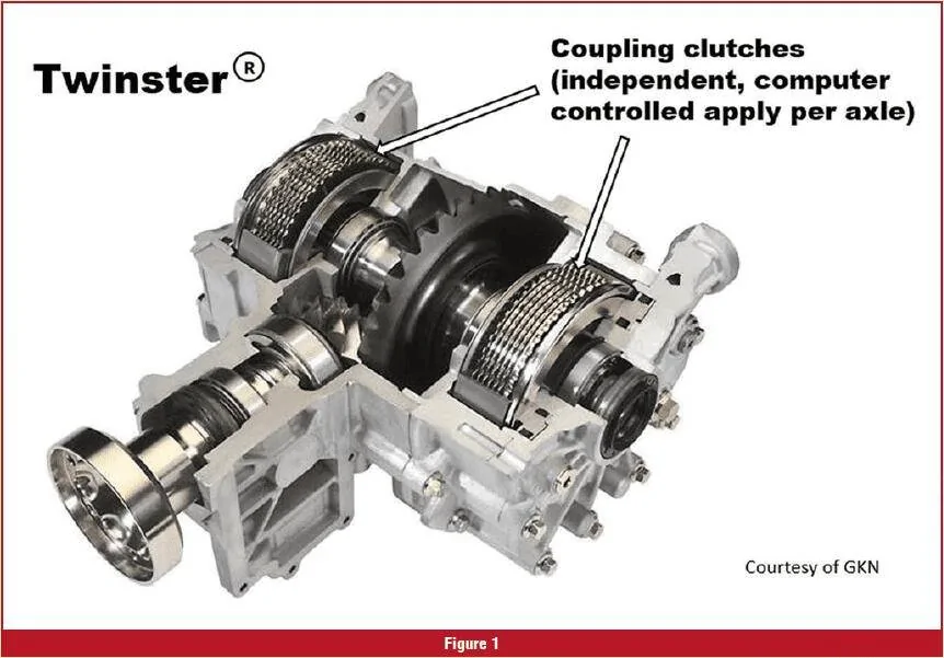

The pictures you’ve sent are of the rear differentials. You can see the rear axle CV cups going into the diff on either side and that it’s attached to a rear subframe in the photo.

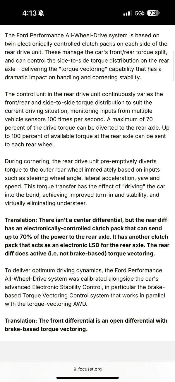

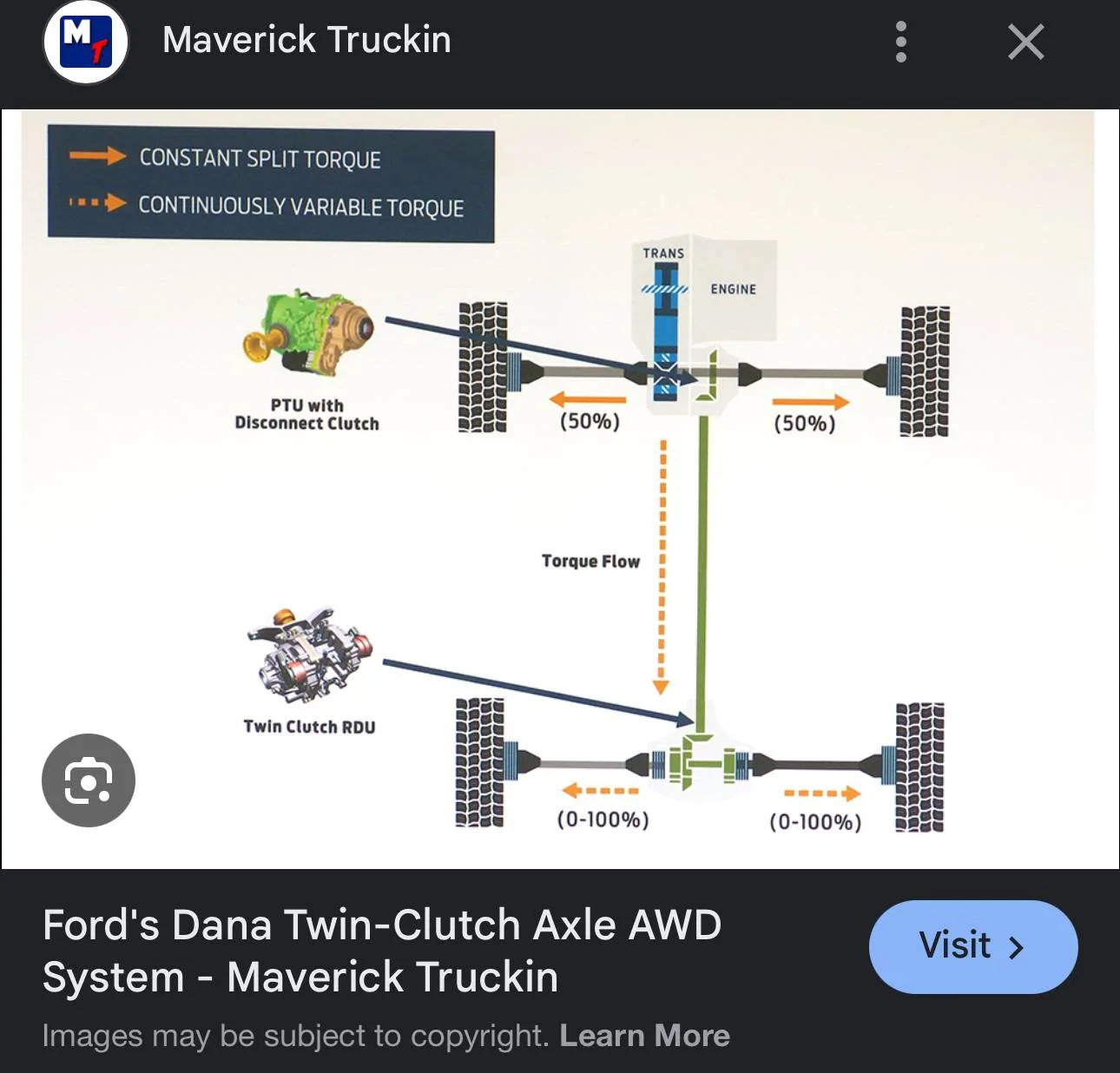

Let me apologize, I did not read “RDU” properly and think “Rear Differential Unit.”
That being said, you also didn’t realize apparently that both photos are literally the same rear differential unit…
Please refer to these photos and the explanation. It outlines it thoroughly and it’s clear there is no disconnect in the RS PTU, only in the RDU.
When the two independent clutches on both rear axles are open, there is *realistically* no torque being sent to the rear. That’s why the PTU disconnect in the Maverick seems redundant, but I imagine they found it had a reliability benefit otherwise they probably wouldn’t have added it.
