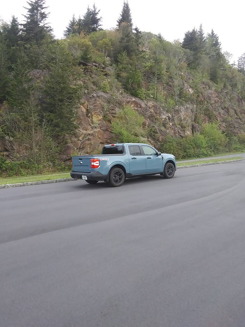

Happy with Pirellis so far . probably age out before wear out ( currently 3 years and 9 k miles ) . I like michlein tires . don't do much sand / off roading . Got fx4 for suspension and other upgrades .
Ford Maverick Maverick replacement tires 20240521_091725
