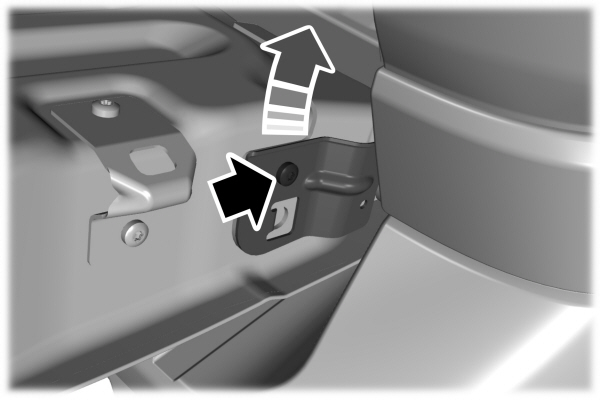

How to remove the tailgate?
To remove the tailgate, follow these steps:
  1. Unlatch and open the tailgate.
  2. Disconnect the power door locks in-line connector located under the pickup box on the right-hand side of the vehicle near the spare tire.
    Ford Maverick Maverick Monday: How to Remove Tailgate {filename}
  3. Install the protective cap (found in the glove compartment) on the end of the in-line connector that remains under the pickup box.
  4. Partially lift the tailgate. Carefully feed the tailgate harness up through the gap between the pickup box and the bumper and place it out of the way under the pickup box.
  5. Lower the tailgate.
  6. Remove the screw and safety bracket.
  7. Use the pull tabs to unlock the clip on each connector, move the clip past the head of the support screw, and disconnect the cable.
  8. Disconnect the other cable.
  9. Lift the tailgate to 45 degrees from the horizontal position.
  10. Lift the right-hand side off its hinge.
  11. Lift the tailgate to 80 degrees from the horizontal position.
  12. Remove the tailgate from the left-hand side hinge by sliding it to the right.
Note: The tailgate weighs approximately 55 lb (25 kg). To avoid damaging the tailgate, you may need assistance when removing it. To install the tailgate, reverse these steps.
