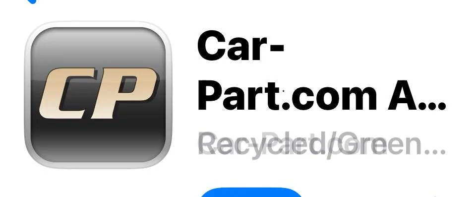

Thanks,
What is the first link. It takes me to a used car. Also that display bolts right on?
[type in 2023 transit 250 and click on info screen 12” there are lots on there
They fit but I understand there’s a little gap on sides
You can also find ACM /APIM also there. Lots of choices
I found if you go to the yards site
Sometimes cheaper then build your harness of buy from Sam
The fun begins
Programming with forscan
