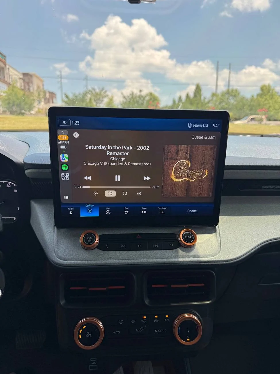

I bought the upgrade directly from OEMplusupgrades. My setup is the XLT (aka Sync 2.5). Sam was super helpful and responded to all my noob questions quickly. I have had it running for about a week and here are my impressions:
1. Install was very easy and plug and play. Took me about an hour because I was being real careful with trim pieces.
2. the screen is an amazing upgrade to the 8". not only do you have a lot more screen but the resolution and contrast is so much better.
3. I had to use forscan to enable the ambient lighting in the new APIM.
4. Wireless CarPlay performs much better. connection time is seconds and in some case I'm getting audio from CarPlay before the screen switches over.
5. Temperature is displayed on screen for both the hvac and outside...see pic. when you adjust the fan/temp it shows onscreen same as with what you got.
6. I feel like audio fidelity is better, but I wear hearing aids so take that as you will :)
7. Ford Pass is still working. that setup info is stored somewhere else in some other module. downside is you can't manage those setting from Sync 4. you'd have to reconnect the old ACM and display to make adjustments. Otherwise, I can still remote start, lock/unlock and get telemetry.
8. GPS is enabled. but map updates I don't believe works... for me I don't care since I use CarPlay.
9. For me, I'm very pleased with this setup. no regrets.
What doesn't work:
1. No software upgrades. What you have is what you get. besides, I don't think we'll get many (or any) more updates on older Sync tech so not much of a loss there.
2. connected services won't work since it wasn't an option before
I have not monkeyed with Forscan enough to see what else I can or can't enable. I'll update if/when I can.
lastly, this isn't for everyone. but for those of us that like to tinker and upgrade things that don't have to be upgraded it's perfect. :). I you don't like messing with Forscan or pulling trim panels and messing with electronics, it's not for you.
