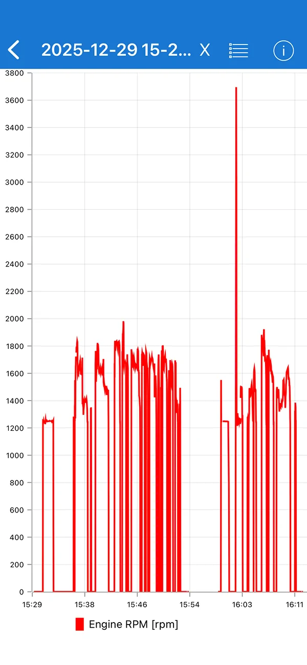

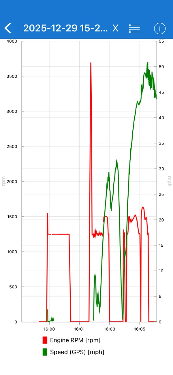

Here is a picture showing RPM and MPH.
As you can see the truck was not moving.

That's a good screenshot that we've been asking folks reporting for. That does validate the spike in RPMs to upper 3000s but it surged for 1 second before backing off.
A one second surge could kill a pedestrian in the crosswalk or cause much physical damage hiiting the car in front of you if your foot wasn't on the brake. In any case, doesn't seem healthy for the engine.
Engine revs don’t equate to acceleration with the HF55 drivetrain.
