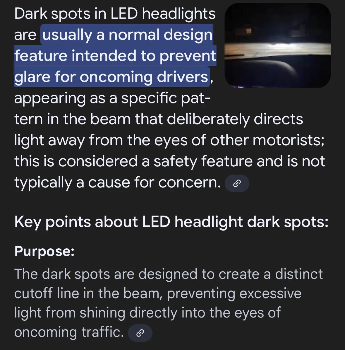

I agree that's what cutoff is for, but the fact that these spots would never align with the oncoming driver's eyes doesn't support Google's theory.
They look like artifacts from emitter wires to me, but that's pure speculation.

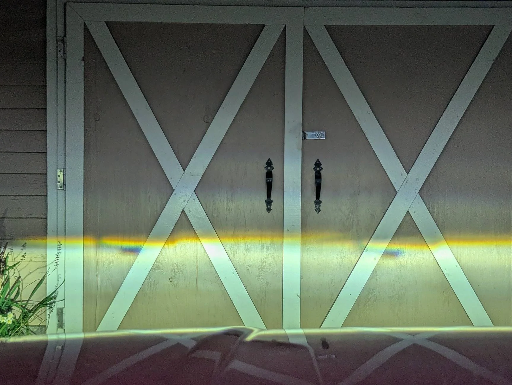

It's just part of the cutoff shield, when low beams are on its in place cutting off the top portion of the light. When you active high beams it drops out of the way.

My understanding is that these dim spots are simply to pass (more like dupe) an antiquated compliance test for headlight assemblies.
There are specs that state there has to be a certain amount of light (or less) measured at a specific spot in space...at a specific distance from the vehicle and at specific vertical and horizontal measurements.
They design the assemblies so that during the compliance test, these litte dim spots lign up at those spots so the measuring device placed at that exact position registers a lower amount of light, and therefore the assembly passes the test and gets approved.
In theory, yes the idea of the test is that the position would represent an oncoming driver's eyes. But it doesn't take much to figure out that it only works for a rare state where both of the cars are at pretty well defined positions. Any variances in attitude, yaw, and distance from that perfect test position means that these spots wouldn't align with their eyes.
It's an old and poorly written test specification, just like a lot of our other laws and specs for headlights, and vehicles in general for that matter. The vehicle manufacturers use this design so they can squeak by the test yet still have higher output assemblies.

I kind of have the same.
Also check on the alignment angle.
These, like all headlamps, should be at a slight DOWN angle. Not level. And certainly not up.
On level ground...
Mark that bright top line with tape or something. Then back up 20 or 25 feet.
The bright line should be below your original mark as you back up.
The lamps are easy to adjust with a phillips head screwdriver and a single screw.
Mine came from the factory angled up into space.
Those two dark spots are molded into the glass of the headlights. I believe it might say: "Maverick"

Can confirm they are used to reduce the light to oncoming traffic at eye level. Up close like the original picture they appear to be straight on but when you back up 100+ feet they converge bias to the driver side. I was driving the PA turnpike and I notice when the divider was low or going around turns the dark spots would line up right with the oncoming traffic. Even tested it with a family member driving down the street.
