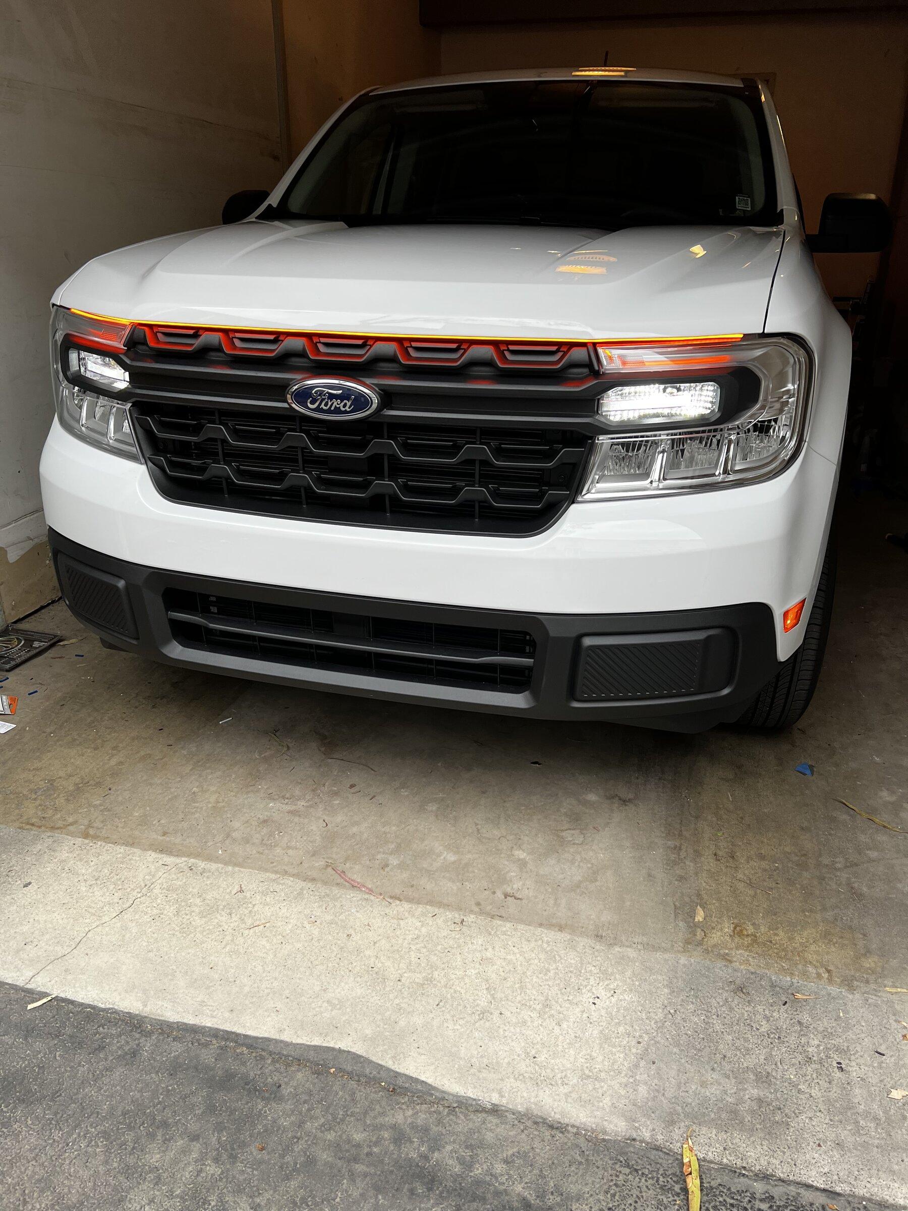

Hey! Sorry it took so long. I ended up ordering some 1/4 split loom and some half inch zip tie mounts for the hood and realized that I don’t have any more butt splices. So I can’t hook up the wires. I’ve attached photos below. If you attach to the drivers side headlight, it’ll be the BROWN with light blue stripe. I ran mine on the passenger side which is the LIGHT BLUE with brown stripe. It doesn’t matter which side.
I also didn’t put a fuse in the wire. It’s LED So it barely has and pull. If it burns up the LED eventually, I’ll just replace them. Not a big deal

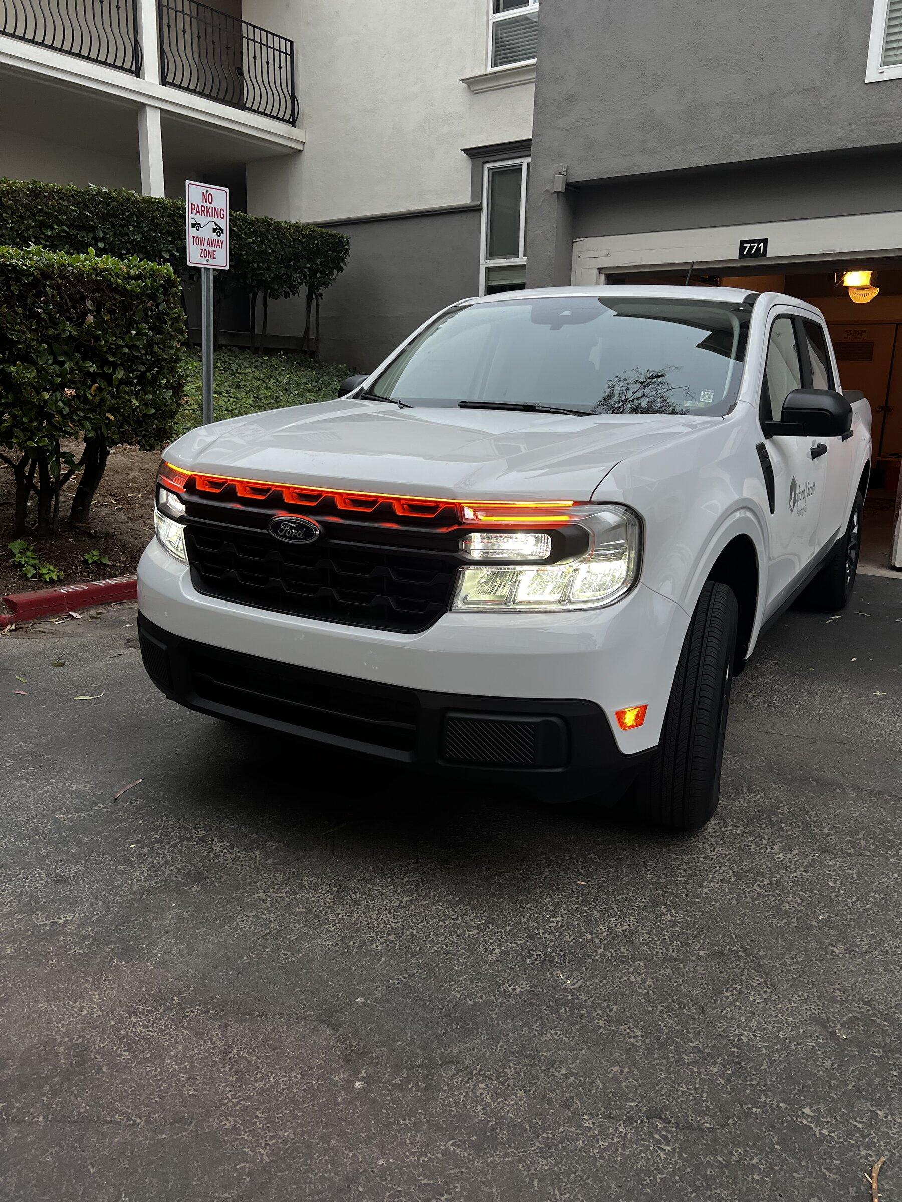

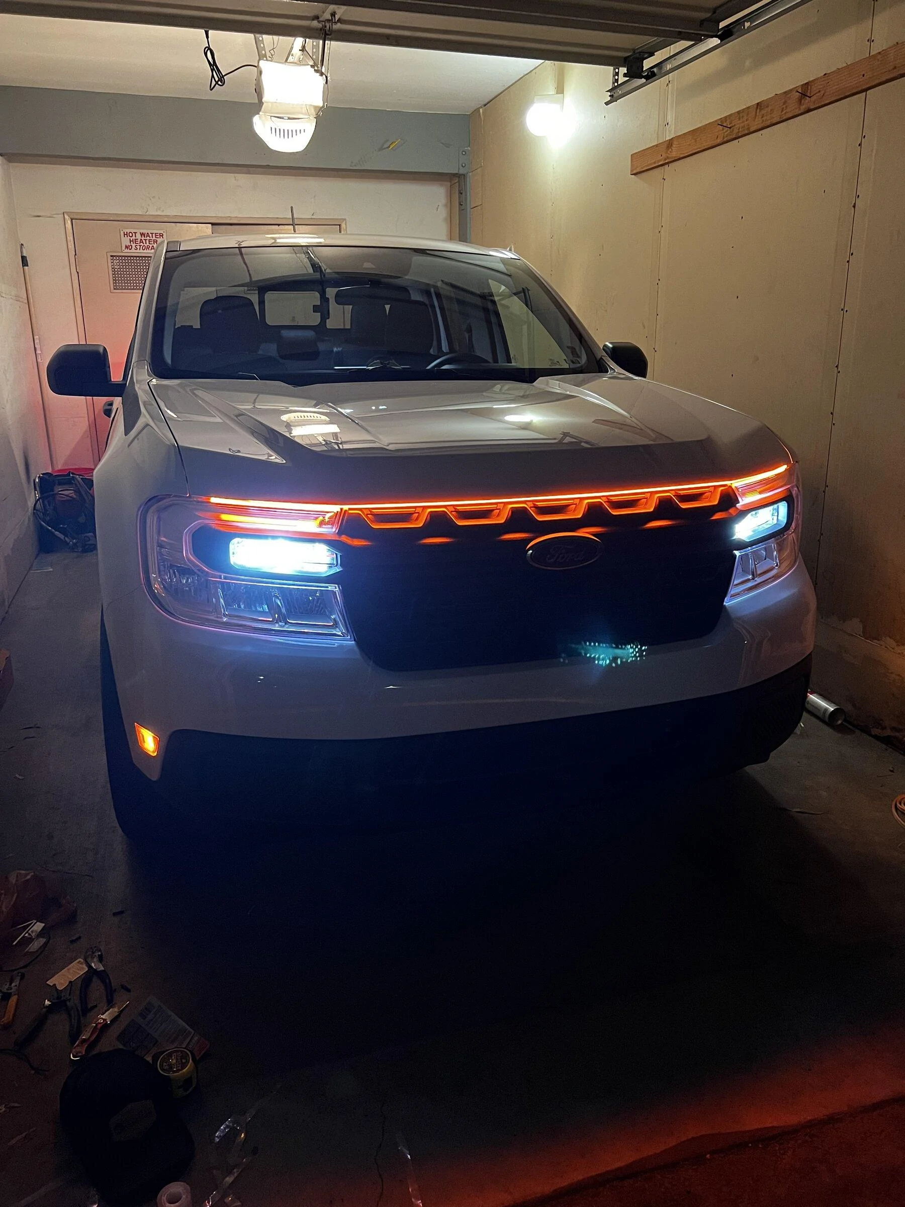

I have an XL, so no upper running lights like the lariat. I thought about drilling into the headlights, But how they are shaped, it would be hard to get bulbs in there because of how the grille is put in.
I ended up getting amber lights off of Amazon and used 10lb gorilla tape and attached it to the underside of the hood. You’ll notice that it’s about 2 inches in on either side of the hood. That is because the plastic sleeve where the wires attach to the strip doesn’t bend very well. I ran the wires down the hood and back to the passengers headlight. Pretty happy with the result. I’m planning on getting some ditch lights to match.
