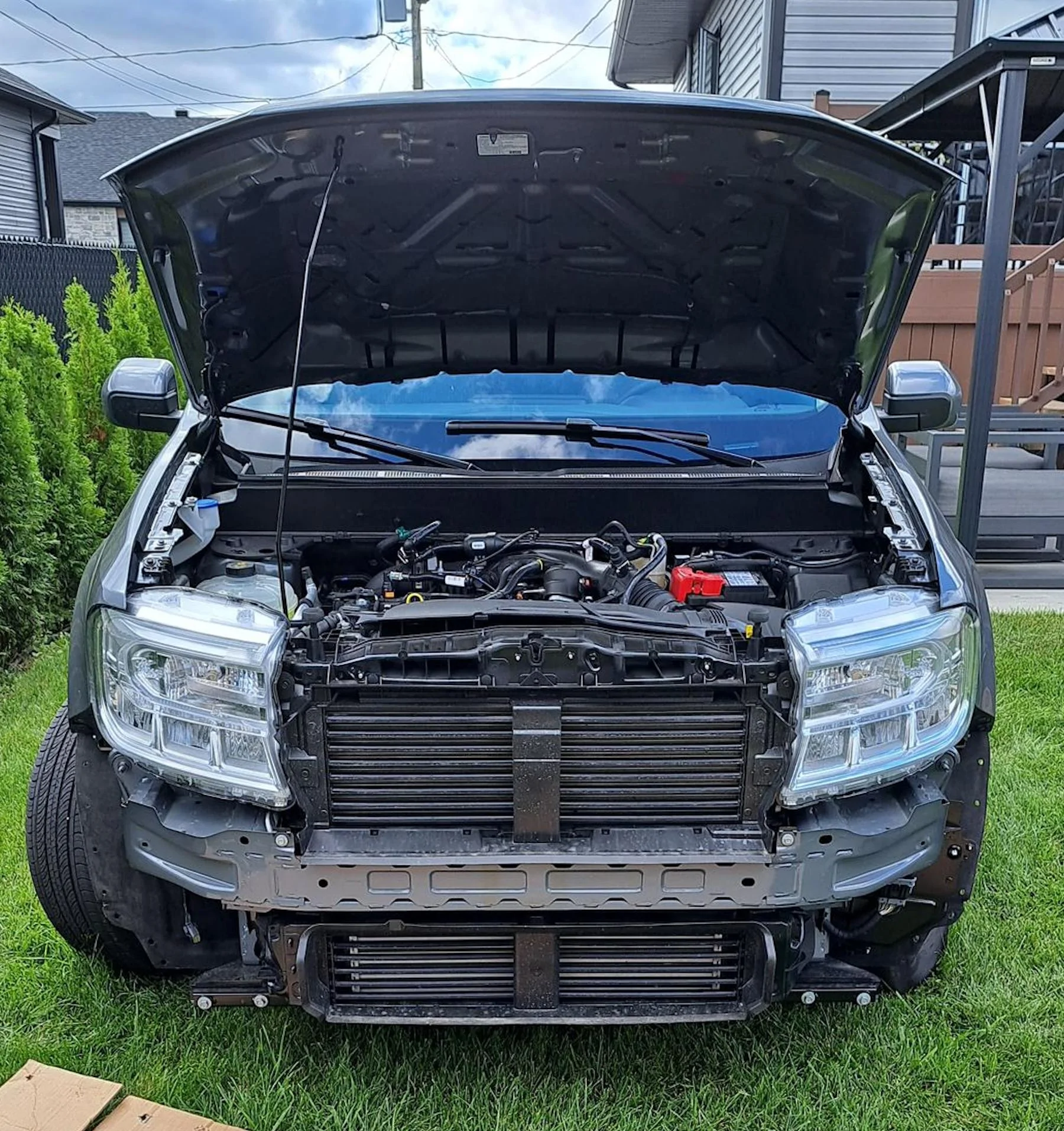

for you potential diy types
Ford Maverick Maverick front bumper too low fel
Maverickman74
Shane
Dec 8, 2021
5,597
7,803
Maui HI
The first person to move that intercooler up where that big plastic piece behind the engine is and put a giant scoop on the hood wins all the Maverick credit! Then we could really get some good approach angles. I still wish that guy who made the tucked aluminum rear bumper would have shared more details on here. If this truck can be armored and get its angles it could really be the base level of budget offroading for this era. Much like the Bronco II and the twin traction beam Rangers were simply amazing off-road.
