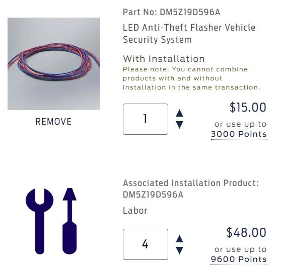

It seemed easy to order an LED Anti-Theft Flasher Vehicle Security System (DM5Z19D596A) for the Ford Perimeter Plus VSS (KN1Z19A361A), but that's not the case.
While the KN1Z19A361A fits my '23 Maverick, also fits 2022 Maverick, the DM5Z19D596A does not:
Ford Maverick Maverick fob remote start... nogo
The website doesn't even allow this item to be added to the shopping cart. On the other hand it does fit the 2022 Maverick; how does that make sense?
After adding the 2022 Maverick to my garage and adding the flasher ($15), the system also added installation to the shopping cart:
Ford Maverick Maverick fob remote start... flasher
There's no way to purchase this item from Ford without installation. Ford is happy to sell me the the Perimeter Plus VSS and let me install it by myself, but let me install the flasher by myself is not allowed. Really Ford, how does that make sense?
Does anyone know what so special about the flasher? AFAICS, the Perimeter Plus has a socket on for the flasher, where it plugs in.
I can order one from some dealers, takes 2-3 weeks to arrive, with shipping cost about the same as the flasher. I am ok with that, but started to wonder, will it actually work? Or maybe just leave out the flasher with all of these loops I'd need to jump through...

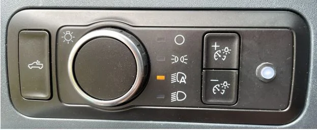

@mspmms....
I finally received the flashing light from a Ford parts distributor; came in a rather big box for that little thing and looks exactly just like yours from Ebay.
I did drill a hole for the light next to the headlight switch and increase/decrease cruising speed switches:
Ford Maverick Maverick fob remote start... lights
There's nothing behind the blank panel for about an 1.5" - 2", pretty much behind the whole square at least on mine. The light panel can be removed easily, it just pops out, disconnect the wires and drill it with a 9/32" drill. Alternatively, it can be drilled without removing the panel, but just for sanity do check the space behind it on yours. The light works just fine, it lit solid for 20 seconds and then slowly flashing until the truck is unlocked.
My alarm is still on maximum sensitivity setting, but seldom causes problems. My landscaper's gas blower around the truck did set it off once, but that was the only issue. Since then, he doesn't go close to my truck with blower and the throttle wide open.
The rest of them had been self-inflicted, like add/remove my bike rack from the receiver, let the 110V outlet cover snap close in the truck bed, etc., but these were just one beep warnings.
While my initial intent had been adding the remote start to my OEM fob, I like the the perimeter security feature as well now.
Thank you all for your help during this add-on project, much appreciated...

@mspmms....
There's nothing behind the blank panel for about an 1.5" - 2", pretty much behind the whole square at least on mine. The light panel can be removed easily, it just pops out, disconnect the wires and drill it with a 9/32" drill . . . . .

Believe it or not, I didn't know that those switches are for dimming the the instrument panel. Now I do, thx and yes, page 98 of the manual. Yet another page I didn't bother to look at....

This is what I've been looking for. Thanks! I'm gonna try and center mine with the top switch so that if I ever install a fog light kit, I'll have room for that switch beneath it.
