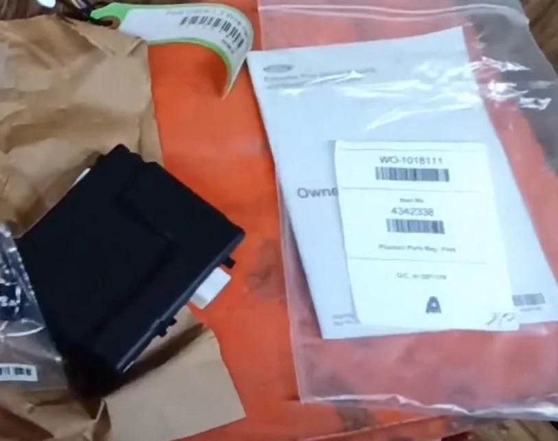

Finally, I've got around to install it. I didn't really follow the direction, the high level instruction via internet search and by cneth (thx) was good enough for me. I did remove the OBD port and that wasn't that easy. The nut closer to the fender doesn't have much room at all, one sixth turn with the open end 8mm wrench.
The procedure was pretty simple:
  1. install the box, including securing it behind the panel
  2. sit in the truck and close the door
  3. push start for accessory mode and wait until it loads up
  4. push lock/unlock on the door panel
  5. shut off accessory mode
  6. exit and lock the door
  7. start the engine with the key fob and test the security system
Starting the engine with the key fob worked from the house, about 30-40 feet, more than enough for my needs. Activated the alarm by banging gently on the steering wheel and lifting any of the handles.
The security system can be activated by the key fob, just a single press on the "lock" activates it after about 20 seconds. The keyless entry on the door handle also activates/deactivates the security system, no need to lock/unlock by the key fob.

It seemed easy to order an LED Anti-Theft Flasher Vehicle Security System (DM5Z19D596A) for the Ford Perimeter Plus VSS (KN1Z19A361A), but that's not the case.
While the KN1Z19A361A fits my '23 Maverick, also fits 2022 Maverick, the DM5Z19D596A does not:
Ford Maverick Maverick fob remote start... nogo
The website doesn't even allow this item to be added to the shopping cart. On the other hand it does fit the 2022 Maverick; how does that make sense?
After adding the 2022 Maverick to my garage and adding the flasher ($15), the system also added installation to the shopping cart:
Ford Maverick Maverick fob remote start... flasher
There's no way to purchase this item from Ford without installation. Ford is happy to sell me the the Perimeter Plus VSS and let me install it by myself, but let me install the flasher by myself is not allowed. Really Ford, how does that make sense?
Does anyone know what so special about the flasher? AFAICS, the Perimeter Plus has a socket on for the flasher, where it plugs in.
I can order one from some dealers, takes 2-3 weeks to arrive, with shipping cost about the same as the flasher. I am ok with that, but started to wonder, will it actually work? Or maybe just leave out the flasher with all of these loops I'd need to jump through...
